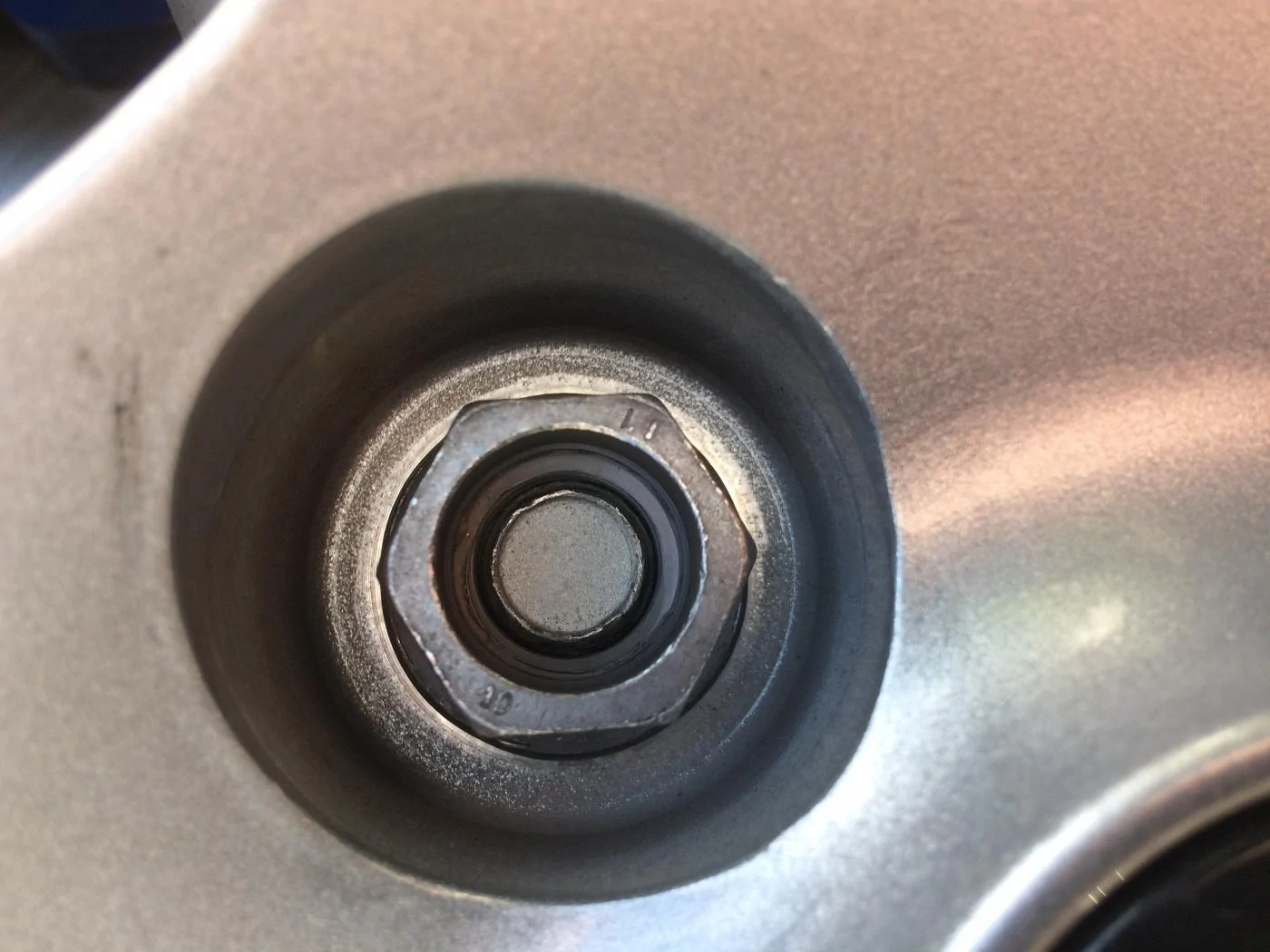

I'm running the PP 19x9.5" up front, with a 5mm spacer. I also use FRPP open lugs, and there's definitely some threads not engaging, maybe 1 or 2. Are people running long studs with this setup?

If you've followed the numerous posts on this topic it is stated you will lose a couple threads , but still have enough to be safe . As for me for the street i would be comfortable , but if i tracked my car it would be a different story. For track I like longer studs and no spacers , but thats just me. Street use your good to go.

Thanks for the advise Maddawg. I do track my car. I didn't want the spacer either, but I need it for clearance to the strut.
At this point I could get longer studs, run the OE wheels up front, or just deal. Crap, I should have researched this better before buying my wheels!

With a 5 mm hubcentric spacer there's nothing to worry about, even when tracking it. It still gets you about 10-11 threads which is plenty enough to be secure.

That's what I'm using - 5mm hubcentric. I was just a little worried about that last thread!

just wanted to throw this out there. I have a 2016 GT PP, and I put a set rear OEM 19x9.5 PP wheels with Michelin Pilot Sport 4s on the front with the 5 mm spacer. The inner 3/8" lip of the tire would kiss the strut with any cornering. The contact was enough to smell rubber. I measured the spacers, and the tires were mounted properly. I do not know if this is an issue with the tires or my suspension. I bought the car used so it is possible the previous owner screwed with the suspension; however everything looks stock. The wheels do look like there may be a little bit of negative camber which could explain the rubbing. As far as 5mm spacers go, you do catch just a little bit more than a diameter of thread.
