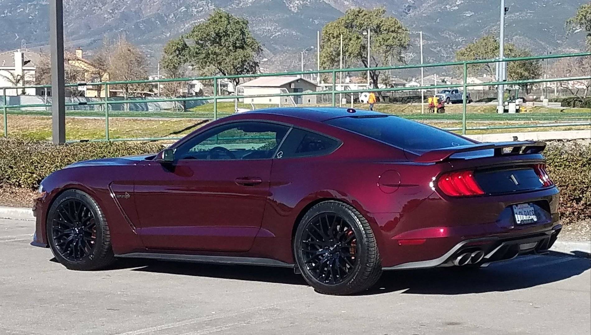

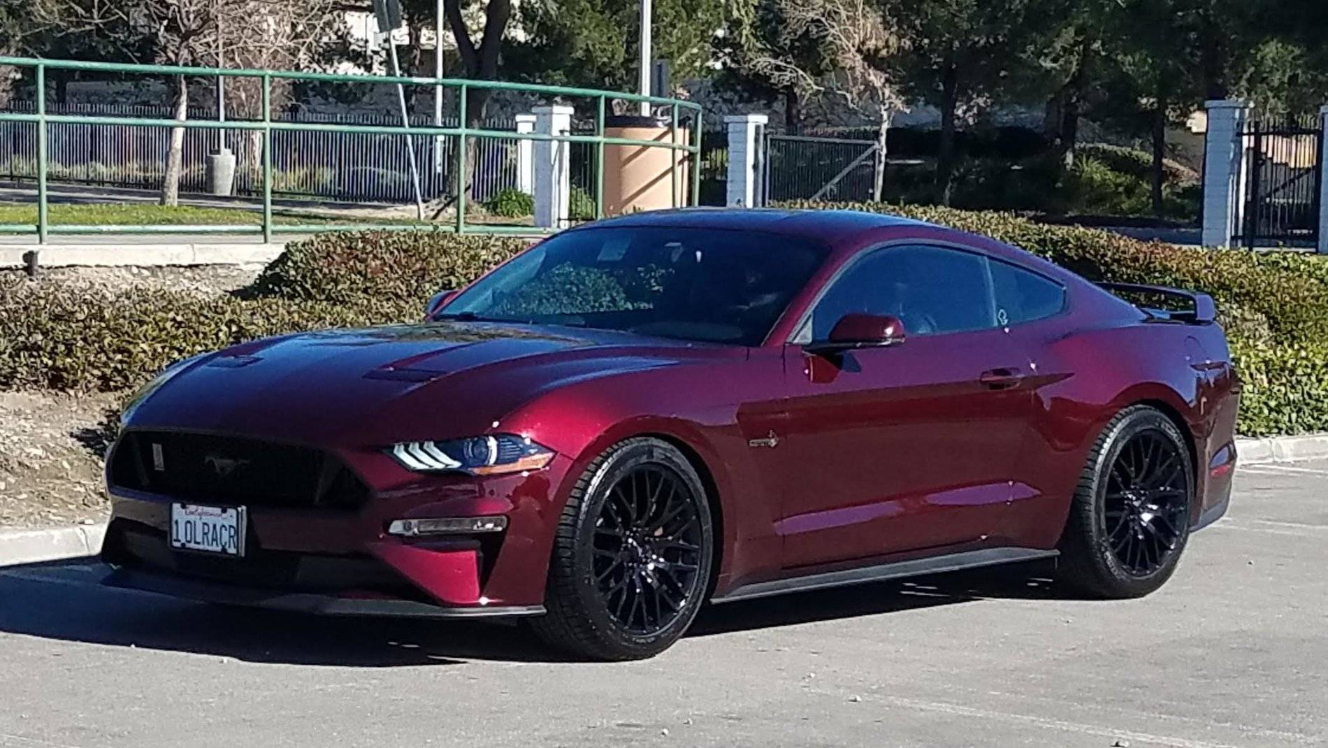

1 old racer
Feb 20, 2018
89
1,730
2,378
Fontana CA
Will
2018 Royal Crimson GT PP1 prem., and others
I went square 275/40 PP1's with 25mm spacers all around and with a 1.0" drop the front and .75" rear. The tires would rub going into driveways. So I went 23mm and it made it a perfect fit. I have sense wetnt full aftermarket with 285/305 setup. But if I ever go back to the pp1 set up I would go with the 23mm spacers with 285/35 tires. The 285's are almost the same dia as the 255/40's
