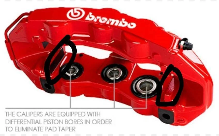

Didn't use Z26 per se but the shim you're talking about should be from the OEM pads and shouldn't be reused. If memory serves well, Z26's come with either a metal or a rubber shim, use that.
PS: Make sure to clean the hardware (pins, bracket, etc) before reinstalling and also clean that groove inside the caliper (see attached photo)
