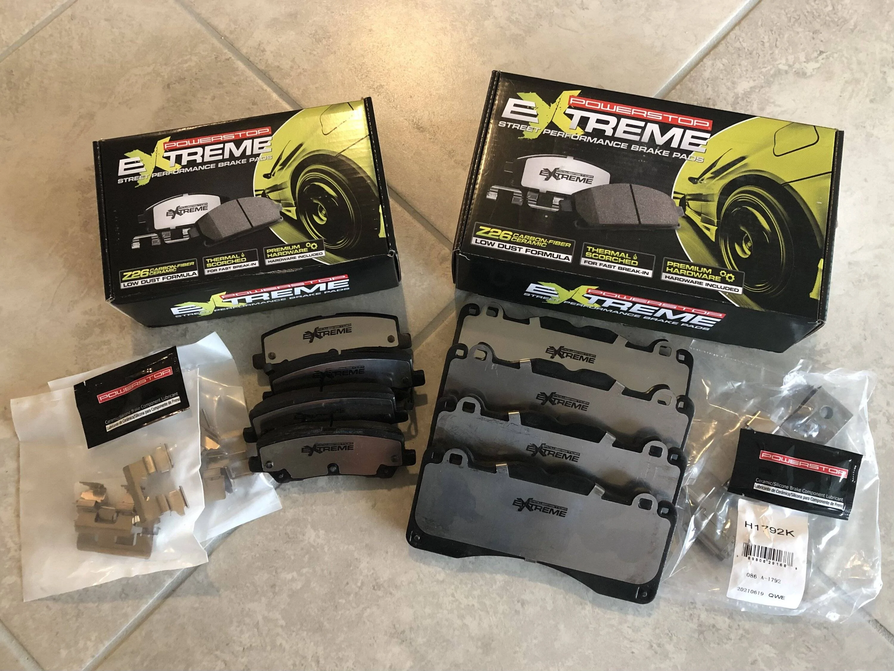

Changed the pads 2 days ago to the Z26 pads. I noticed today that I get a scrubbing noise, it's pulsating and not constant.
Any ideas? I don't see how I could have screwed anything up, it's basically 3 pins and the cross spring. I made sure to orient the pads with the tabs in the proper orientation, lubed the backing and the edges of the pads.

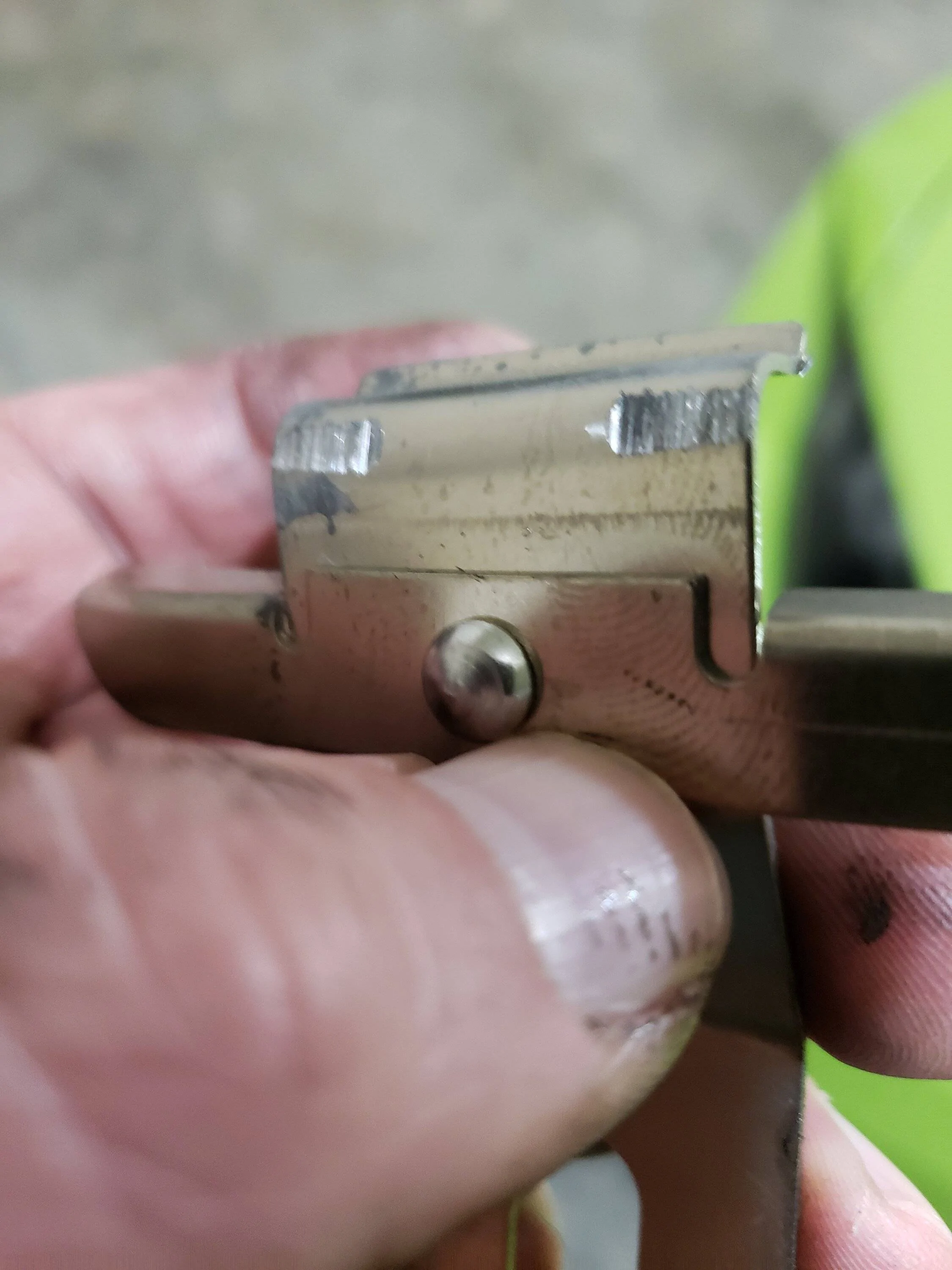

So my hunch was right. Either these things are slightly out of spec or my rotors have just a slight bit of runout. Both of them were showing rub marks but the passenger side was very very slight and you couldn't hear it. My OCD wasn't gonna let one side be new and the other old lol...
Pic of the driver's side which was the worse one.
