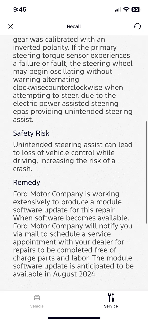

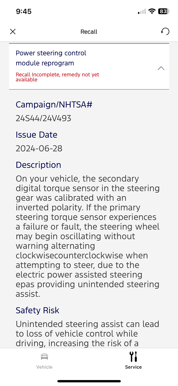

Has anyone else seen this recall come up? Surprised I haven’t noticed any threads on this yet, but it did seem to just come out. I didn’t get any notice or anything, just went on the app and saw it there.

Maybe the recall will be issued when Ford has a software update to correct the problem. From what you posted, they're hoping to have that next month.

I read an article about it. I haven't received a notice yet but the article stated they were planning on rolling out the fixes by August 5th. I was curious if this affected the Mach 1s as well but I see no reason why it wouldn't.
