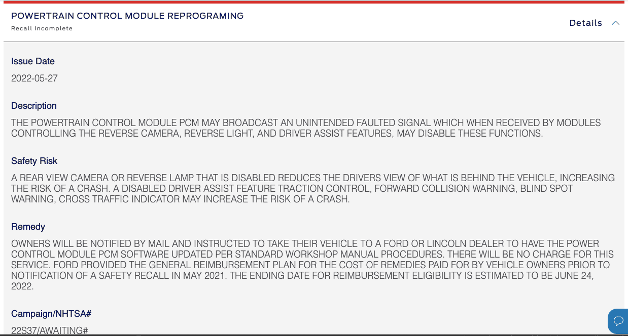

I found this same recall via the Ford Pass app so it is legit....
Search via VIN or log into your Ford account here - https://www.ford.com/support/recalls
Yep, I just looked on there and my car is due for the recall. 2020 with an October 2019 build date.
My first recall! Woohoo. So far I've dodged them all.
