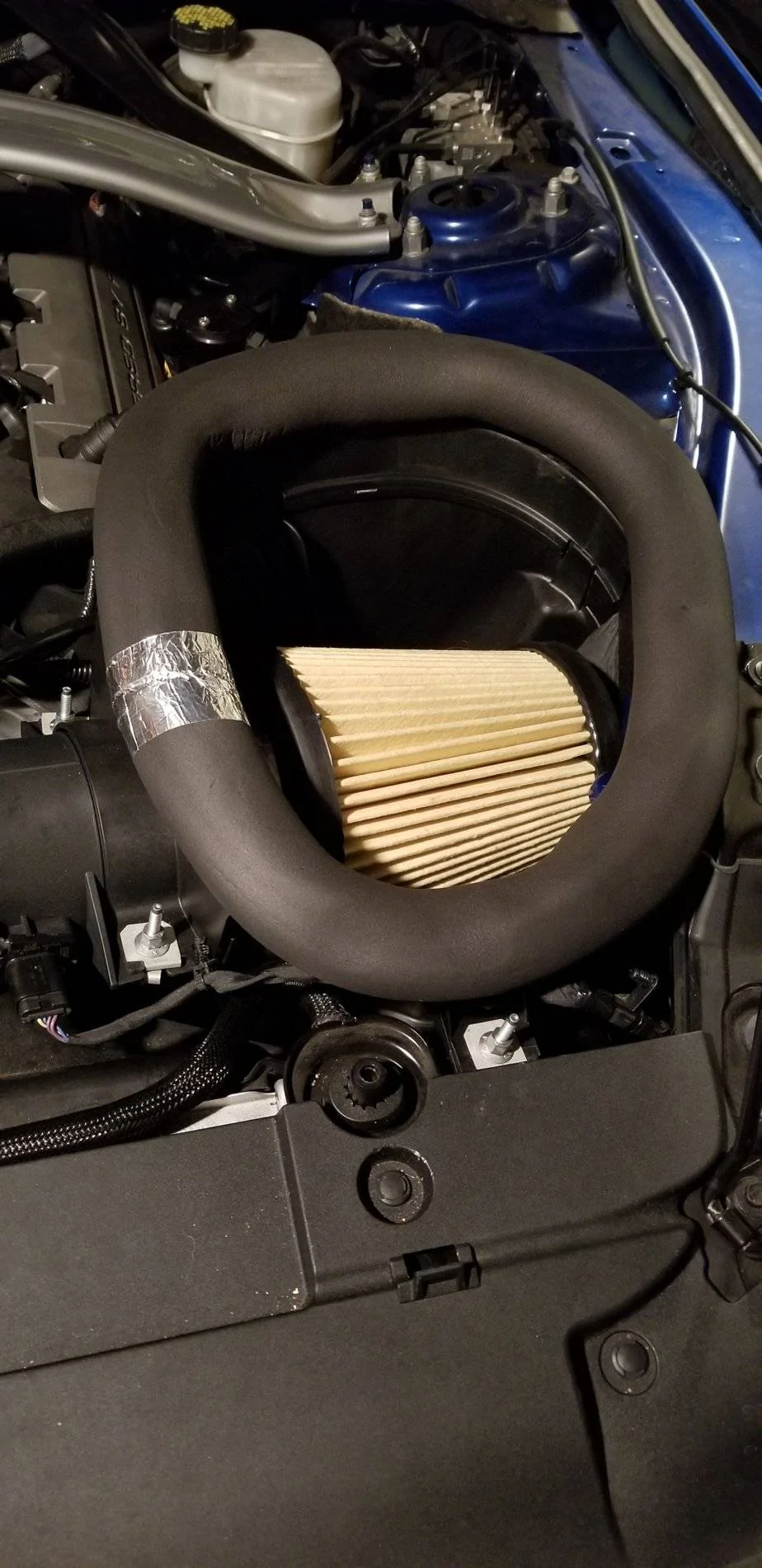

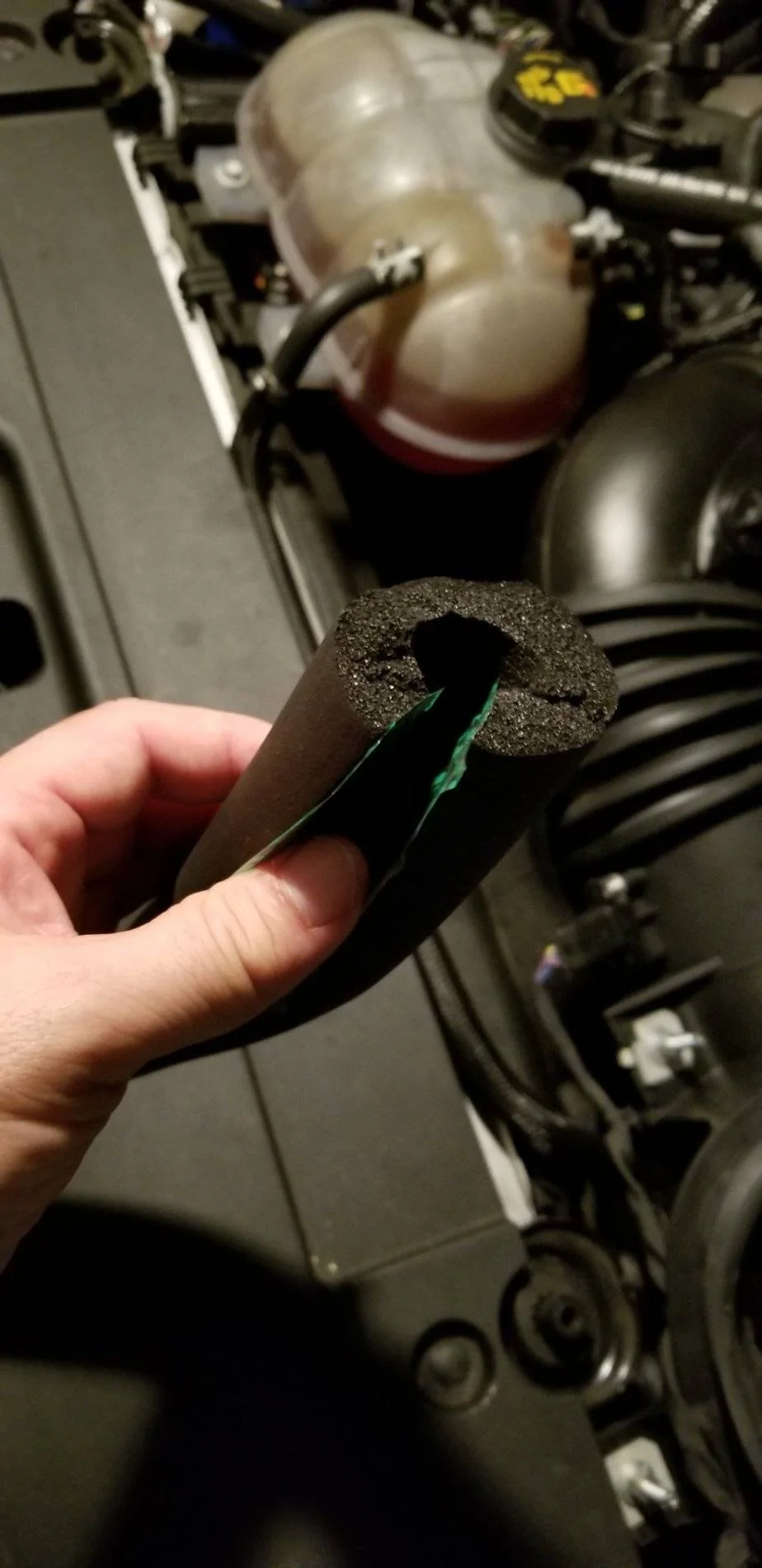

So I bought this puffy pipe thermal isolation hose from home depot and
it takes literally seconds to cut it to appropriate length and put on top/around
of the intake rubber thus extending its height increase and beter isolation.
This improved things somehow, but not much. Next day I opened the hood and
saw hood's imprint on the hose. It was telling me that there's still very
little contact with hood. Noise was also at the same level.

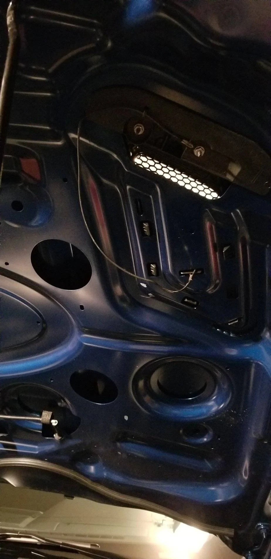

I removed hood liner previously and luckily still had it in garage. Bare GT hood
will not give you any good cover as you see at pictures.

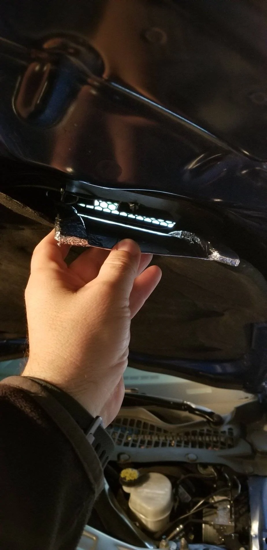

So I solved unpleasant sound and extra heat, but needed a solution for water.
I basically inserted a self-made tray in between hood liner and head extractor.
It blocks air from being sucked from heat extractor into air intake. When water
gets into heat extractor it gets into tray and diverts outside air intake. I think I
will replace the tray with some sticky heat insulator.
This last solution lets heat extractor work as heat extractor, also diverts water
from air intake.

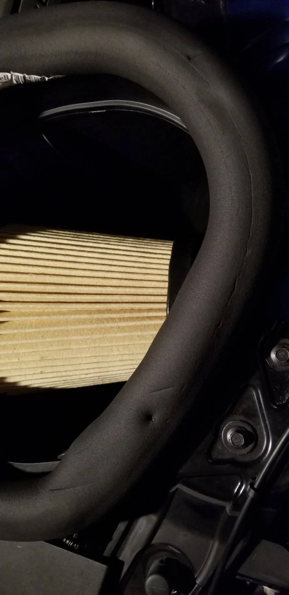

Without hood liner only sharp hood element leave imprint on the rubber

Hood surface without the liner is not good for pp2/3
Hood liner installed back. Here you can see a tray that I installed between hood lined and the hood. It blocks regular air path into the filter and instead diverts it towards front of the hood.
Hose from home depot.
View from top - previously I'd see air intake internals here, but now it is air/water diverting plate
Imprint hood without a liner leaver on rubber. Bottom right you can see two sharp edged of heat extractor and one of its screws.

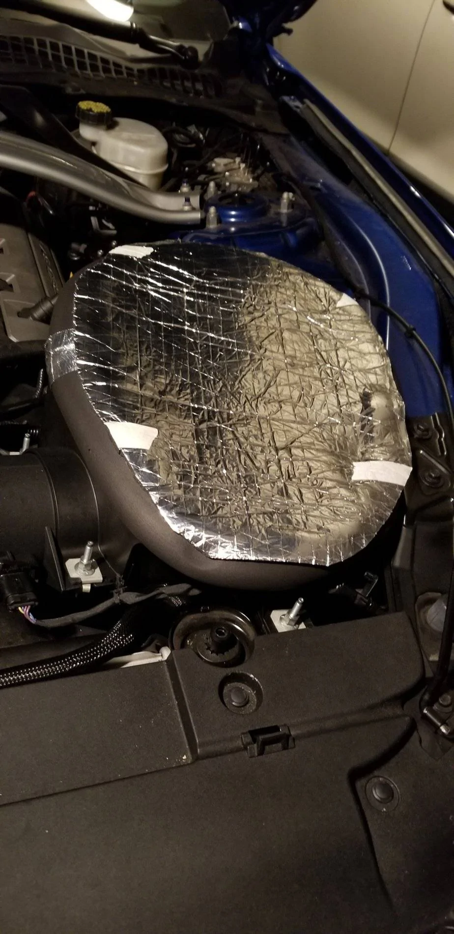

I also bought $11 sheet of heat/sound insulator that I attached to the top. Will post a picture.
This way I have a closed system that works almost like it would under shelby hood.

Below is the picture of "the lid"

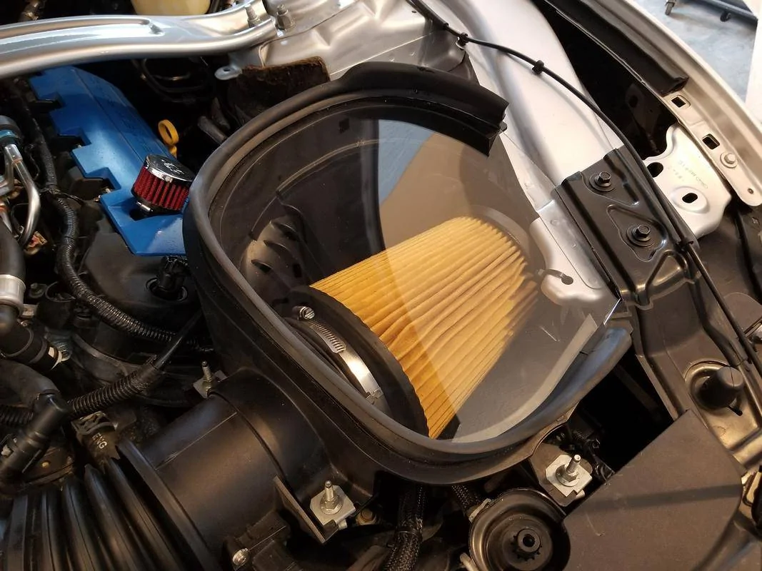

A clear piece of Lexan, a 2'x2' piece of cardboard, a Sharpie marker, and a cheap hand-held jig saw along with 20 minutes of your time could have solved your issue.
you removed kit's piece that is in between intake and fender.
Have you seen lexan solutions from very long power pack threads?
p.s. my solution is not for looks - i pull it out if I go to a smog check and have the kit in its original shape or snap it back on top for dd driving.
tbh - I had something like your solution in mind. but then didn't find lexan in hd, did not know how to properly "close" it in the area of insert next to the fender, and then I stumbled upon the hose.
But here's what can be done:
a) put the insert back
b) cut lexan so that covers internal area of the intake. This will leave a lot to be desired around the insert, but
c) that area can be covered with a span of hose with length of the insert?
issue to resolve:
water from heat extractor will collect there like in the lake. Some drainage needs to be added.
