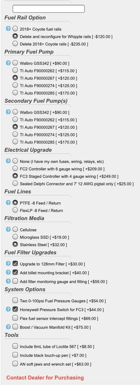

Tell me more about your fuel system please.
Looking at Fore Innovations website, there are lots of options for any given system they offer.
Thank you !

CORNYOTE
Apr 15, 2019
523
890
Oklahoma
Alex
2019 GT
Thank you !
here’s the options I went with.
