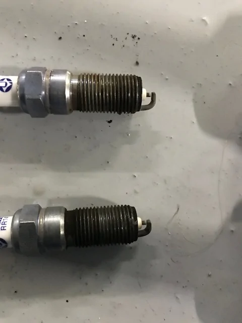

All was going well until about a month ago when I got a P0300 misfire code after a clutch install. Figured it was the crank relearn so did that and it went away but every now and then the code came back. Couldn't figure out what was causing it so sent logs to Lund and he suggested spark plugs could be on the way out. Around the same time I noted I had a boost leak as my usual 10-11psi was down to about 6psi. Checked and tightened all piping but didn't make any difference. Been a little more rough recently and down on power. Had Brisk plugs so decided to swap in NGKs this time. Pulled the plugs just now and found some oil on the threads although the actual core looks ok.

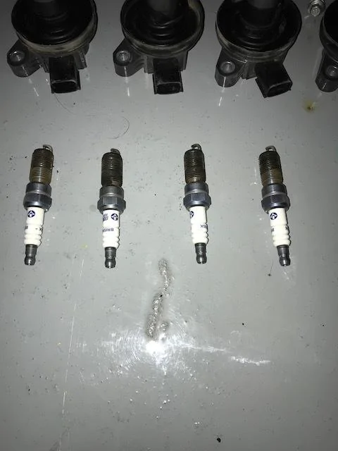

All 4 plugs from the driver's side bank:
Plug 1 (furthest from driver) and 2:

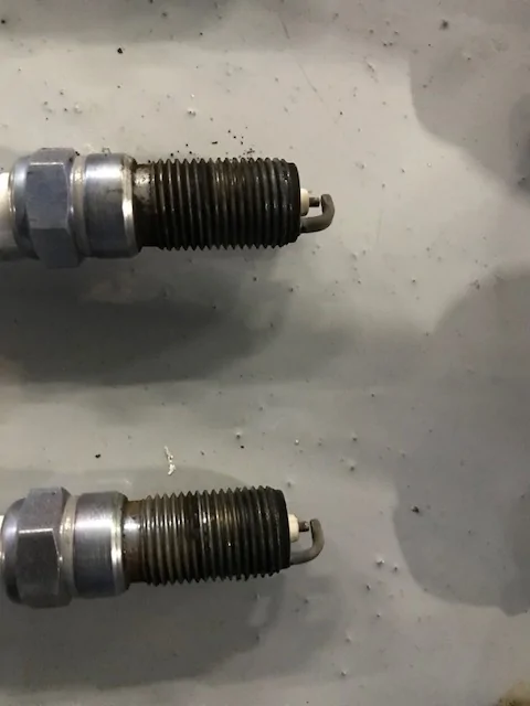

Plug 3 and 4 (closest to driver):
First question is, has anyone seen anything like this or knows what may be causing it? My first thought would be a gasket leaking oil and causing the boost leak. Any ideas?

Hey man what are those plugs tapped too,a few off them look really tight.I would use aa feeler gauge not one of those circle wedge gap tools.

That's a very good question. Now you mention it, they do look tight! I used feeler gauges for a .030 as per Lund's instruction before i installed them. Will have to check them out.

Couple of things I see:
2 of those plugs are not burning the complete fuel mixture. Gap looks way too tight.
Oil looks clear in pic. Is it clear? Do the plugs smell like burnt oil or gas?

Yeah some of those gaps look really tight. I can't tell if they're black from fuel or black from oil. As Bybotie said, you should be able to smell them and tell if it's oil or fuel.

Thanks for the help guys. Glad you noticed that. So turns out I used an old set of feeler gauges from the UK and didn't realise that it was in mm and not inches so basically gapped the plugs to .030mm!!! No wonder it was misfiring, down on power and not burning the complete fuel mixture as Bybotie said.
Checked the oil cap and couldn't feel any air blowing out. Every plug was consistently blackened on the threads so I don't think it's the rings otherwise they wouldn't all be the same I guess. Re-gapped and the car's running great. Any idea if running too small of a gap could do any damage? Everything i've researched looks positive that i'll be fine but wondered if anyone had any experience doing something stupid like me. :doh:
