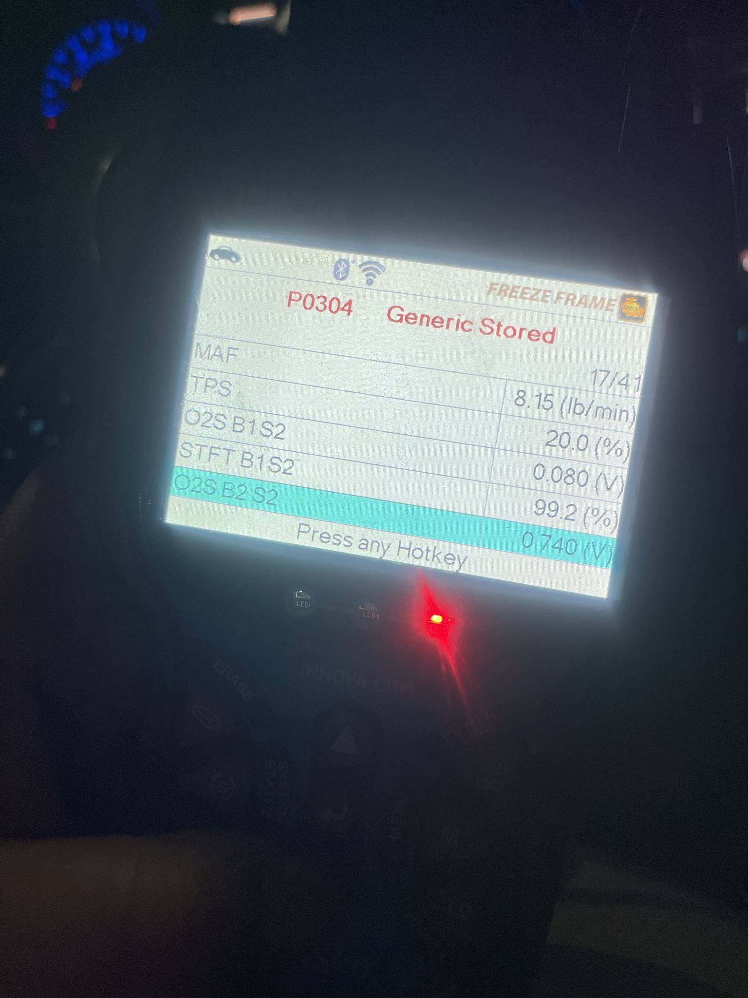

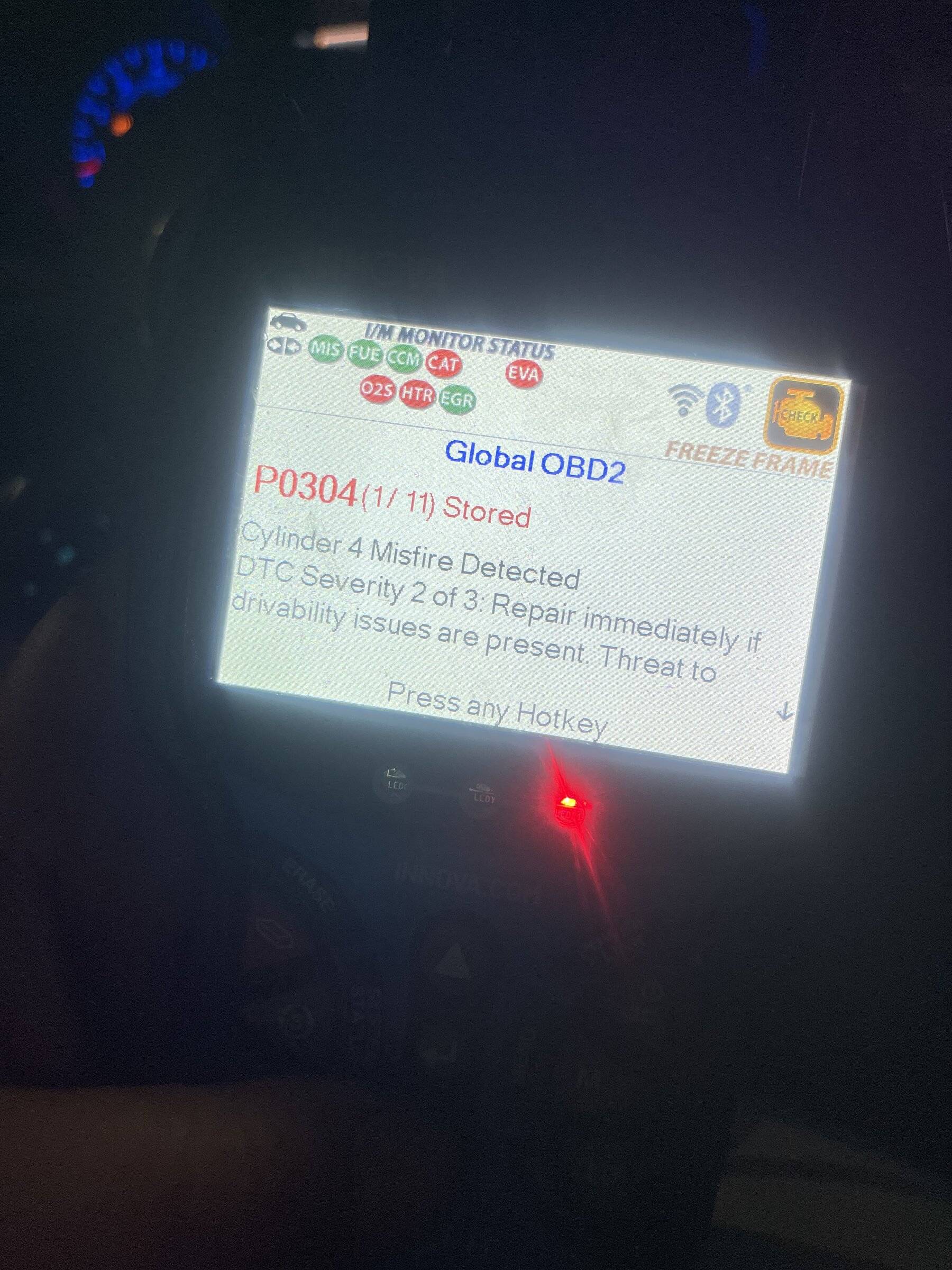

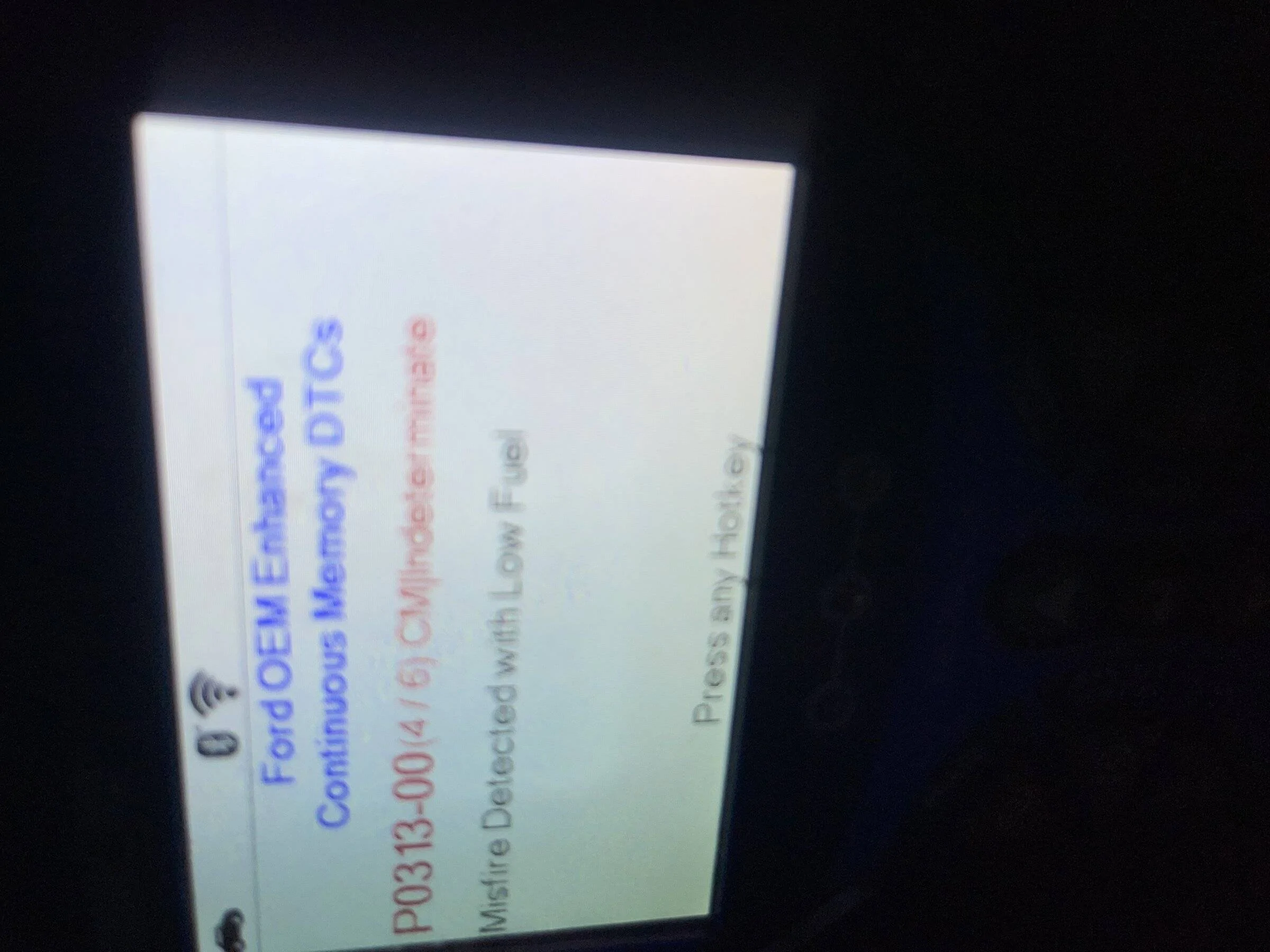

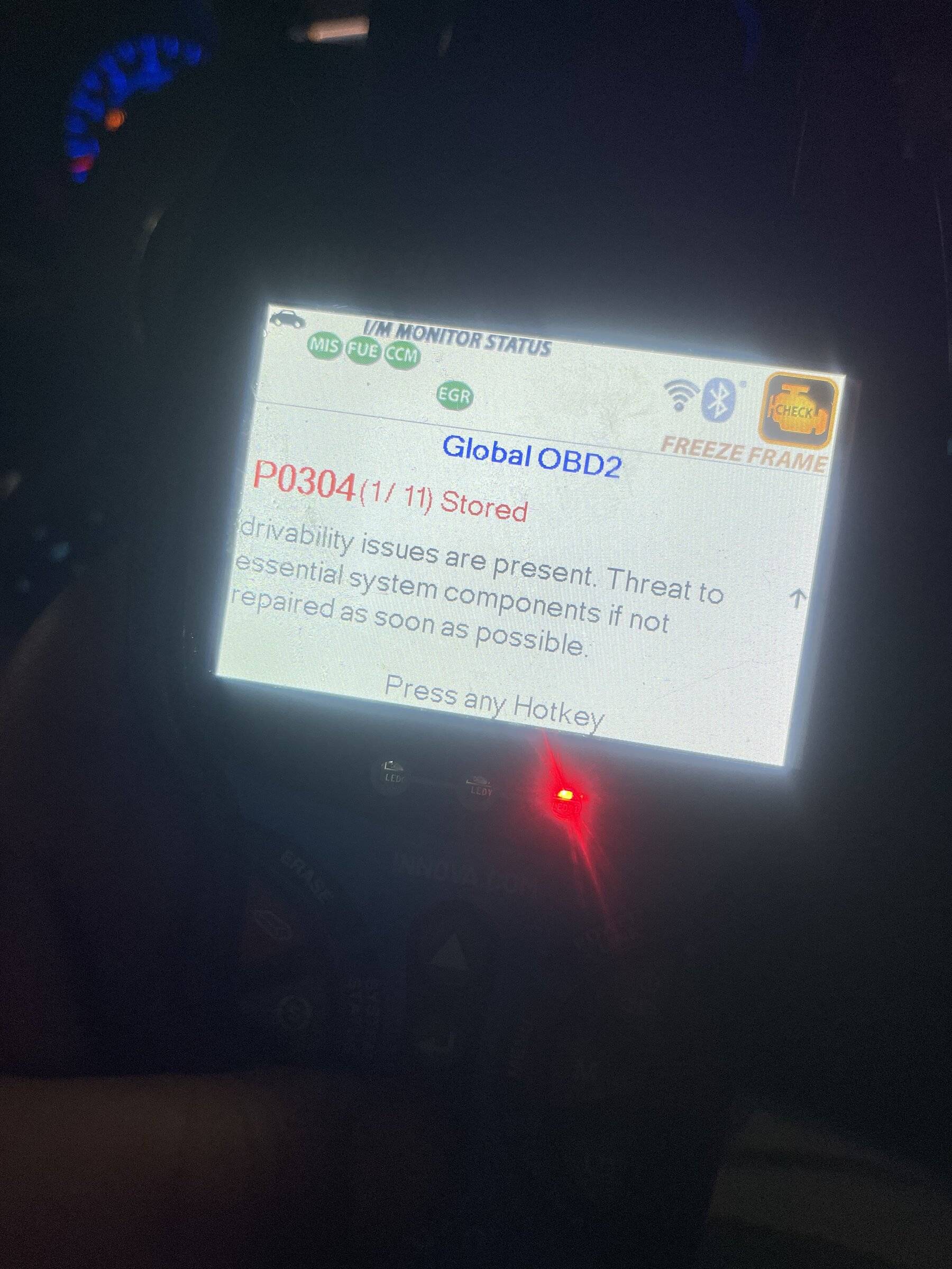

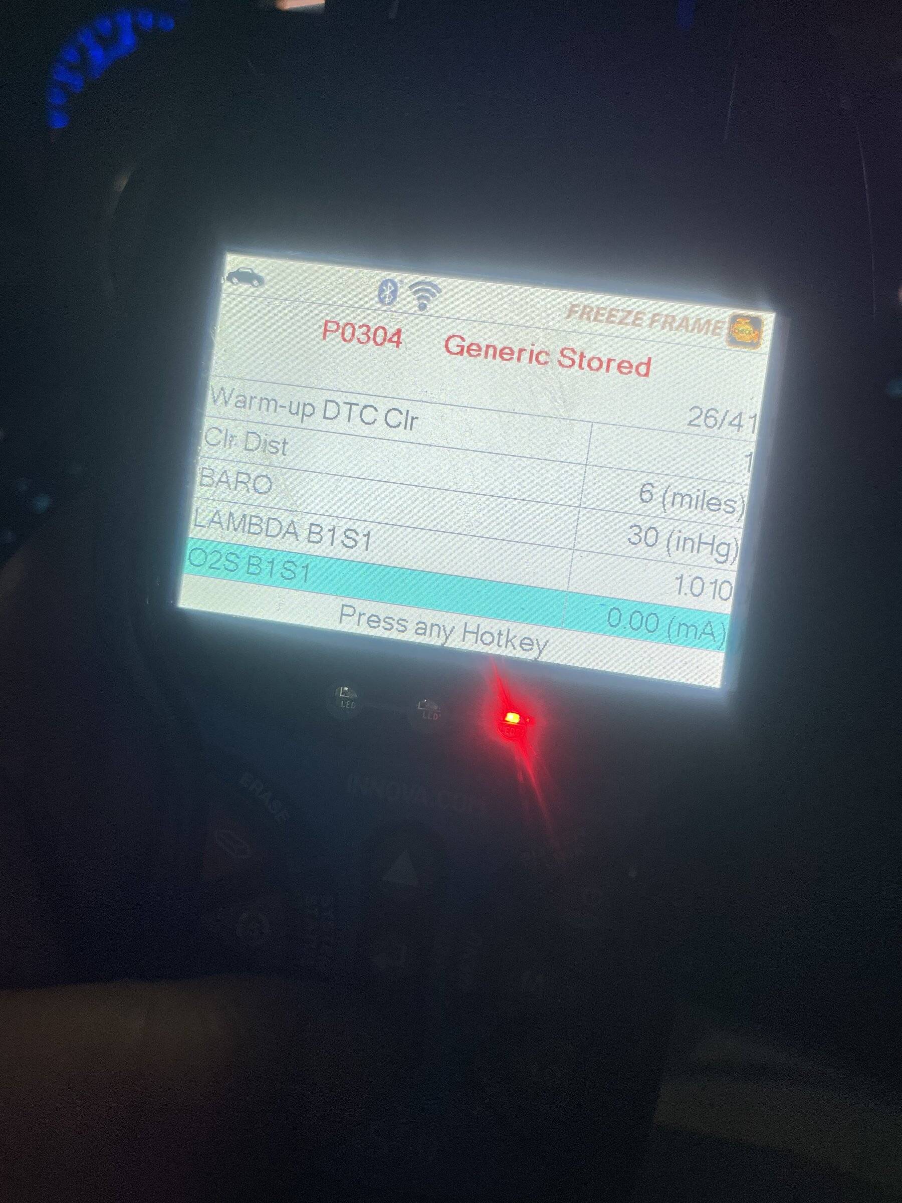

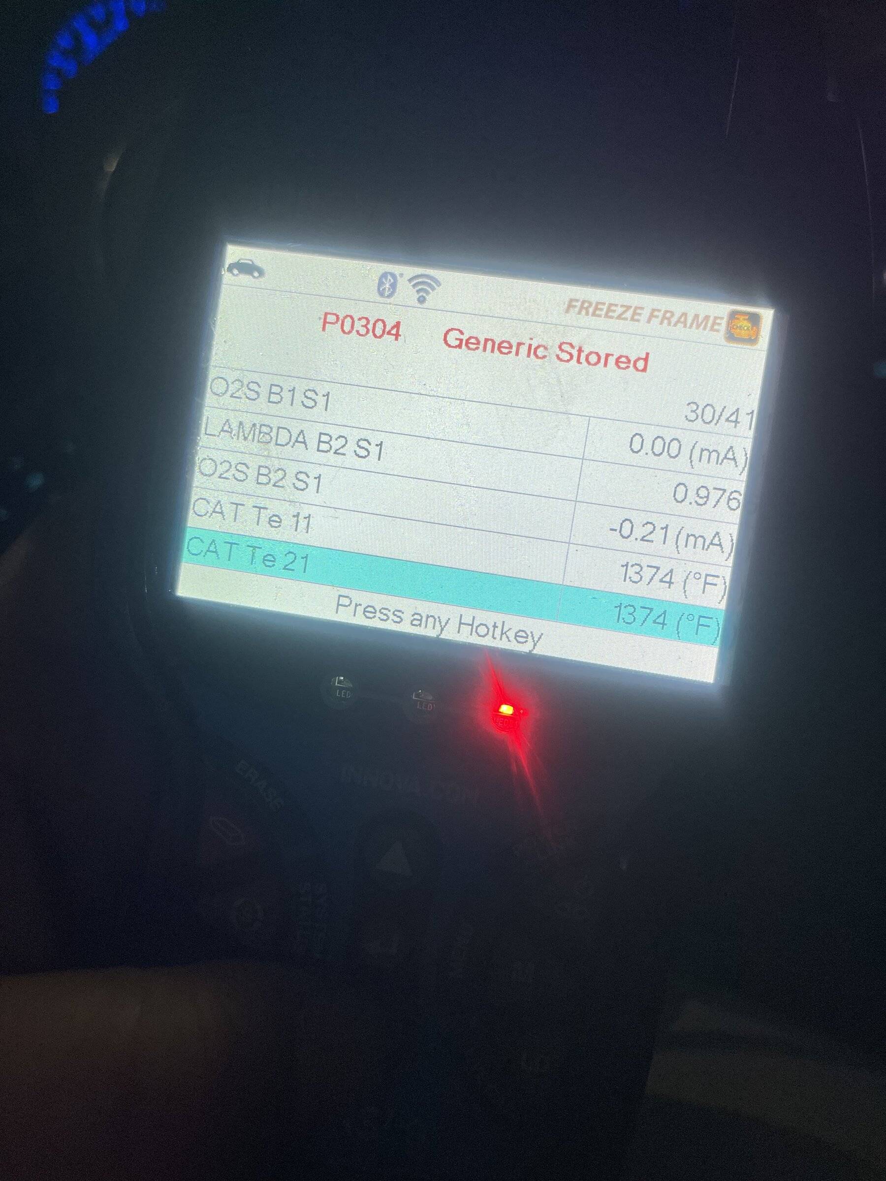

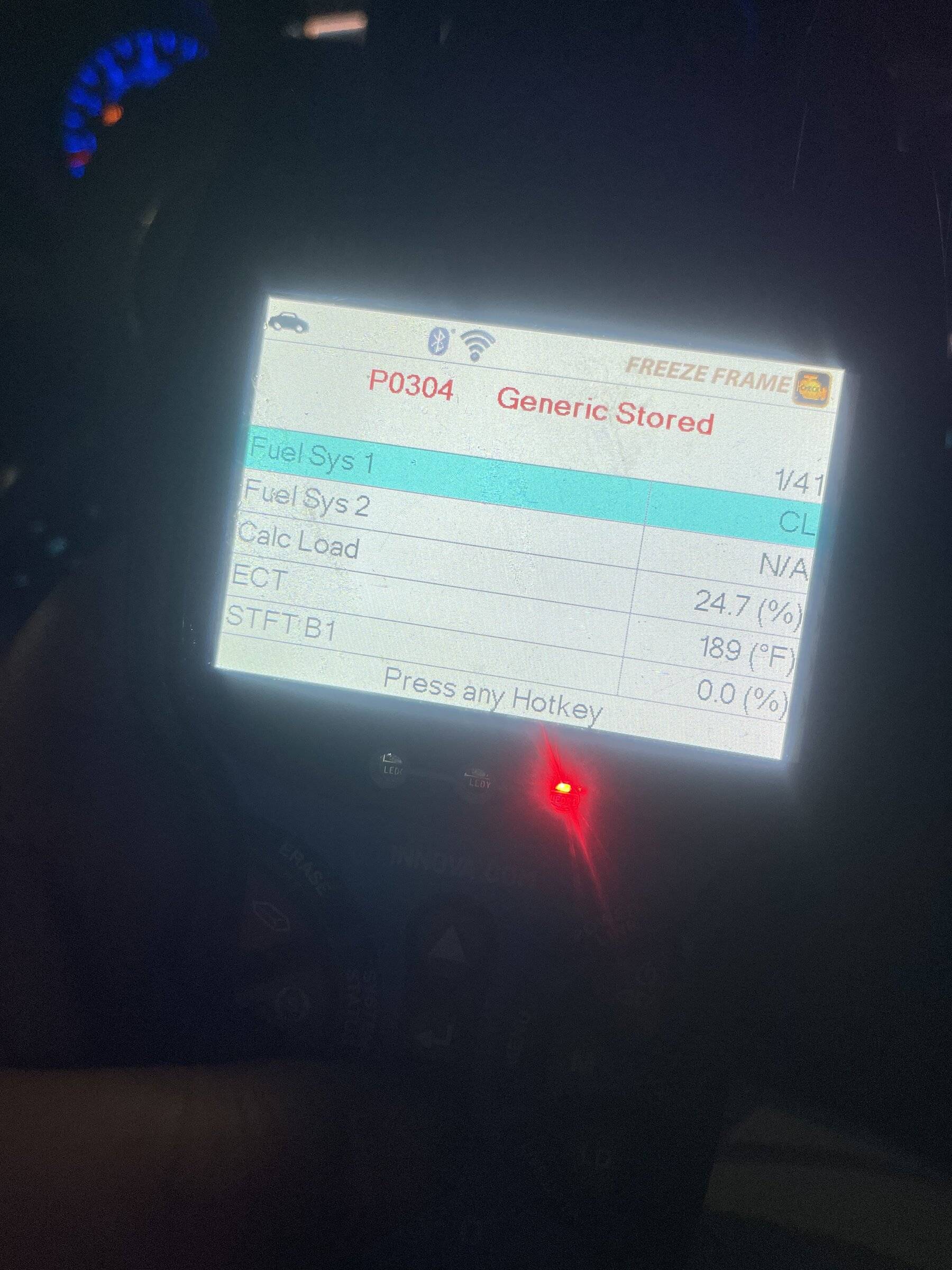

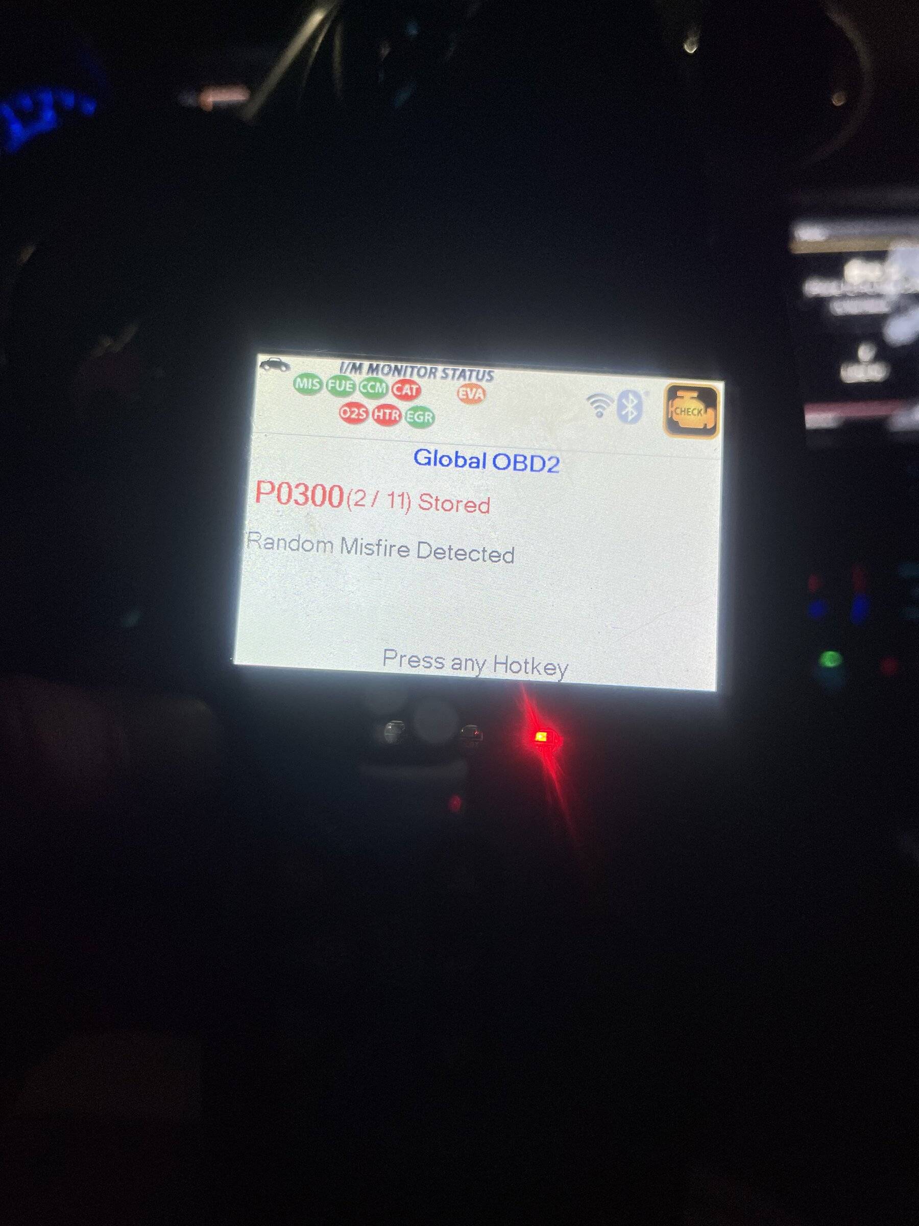

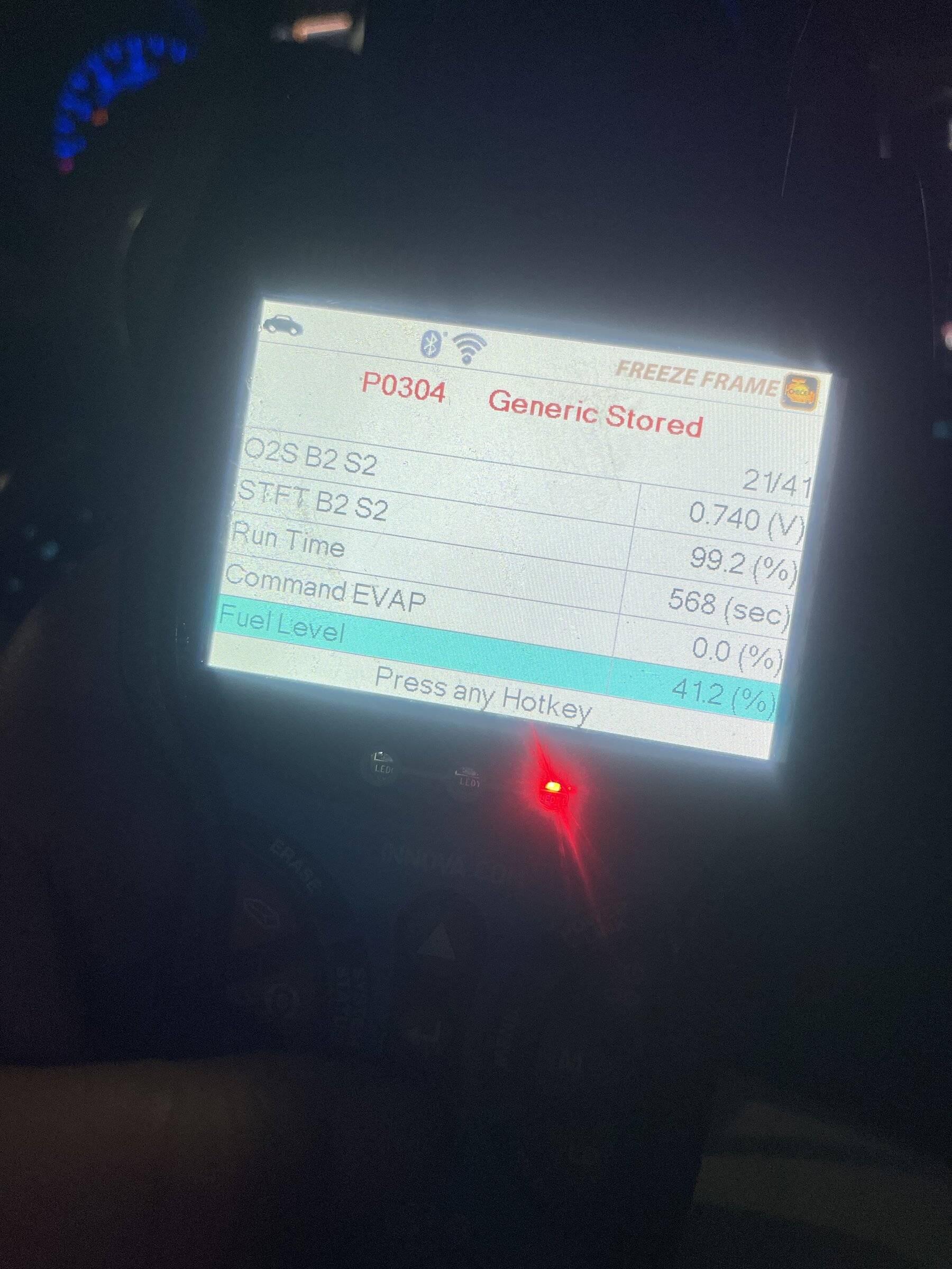

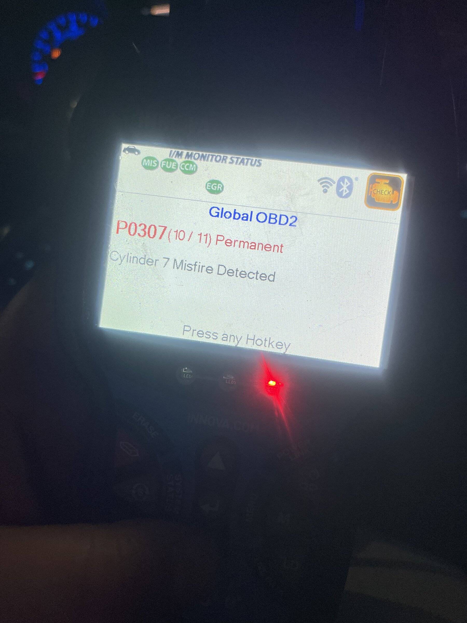

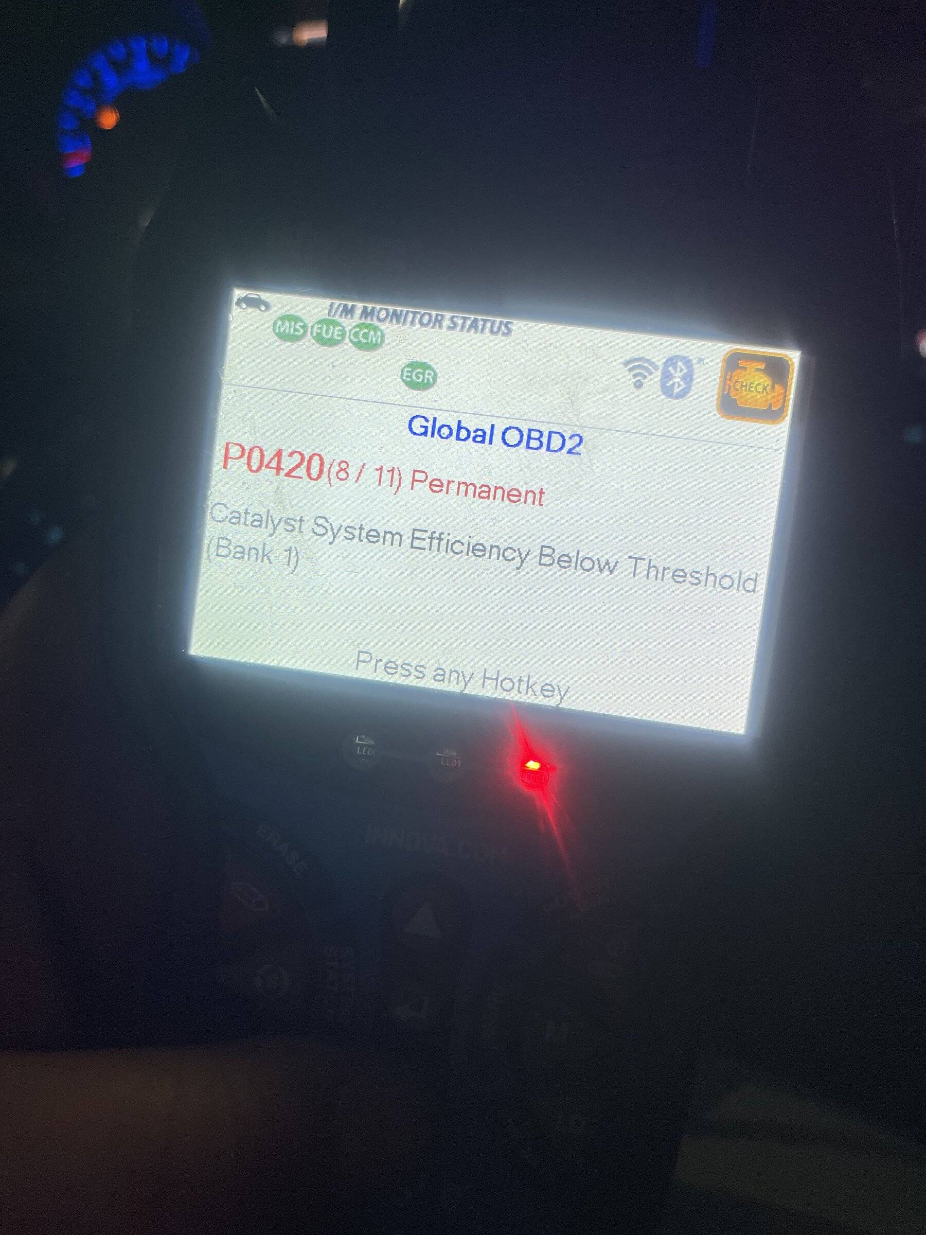

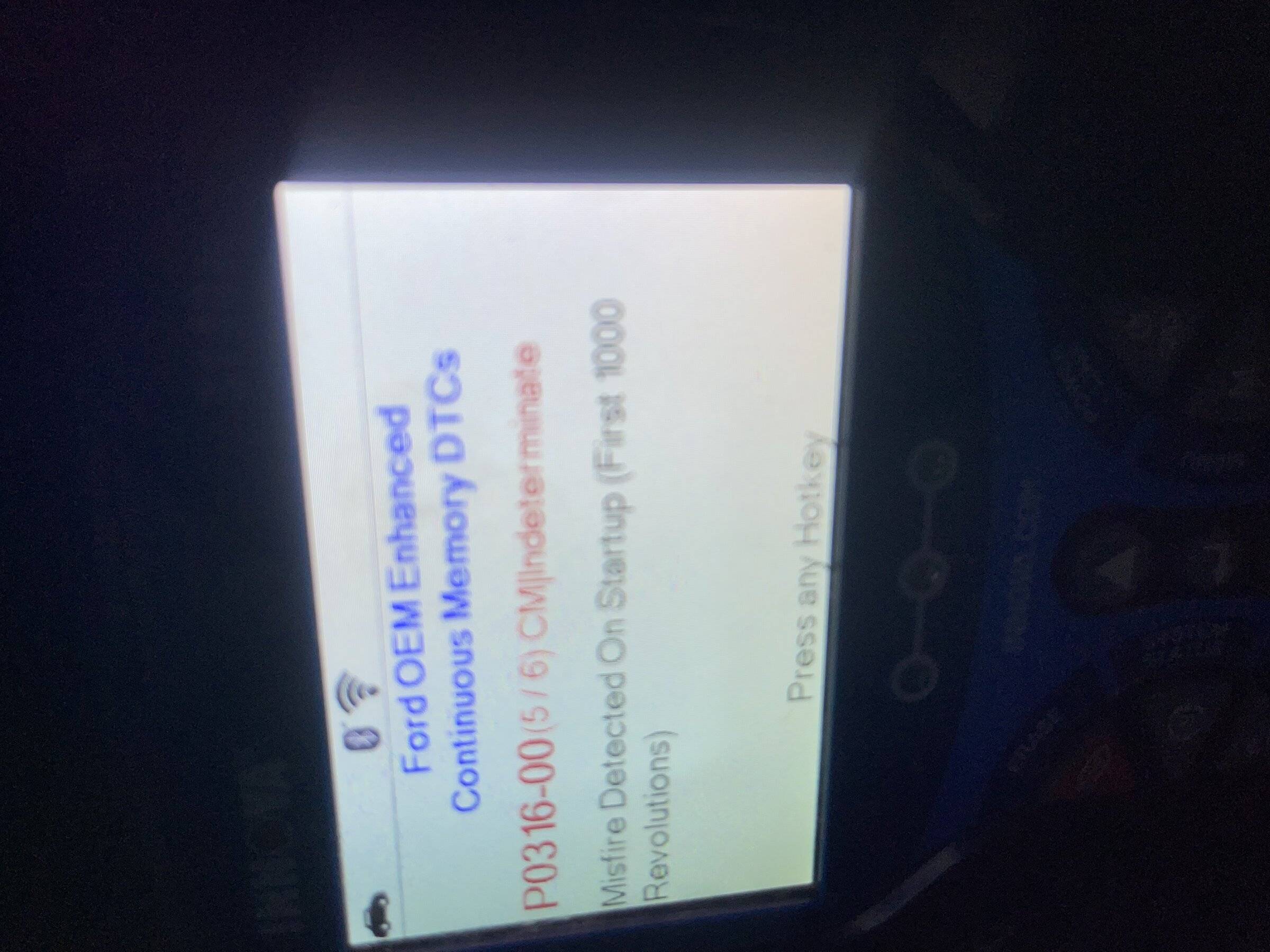

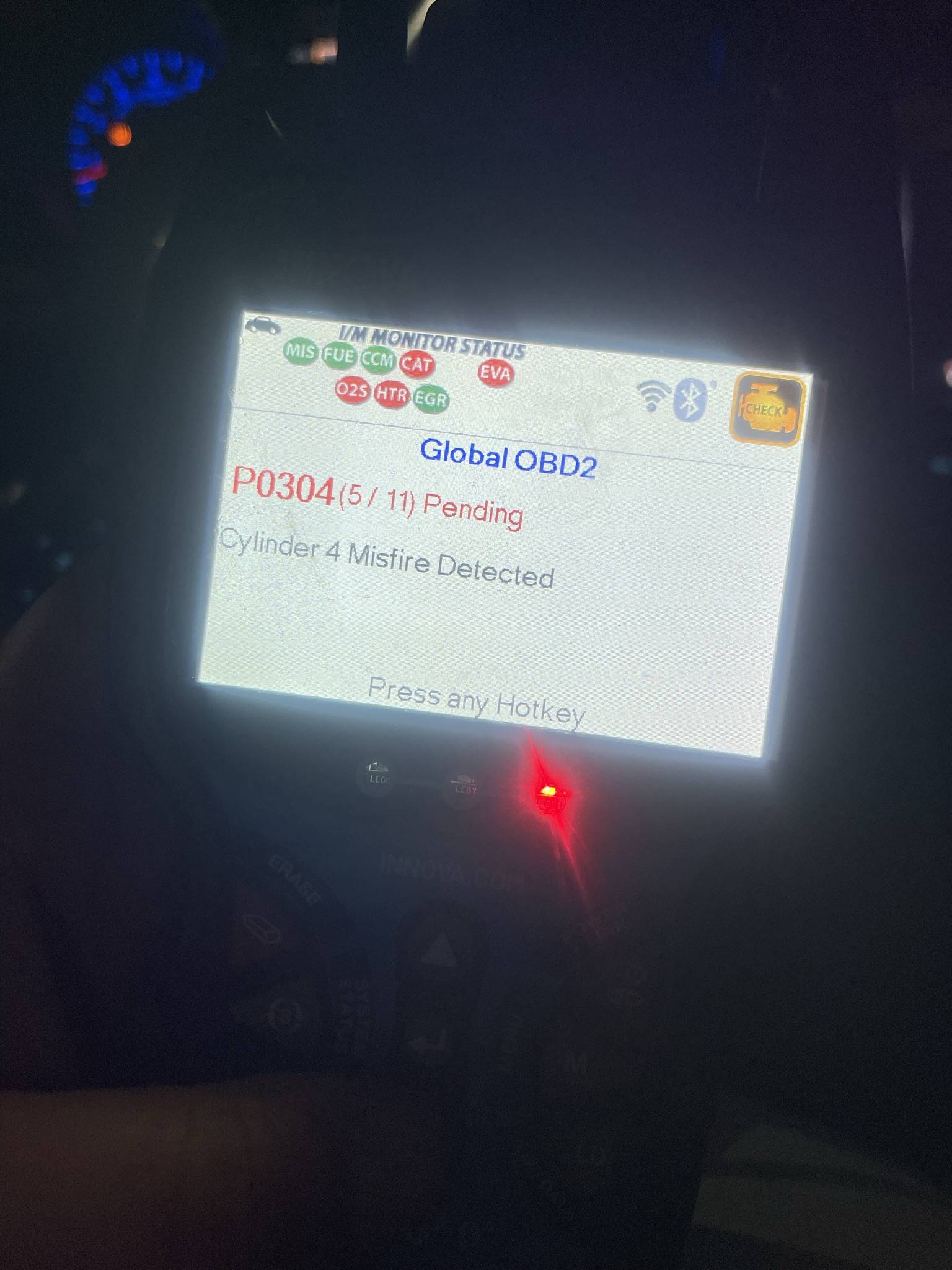

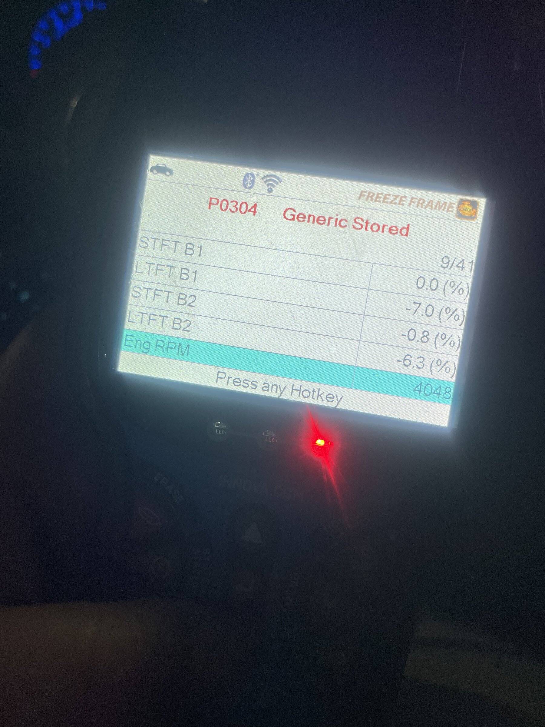

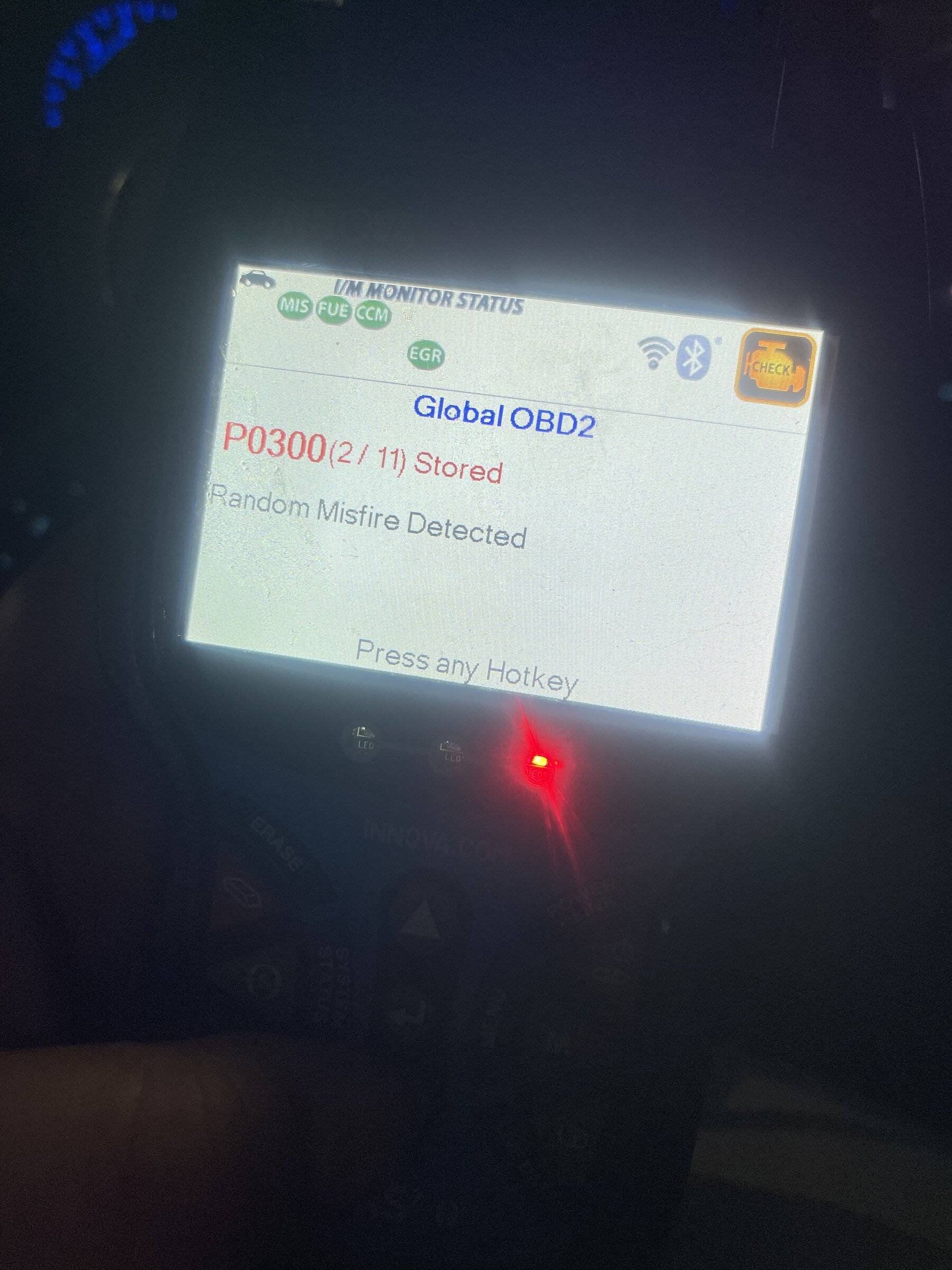

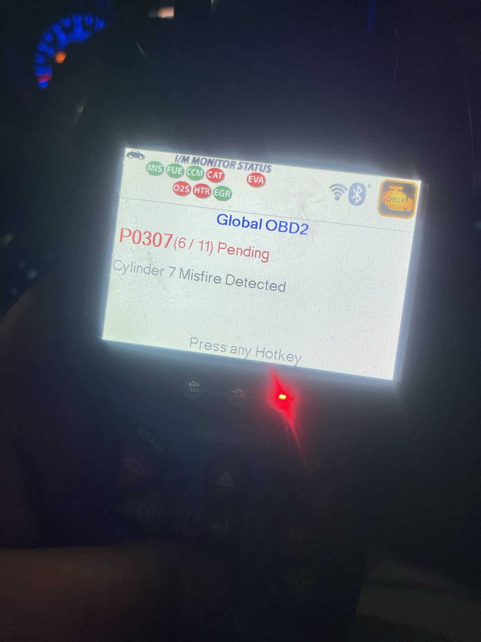

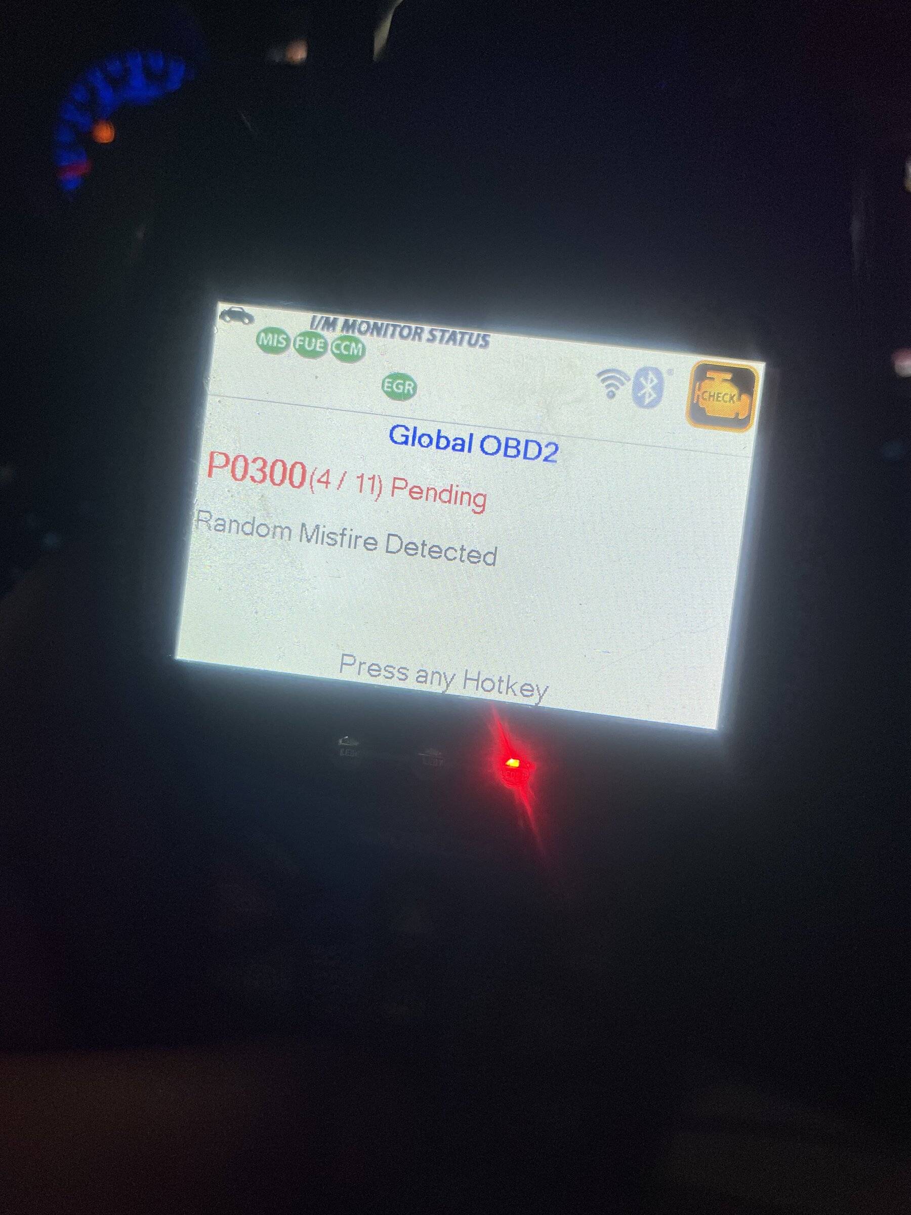

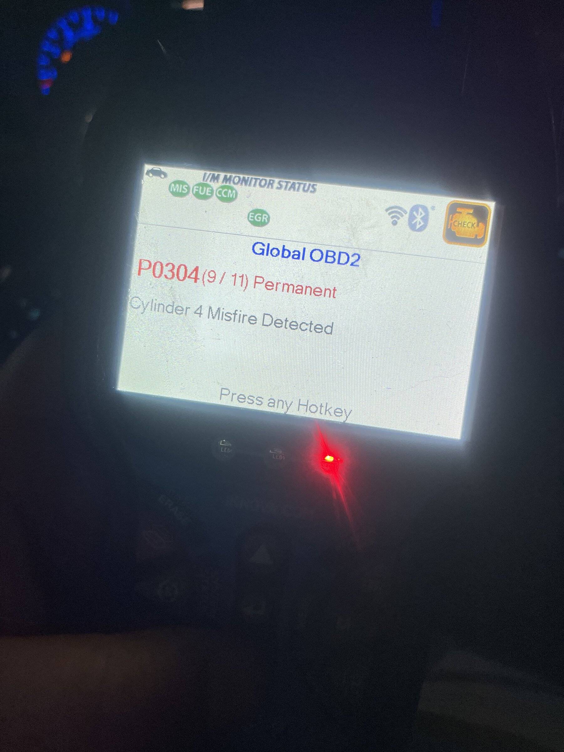

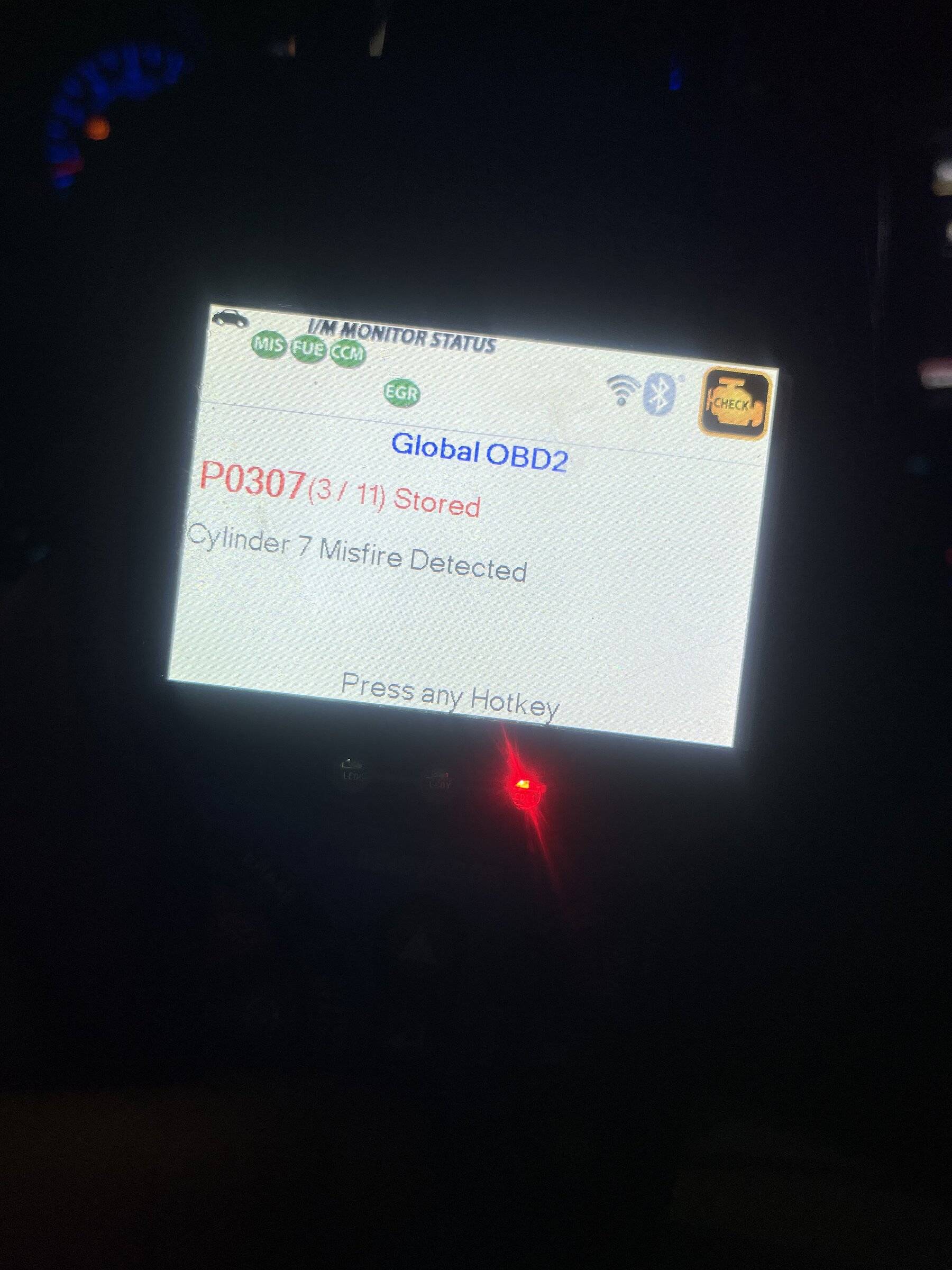

Ok, so I have a roushcharger stage 2 with catch can, oil pump gears, timing chain tensioners, harmonic balancer… the car is pushing 85k miles on the odometer.
i blew out my clutch the other day while racing someone,
ever since I replaced the clutch the car has had multiple misfire codes, p0300 p0304 p0307 p0315 (I believe that was the last code)
also for a brief period immediately after I had a fuel tank unable to create vacuum but that went away.
i already took to dealerahip to do crank relearn, no change.
i replsced Spark plugs, moved coils around… still same exact cylinder 4 and 7 misfire.
can anybody help me out with this one.
also it had the p0420 code but I have changed the cat and that code is now gone.

What do you mean by blew out the clutch?
Hard to say what the problem is without more information. If you change plugs moved coils and injectors and the problem stays on 4 and 7 it’s bad signs and you need a compression test and then probably a leak down test

Compression test came out good and so did leak down…. My pressure plate failed… so I had to have it replaced.
