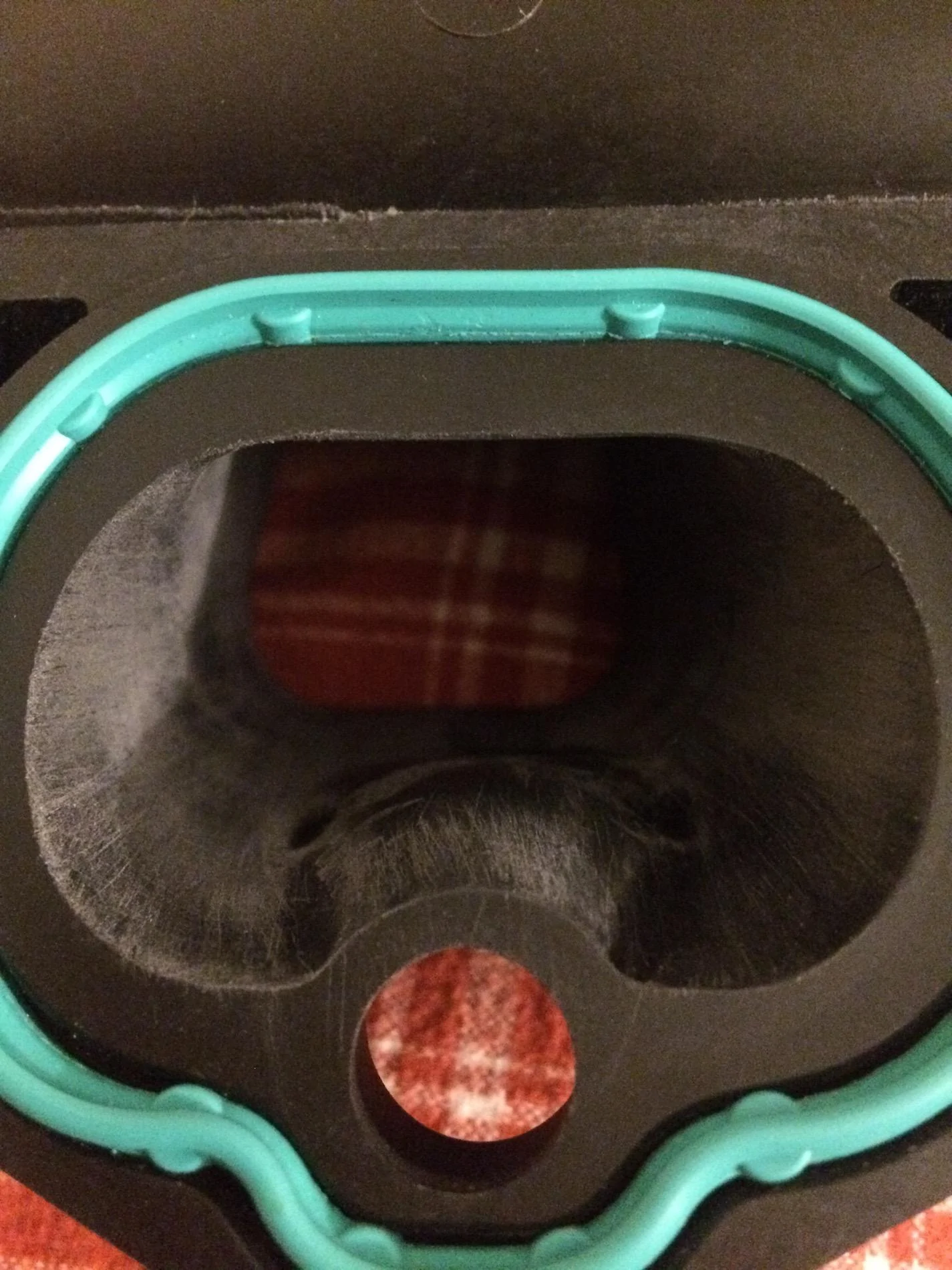

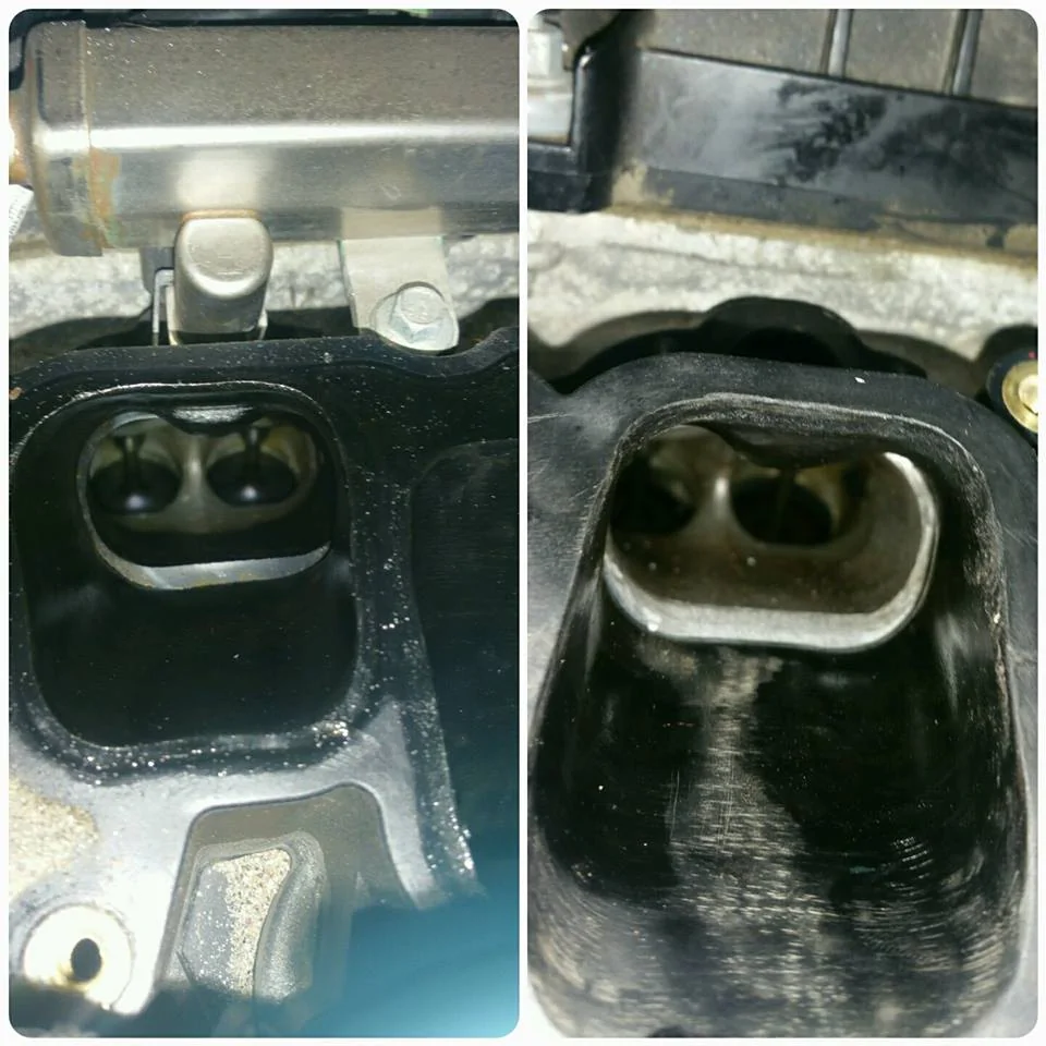

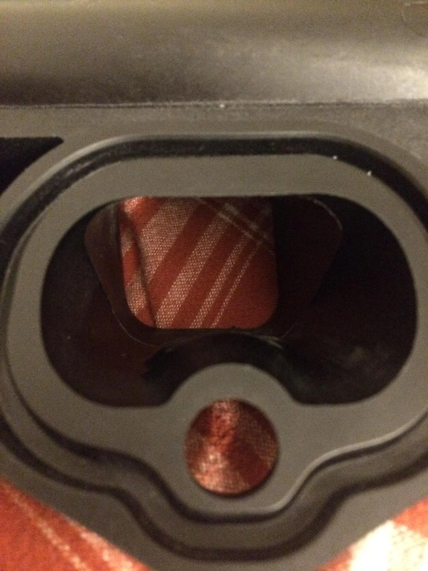

Wanted to give an update to this thread....working on porting my own intake manifolds...first picture is of a non-ported runner...the second picture is of a "ported" runner.
The reason I am putting ported in quotes is that the final port matching will not take place until it is put on the car. The reason I am doing this is to minimize the amount that has to be taken off of the cylinder head and prevent "over porting"(see third picture for example of what has to be done if ported too much)
I will also be sanding down the runners in the cylinder head for optimal flow.
I was quite surprised to find that our lower and upper intake manifolds are both plastic instead of the S197 which were aluminum...so it is easier to work with.
More images will follow as progress is made on porting :)
