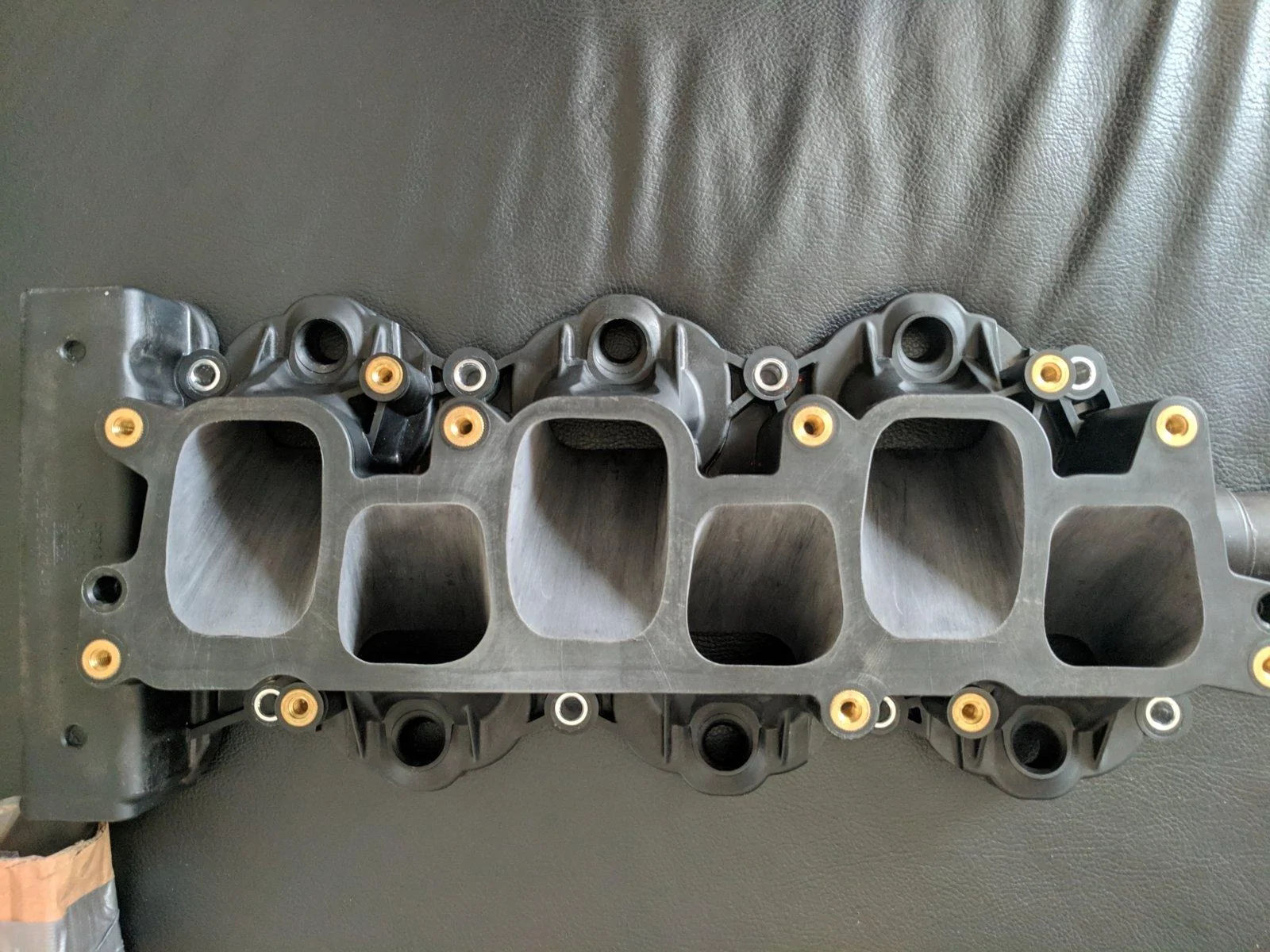

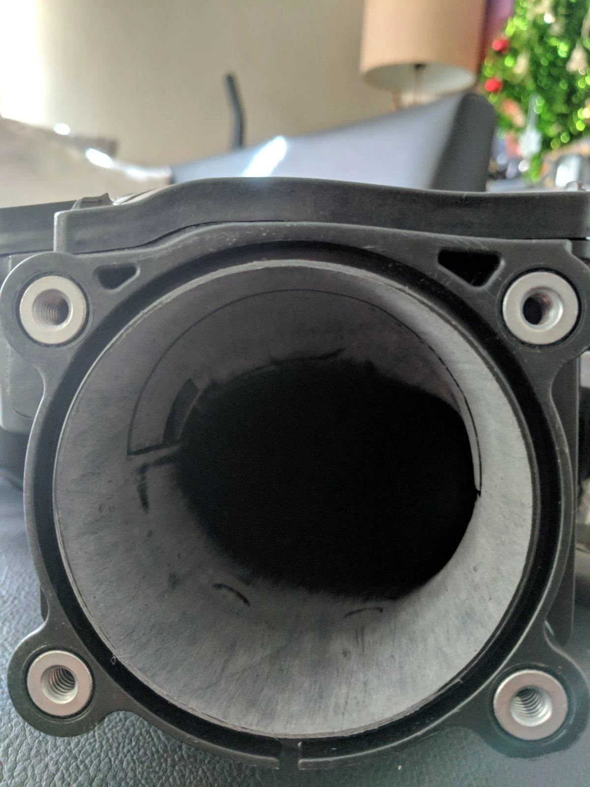

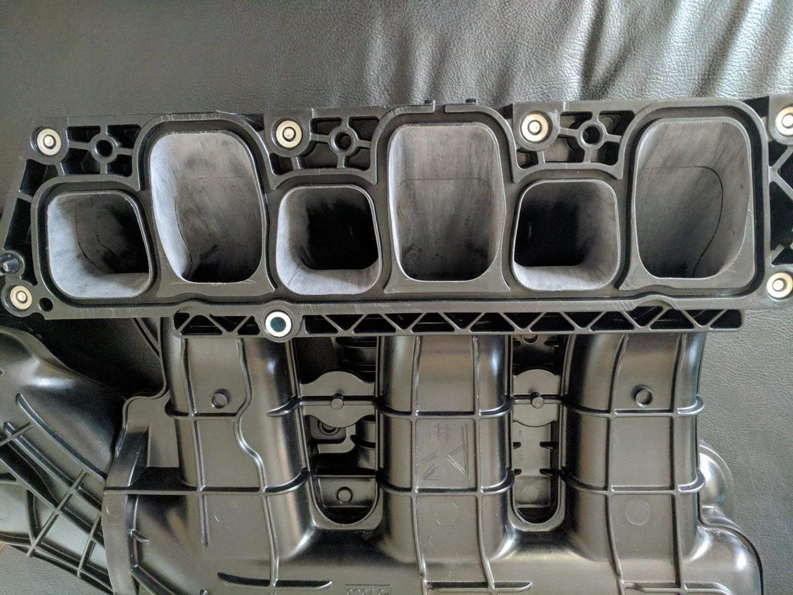

Not sure how many of you guys are on the Facebook groups, but I recently ordered and received my ported intake manifolds from Paul Schnars (P3 is his official name: Paul's Porting & Polishing). Going price is about $300 plus core exchange ($130 fee, refunded when he receives your stock intakes back - for mine he refunded it the same day package was delivered).
Attached are three quick shots showing the throttle body opening, upper and lower openings. Let me know if you guys want any more pictures before I get started with the install, hopefully this week.
