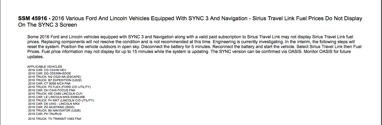

how come the sirius fuel prices not working still? any fix for that?

Lol, Ford is batting 1000 with Sync3.
Delayed Android Auto and CarPlay. Busted Sirius audio antenna. Now the travel link stuff is broken.
Go ford!
