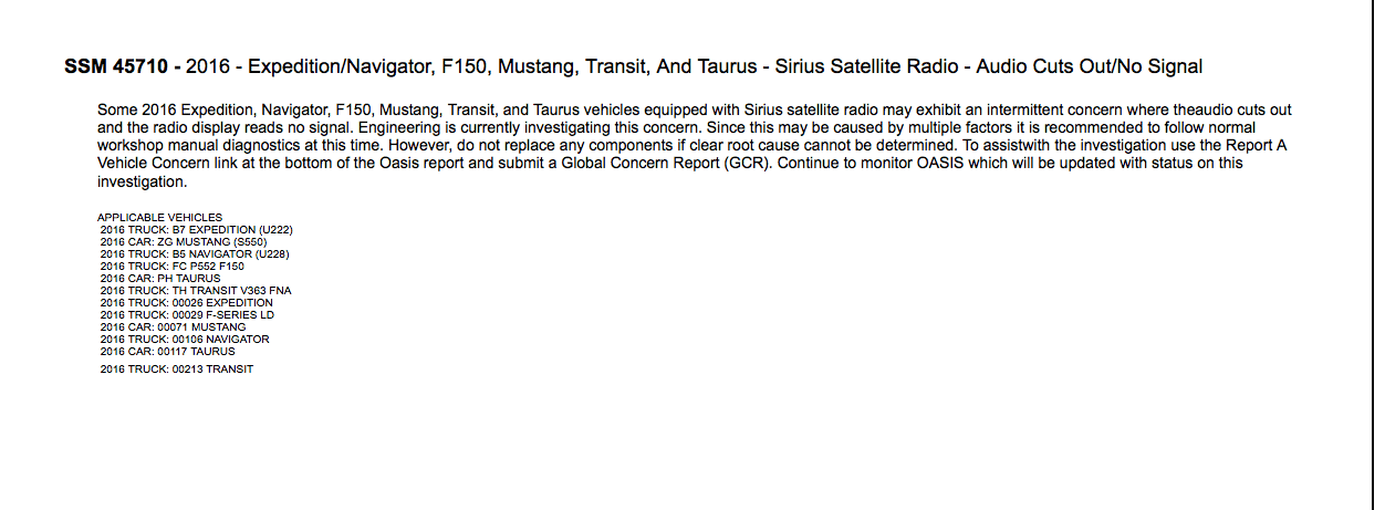

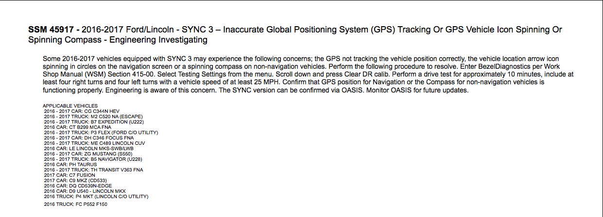

i grabbed th wrong one.. I'll get it tomorrow sometime
