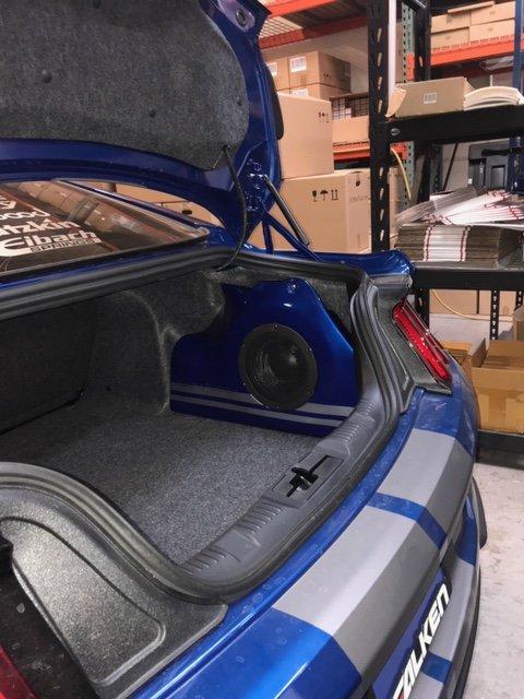

I upgraded the rear deck speakers installed the LC2i and an amp, did some adjusting and now my rear deck speakers can fill the car with music. I also replaced the rear sub and added polyfill to the enclosure.
Somewhat off topic, but can anyone tell me the part number or name (or anything that may help me find it) of the clip/nut the rear speakers screw into? Close up in the 2nd pic. I managed to break the little bastard while installing and having a hell of a time figuring out what part that is.
