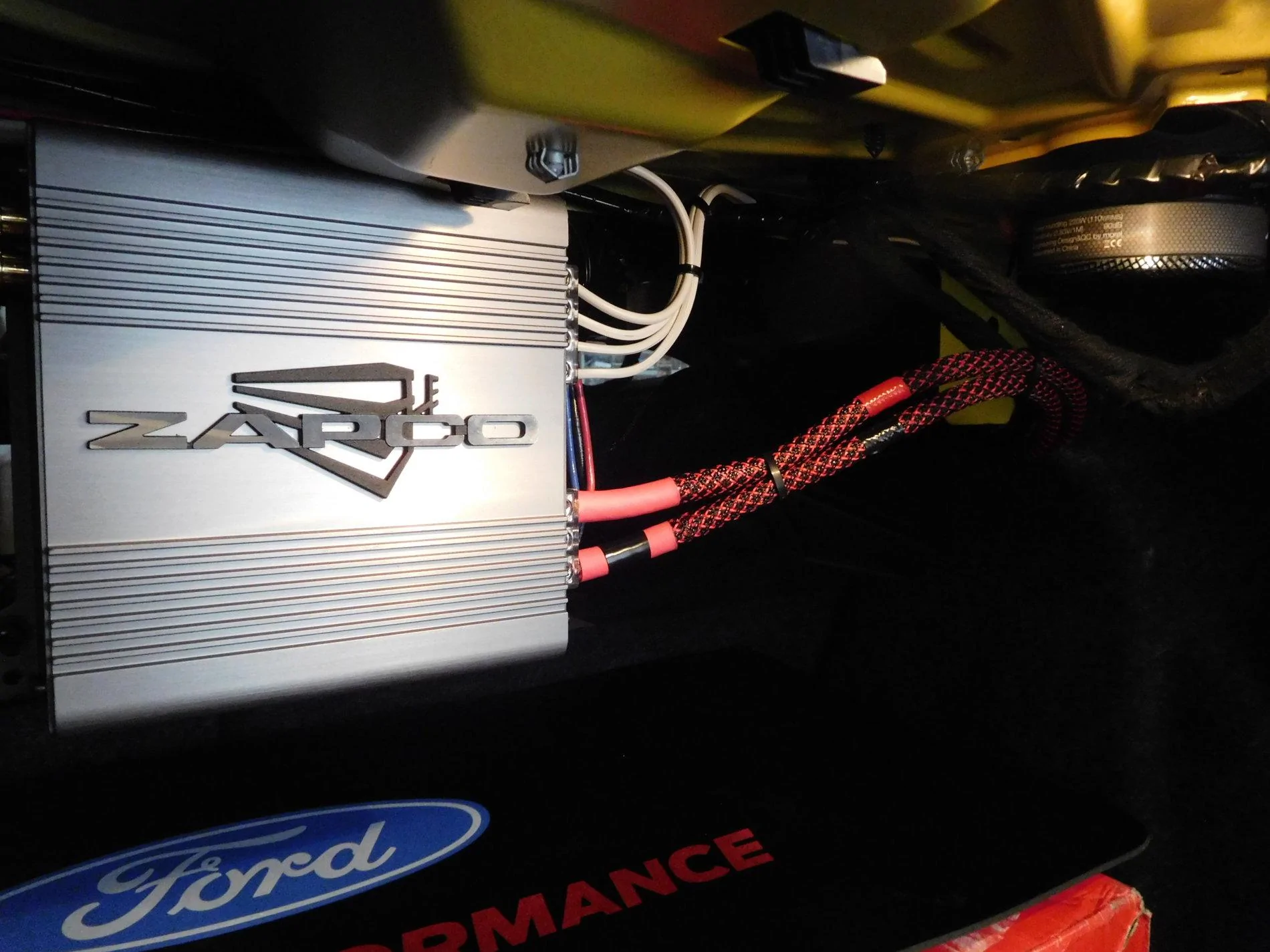

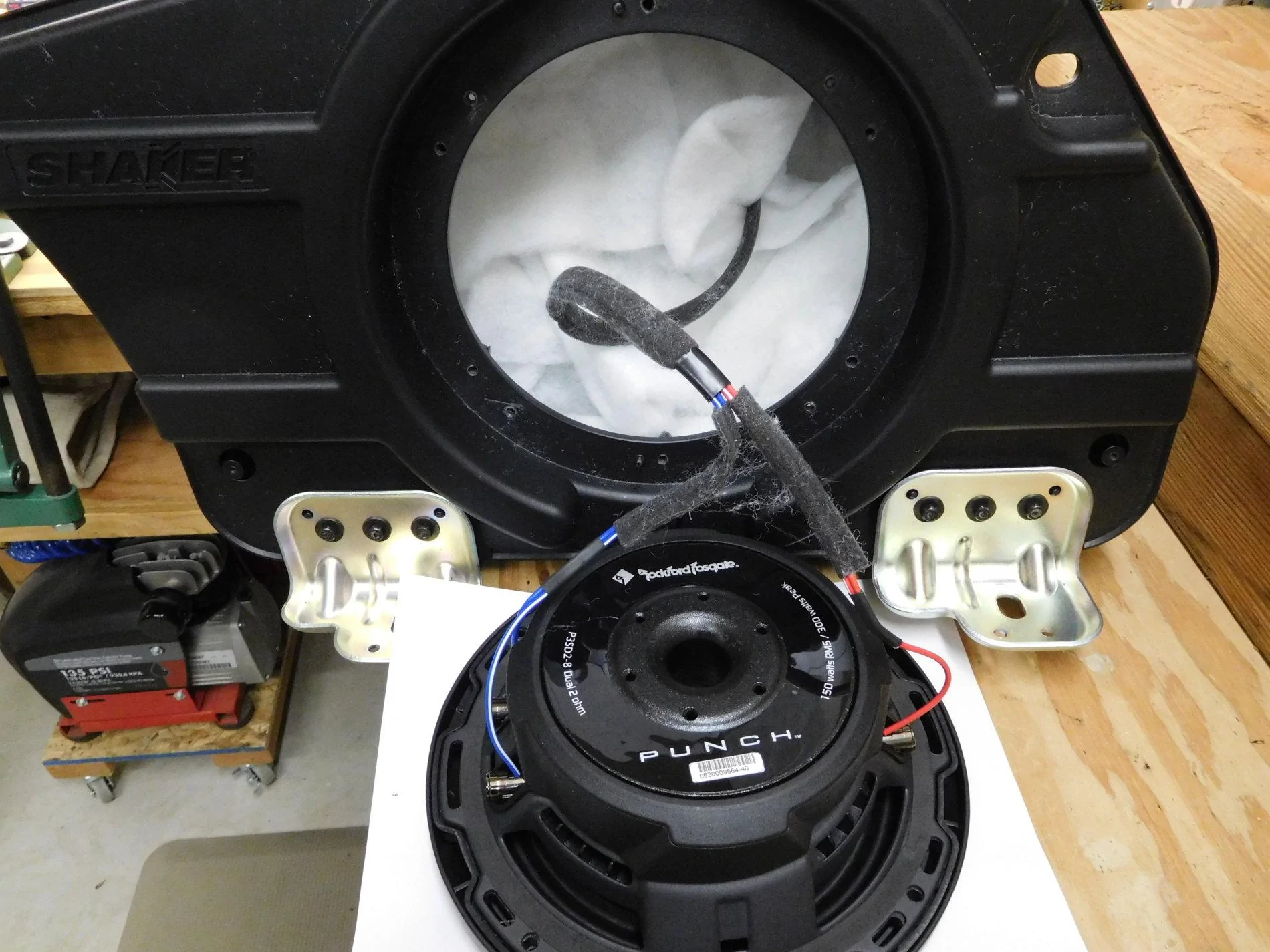

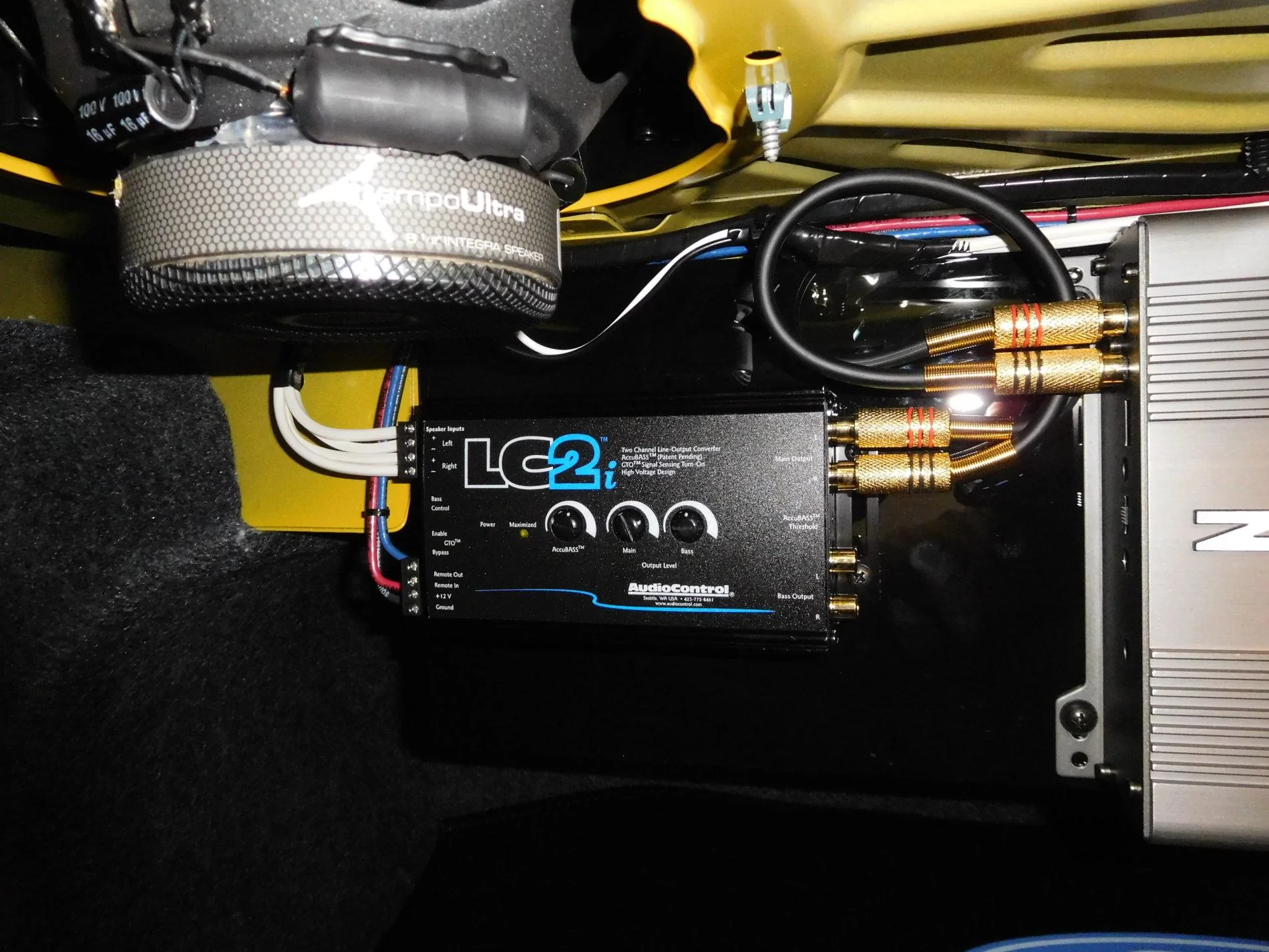

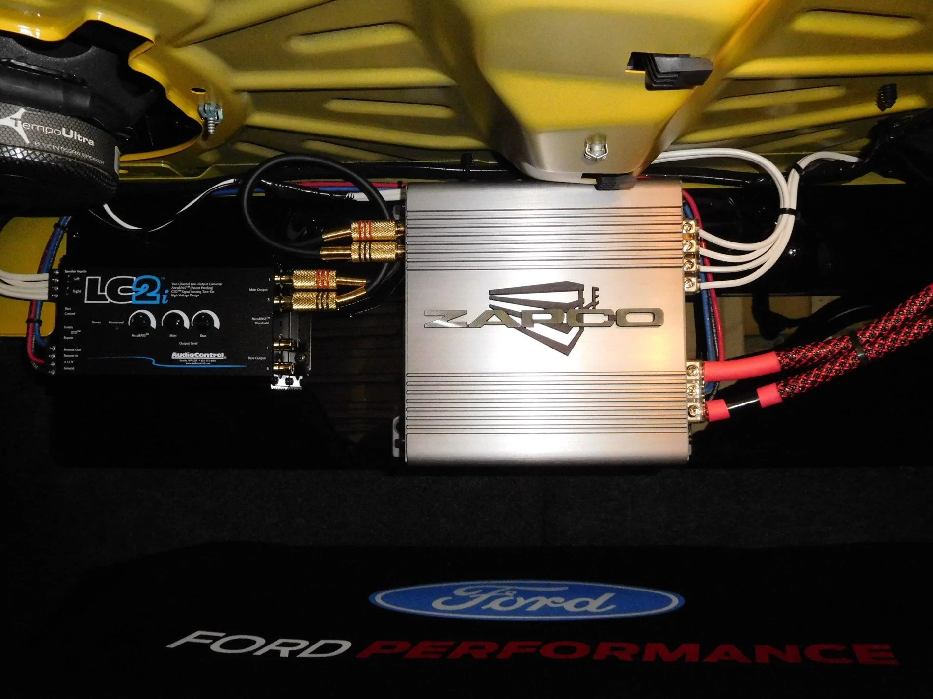

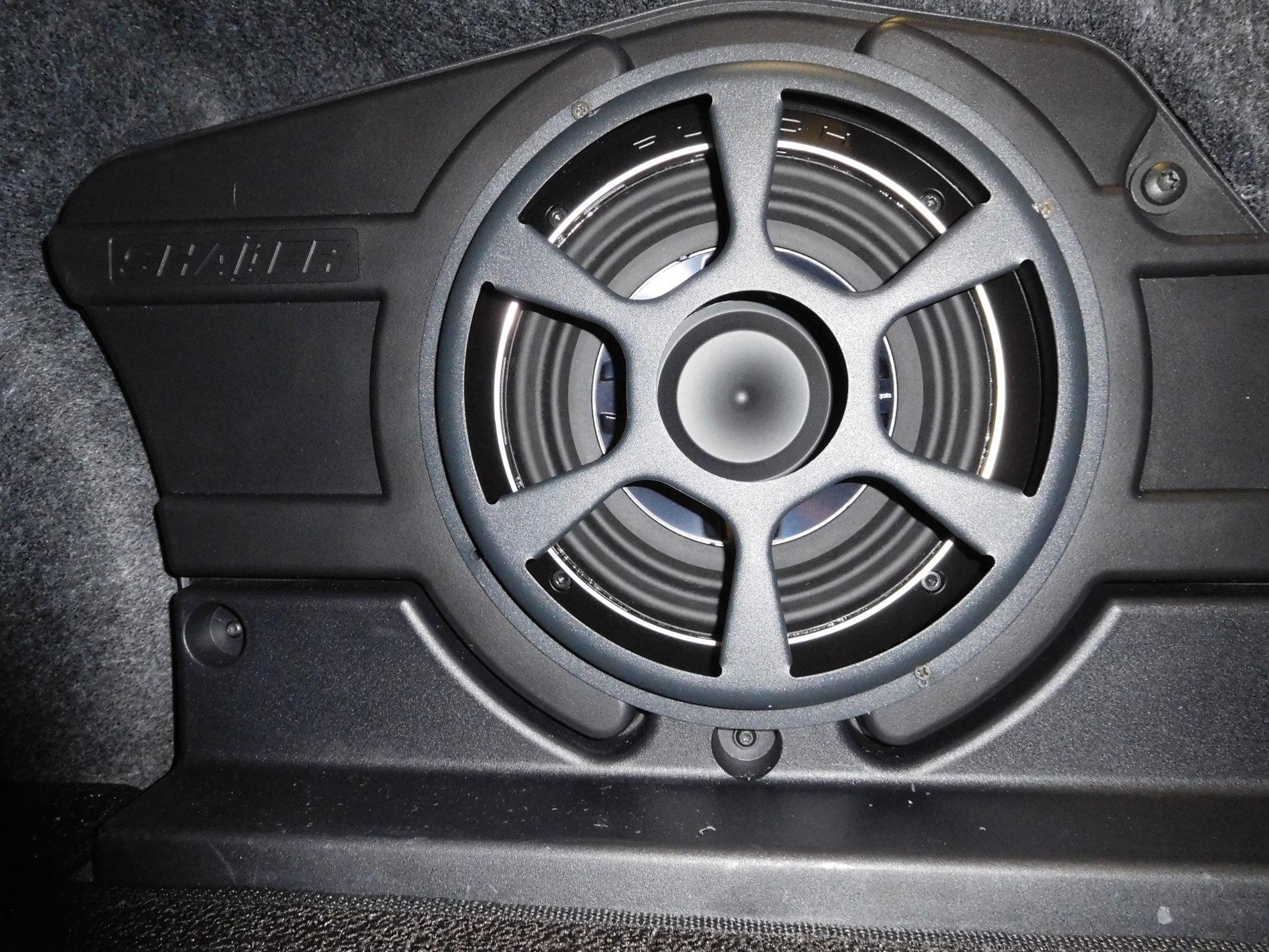

I upgraded the rear deck speakers installed the LC2i and an amp, did some adjusting and now my rear deck speakers can fill the car with music. I also replaced the rear sub and added polyfill to the enclosure.

That looks like a sweet install, I'd be interested in more details of the fit up of all the gear. I must admit I'm a bit of an audio noob when it comes to cars.
