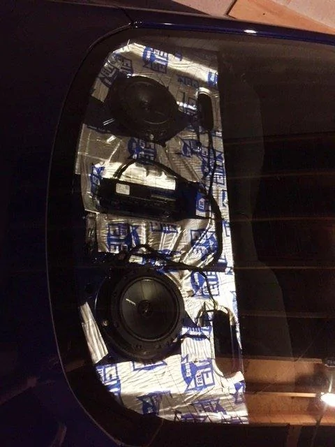

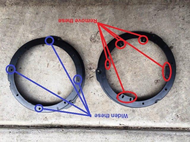

Installed!! The rear bolts holding down the speaker rings was a B*&%$ to get at but I was able to do it with a low profile ratchet and a 9/32 bit. The speaker adapters that Crutchfield sends with the speakers work, but only with modification. The brackets are for 6.5 speakers and these are 6.75 inch. I had to use a drill to open up the mounting spots for the speaker by about 1/8 of an inch and remove the internal tabs with snips and sand them down smooth. They hold the speaker very well even with the modification (see second picture). I used speaker gasketing on the metal between the bracket and on the bracket in between it and the speaker. It is sealed very well. I made the connection like a Y with two new speaker wires, one running to the speakers and one running to my AudioControl LC2i active LOC with AccuBass to run my 12" sub, which will be installed this weekend. All wire connections are soldered, shrink wrapped and re-wrapped with electrical tape. I used fatmat to sound deaden the rear deck. I have the following tips:
1) Just buy the 6.5 inch speakers and it'll be easier. I did the 6.75 just to challenge myself and to let y'all know if they fit. I'm not sure how different the sound would be from the standard fit.
2) Take your time and seal things well and it'll sound great.
3) Do some damn yoga first. My 31 year old, 6', 195 pound body did not like being hunched over in the back seat for hours doing all of this work.
Overall, I am very happy with the sound of the Rockford Fosgate 6.75 inch R1675X2 components. They do get louder than the factory. The mids are good, the highs are insanely crisp, but there is little bass. I don't care as my sub should take care of that. I used to have the treble set at +5 but now it's at +1 and that's without replacing the fronts with the Rockford Fosgate R-1675S components which will be coming up next.
