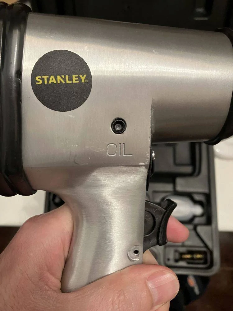

In order to get my wheels on and off easier and faster I bought an air impact wrench. I thought it would be a straightforward affair - just use and forget. But no, it appears it needs lubrication. Sadly, the instructions it came with are absolutely worthless, which is why I'm turning to you for help. I'm sure many of you have used and are using one of these.
First, on its side there's a small hole covered by a threaded cap, whose purpose is clearly marked. The instructions say I should open it with a hex key (supplied) and pour oil into it.
But: How much oil? How often? No idea.

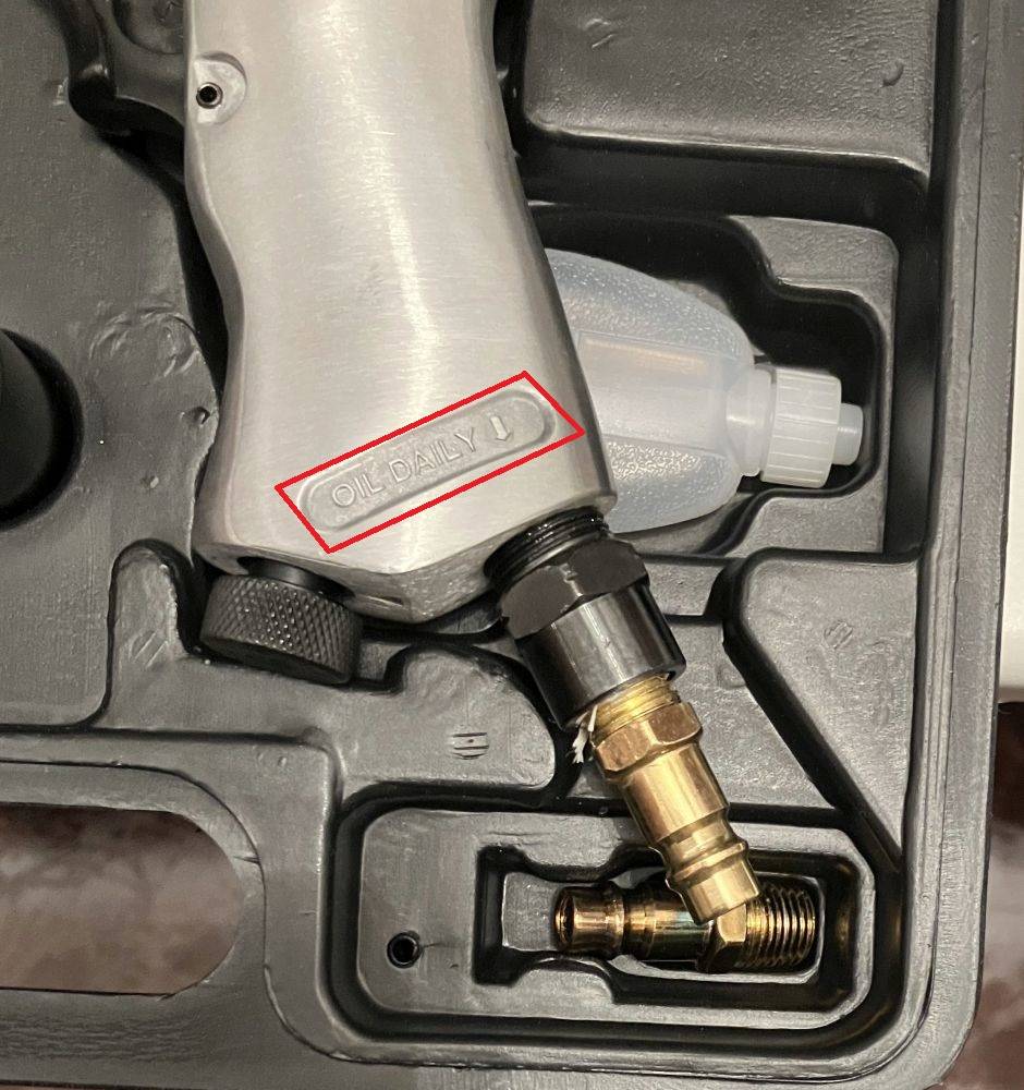

But that's not all. Here's what it says on the other side:

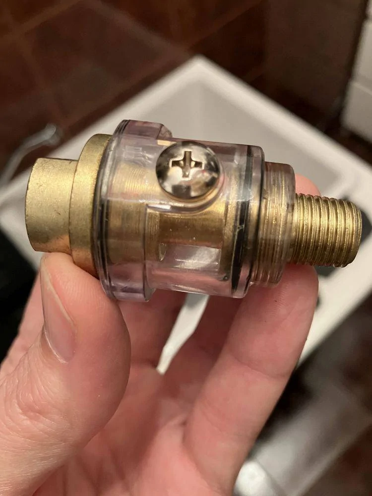

"Oil daily"? But how? Does this perhaps have anything to do with the piece shown below, which was also included in the package?
Am I supposed to install this piece between the air supply and the impact wrench, and to fill it with oil? And is this to be done independently of the other oiling method? I mean, do I have to do this even if I put oil in the small side hole?

I think I'm beginning to understand. There are actually two different things.
One is the air motor, which is lubricated by mixing a bit of oil with the incoming air. This is achieved by means of the lubricator shown in the last picture. You install this on the air hose, as close to the tool as possible, and fill it with oil.
If you don't want to bother with an air lubricator, you can just put a few drops of oil into the tool's air inlet piece before using it, then turn the tool on for a couple of seconds.
The second thing is the impact mechanism, which must be lubricated independently of the motor. This is achieved by pouring oil into that small side hole.
OK, so the principle is now clear to me. But I still don't know:
- how much oil to pour into the side hole
- how often to do that
- what kind of oil to use
My understanding is that the two mechanisms need different oils. The air motor needs a thin oil which can be easily pulverized, whereas the impact hammer needs a thicker one. But all I can find on the internet is simply oil for air tools - no mention of whether it's for the air supply or for the hammer.

I'm not familiar with the oil reservoir on the side, most air tools use a grease gun designed to inject air tool grease to help seal the vanes and an oiler like was included with your tool, or you can just drop 3-4 drops of oil into the inlet prior to connecting to the air hose. I'm guessing that your impact has closer tolerances than automotive professional tools and that the reservoir is for the vane sealing, in place of what I use grease for.

Hello; I have gad and used air tools for decades. Including the air impact type. I also have one of the oilers pictured in your hand. Unscrew the phillips head screw and hopefully have a spout small enough to fit into the hole and fill it chamber up.
Thing i have found is this oiler gets empty very quickly. My unit may be damaged but within moments of use the oil is gone.
So most of the time I do not bother filling the do-dad. I have quick disconnect fittings on all my air tools and air hoses. I have an oil can handy. I disconnect the tool from time to time and simply squirt some oil directly into the tool in the hole where the air enters. On some tools I have to press the trigger to get the oil to go on in. So much simpler than that little chamber.
As for the small side hole on the tool itself. I may have tried that decades ago but ignore it the last few decades. Will not hurt to crack it open and squirt some oil in if you feel compelled.

Yes, in the meantime I have come to the same conclusion. The in-line oiler looks like too much trouble. I'm gonna just put a few drops of oil in the inlet from time to time and call it a day.

That’s a good plan. All the pneumatics we use daily are lubed the same way. Every day. I use synthetic in mine for the simple fact the compressed air isn’t the cleanest unlike my shop where the air supply is cleaned for paint application. As much as I like my battery tools(20 and 60 volt) there are times theres no substitute for quality air tools.
