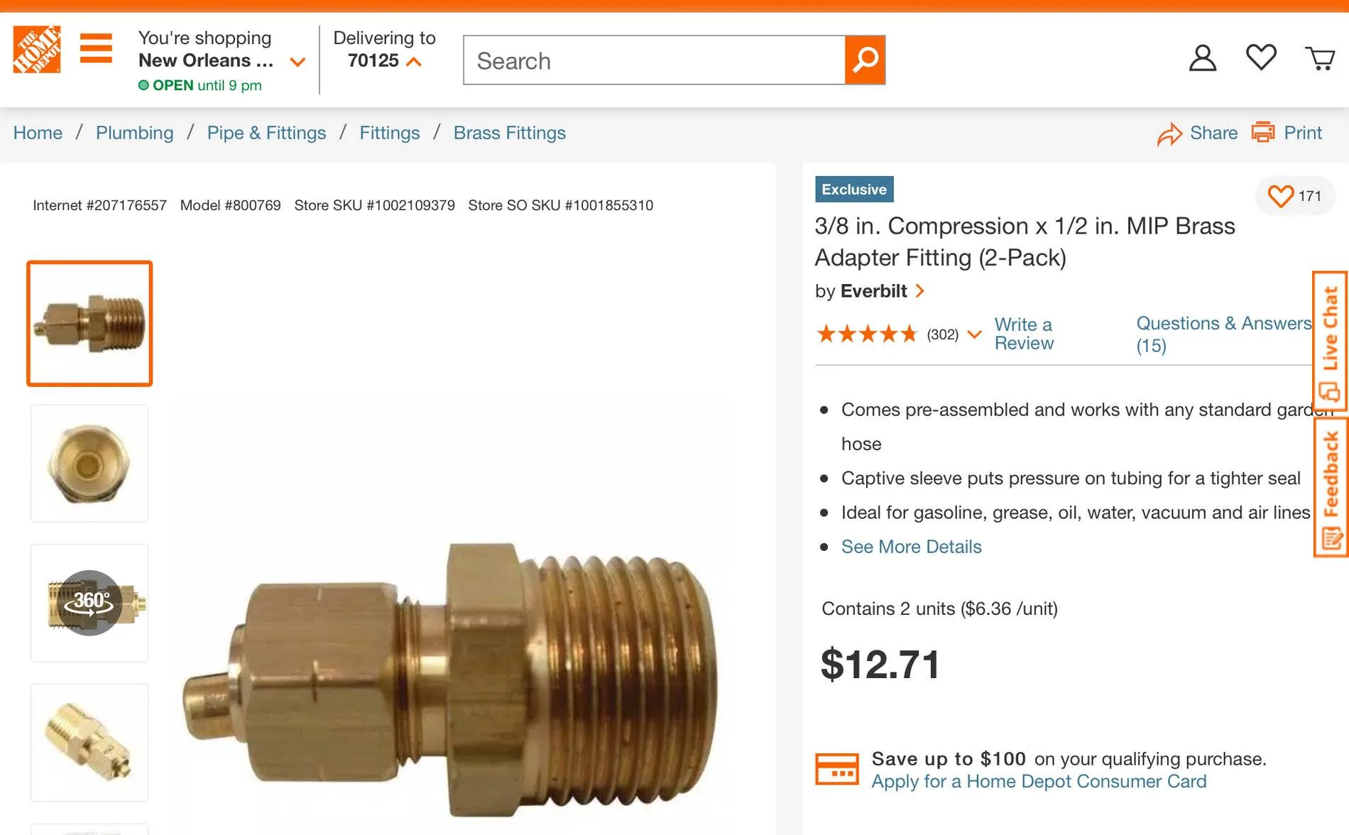

Thanks, we're almost there.
That wouldn't allow shutting off the water to the 1/2 hose outlet for the 99.97656% of the time it's not in use. But maybe an in-line shut-off valve could be put in-between the 3/8" fitting and the 3/8"-1/2" fitting?
