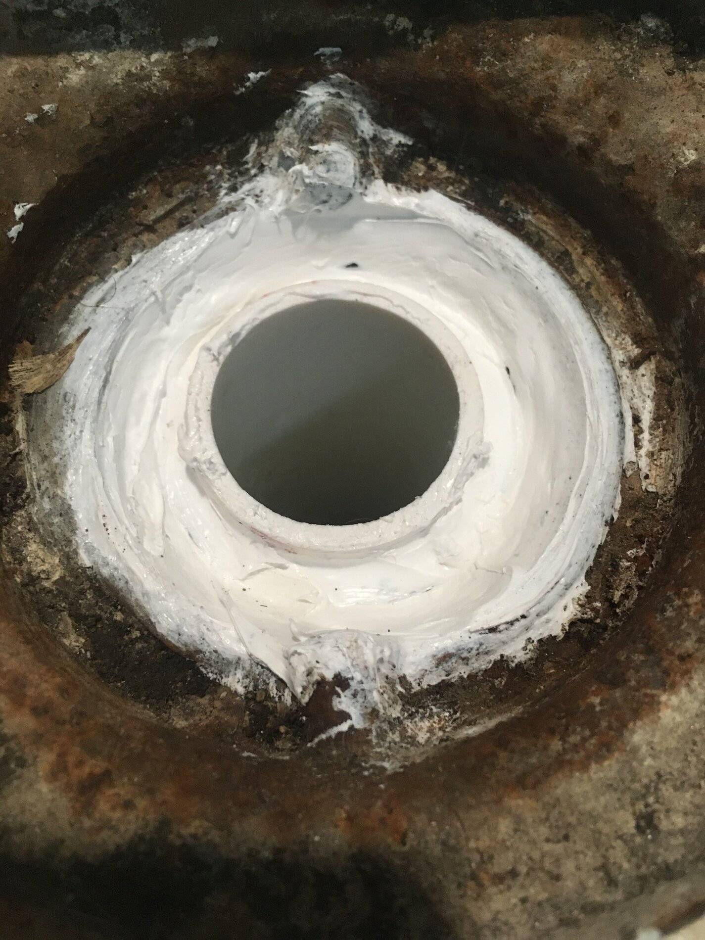

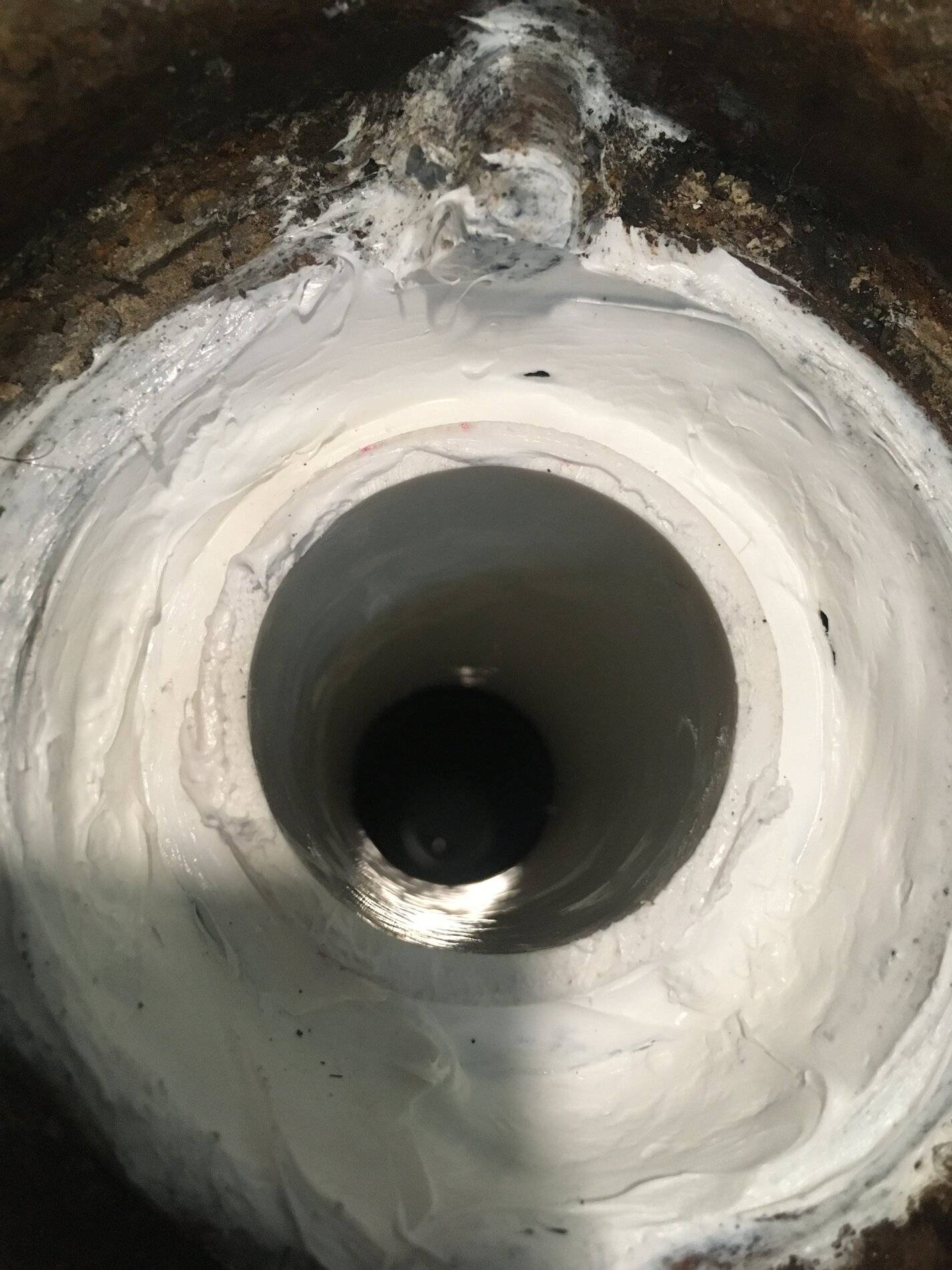

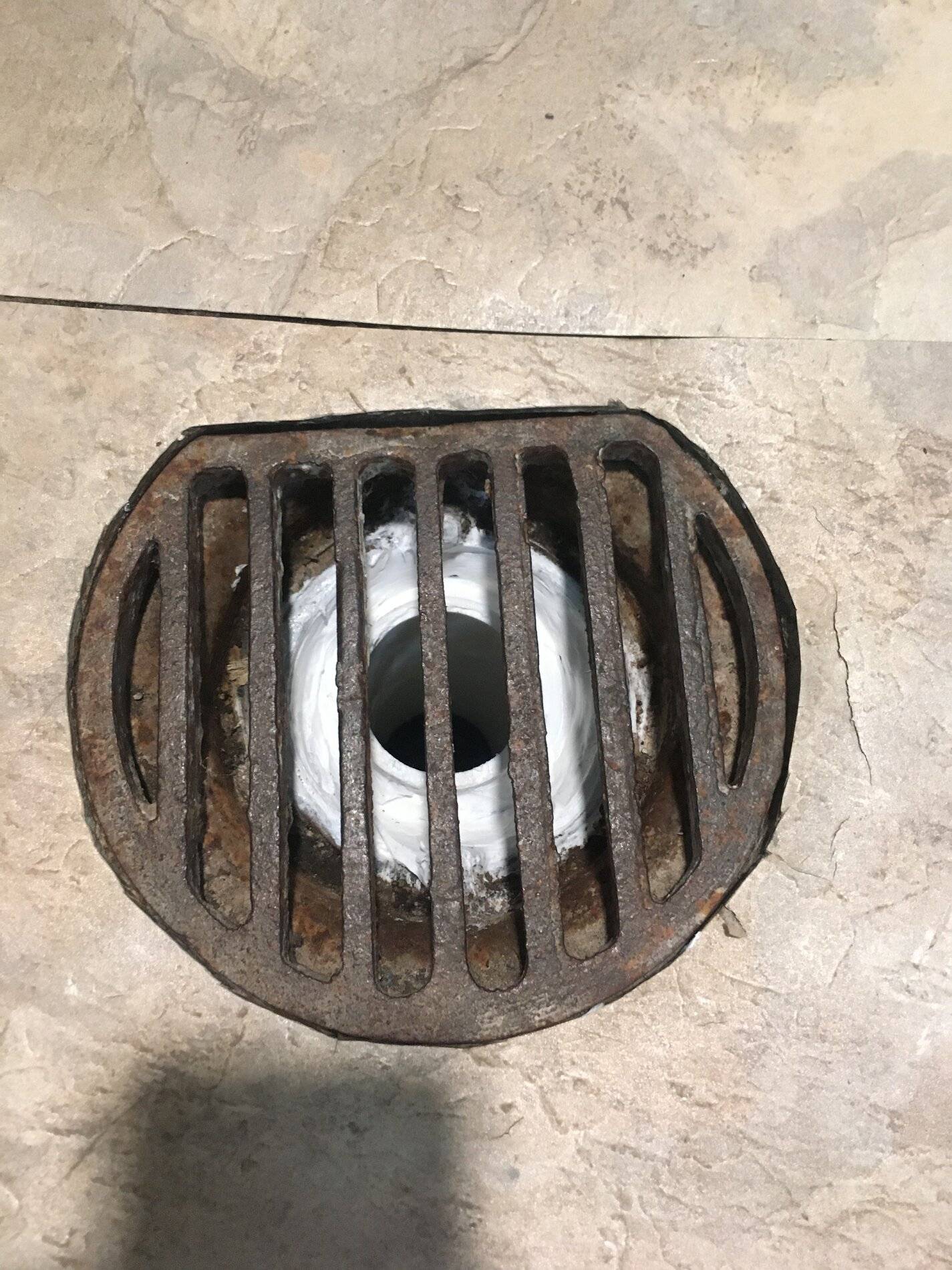

Ignore the looks of it, but I couldn't find 2 1/2 pvc anywhere, but I found 2 inch pvc, and 2 rubber couplers with an outer diameter of 2.875 inch, the drain is 3 inch inner diameter. so what I did was, I put 2 rubber couplers on a 2 inch pvc, it almost filled the hole, I caulked them to the pvc pipe and gave myself a nice handle when I want to ever remove if I need too.
I put caulk on them and dropped them and turned it around in the hole, hopefully sealing it up. I caulked the top too, I can remove them if I need too, but this was my attempt to fix the hole from backwashing out.
since the hole isn't 3 inches anymore to put a shppvac in, I ordered a long 1.25 inch wand for the shopvac, should reach the bottom and suck it all out. I made sure to clean it as spotless as I could before I did this too, there's no debris in the bottom of the pit.

Hello; The only issue will be the smaller opening will drain slower. That will not be a problem unless you have a big dump of water. One good thing is with the smaller opening it will be harder for stuff to clog the pipe down stream. You could test it by dumping a bunch of water I guess.

Hello; Well I am one who wants a spare tire and always wears a flotation device in a boat. I would maybe fill up a tub with some water and dump it to see if the drain works. Maybe five gallons first time, then ten gallons or so.

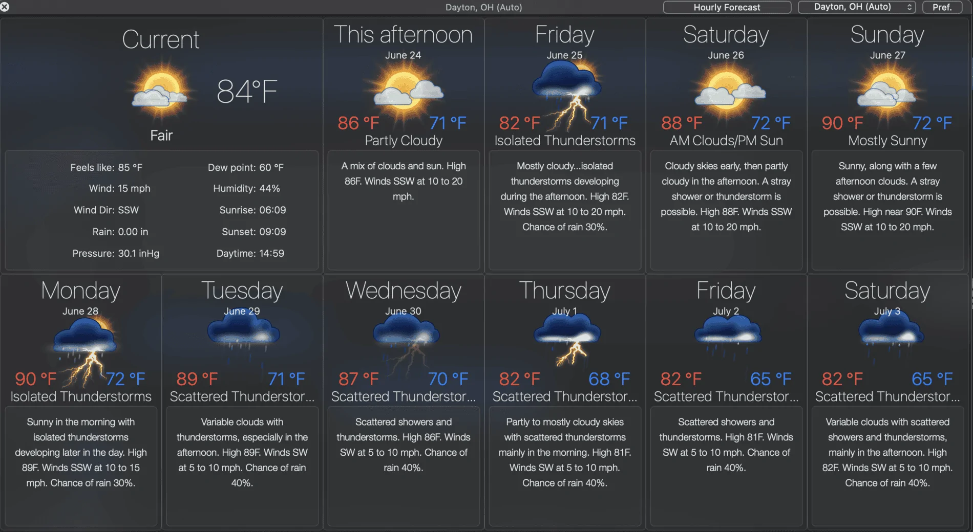

we got some storms coming, I will monitor it fully to ensure the drains working as intended.
