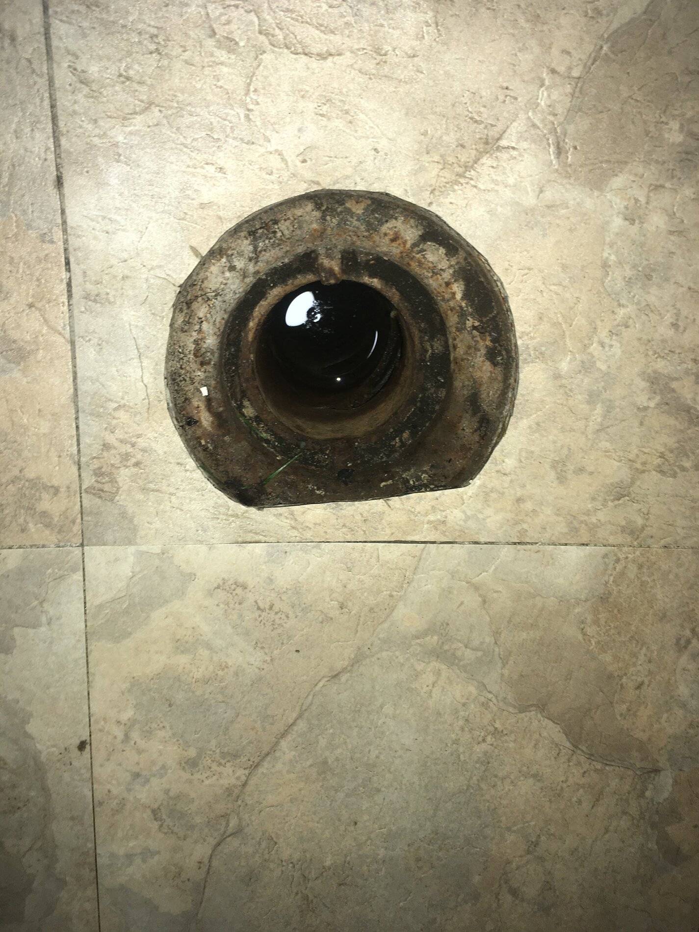

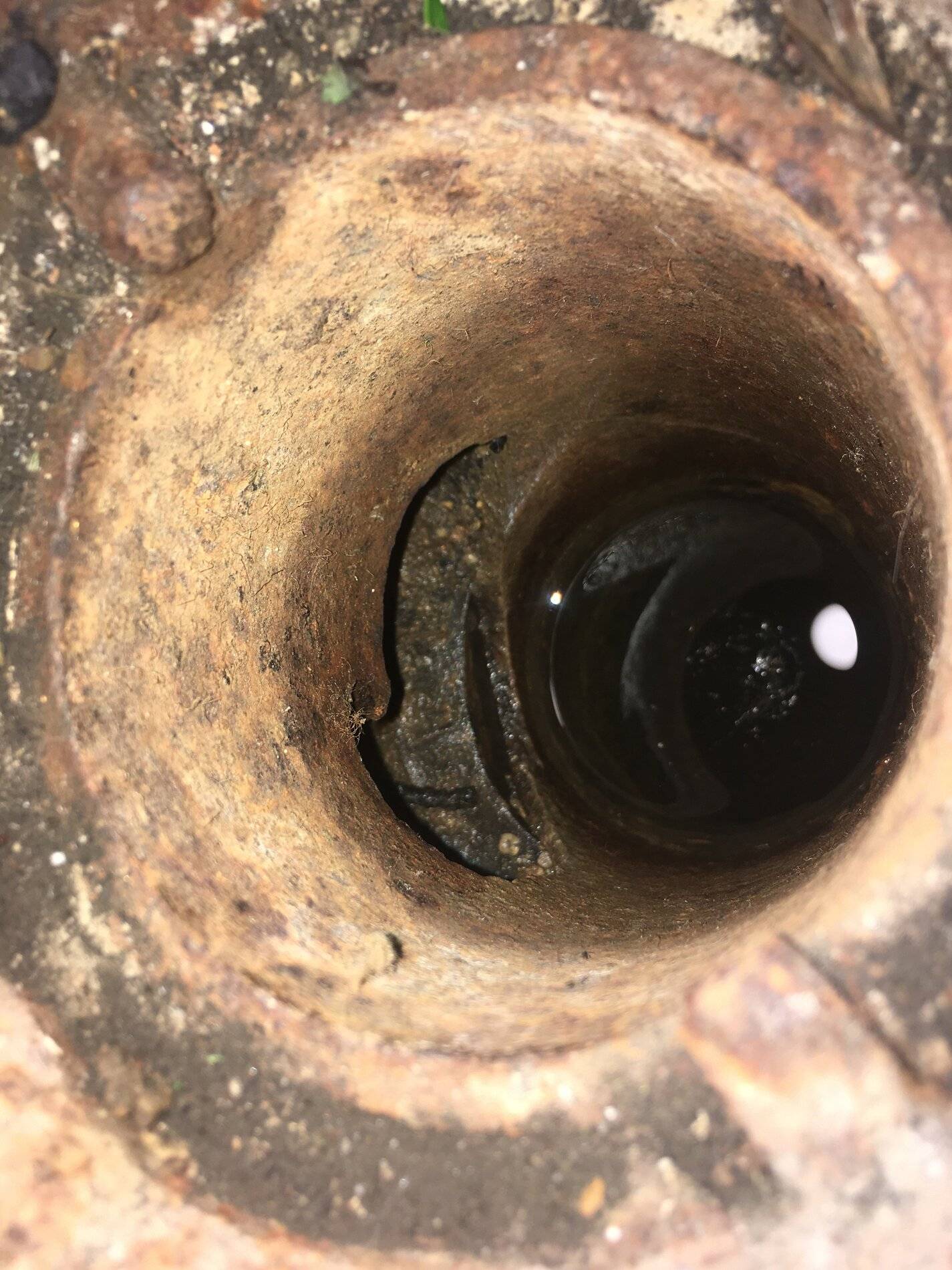

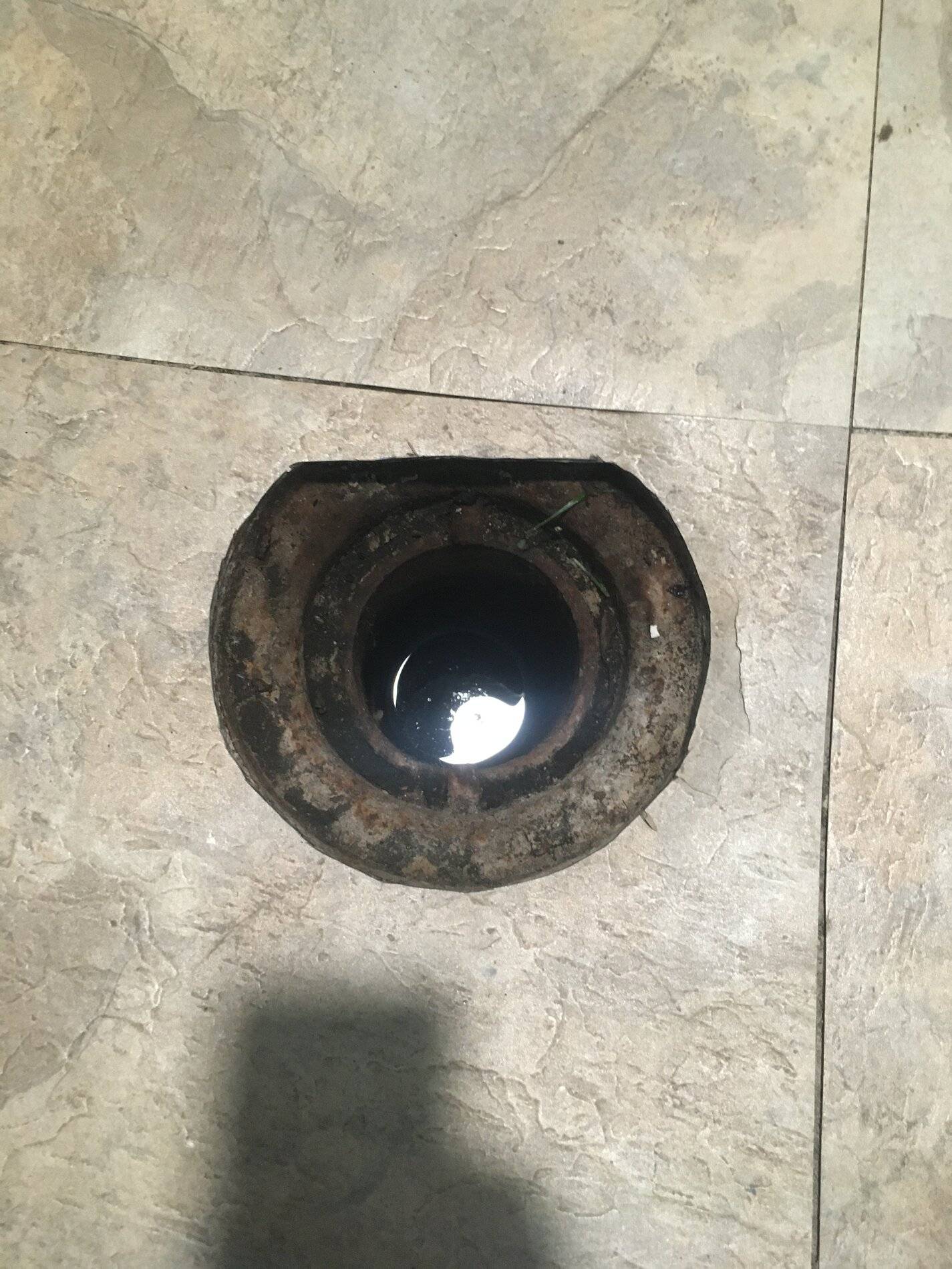

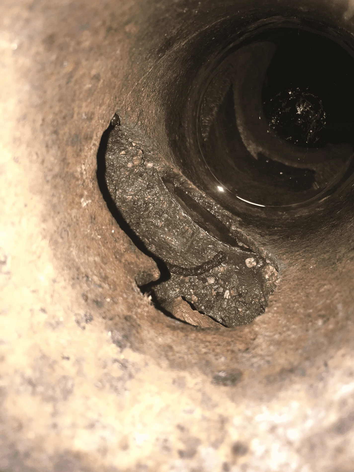

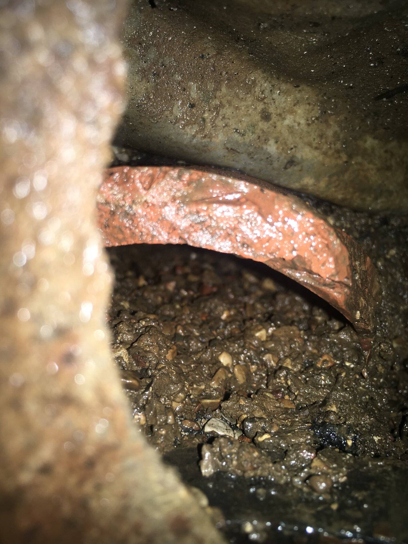

I noticed last night tornado the drain water was getting real high, I reached arm down in hole and there was gravel. A lot of it. I sucked it out and drain resumed working.
I realized there was a hole in side of drain pipe. ): it busted I don’t know how, I reached hand into the broke out hole andpulled out a chunk of the missing pipe, the other piece is stuck in there
I wanted to pull both out and jb weld the pipe back together or something
how does this happen? Cost estimate? Do it myself?

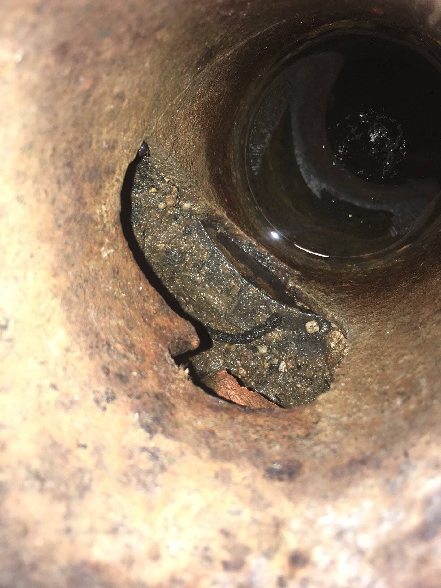

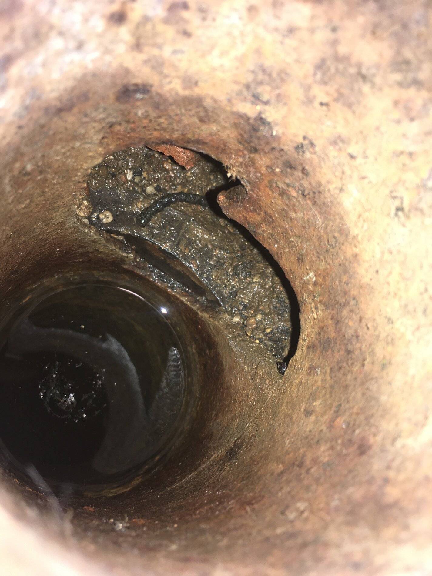

I noticed in photos, it looks like, from the broke out piece, there's a longer crack running. how does this happen? I mean my house is never freezing. I can dry up the entire pipe when it dries up a bit, should I toss some rocks back in that hole? like backfill?
will bondo/roofing patch compound work longterm? I really dont want to demo the floor. I would love to get that other piece out, but I cant get anything in there to grab onto it, and pull it out, use those for the helping patch
top of it running up and to right.

Cast iron is brittle. We used to remove black pipe with a sledge hammer breaking them at the joins. Houses settle and the pipe don't give.
Tree roots can do that too.

That would be a temporary fix at best. Water is insipid. The pipe has failed and I would call one of those trenchless pipe liner companies for a quote. The pipe may also have failed below where you can see or reach.

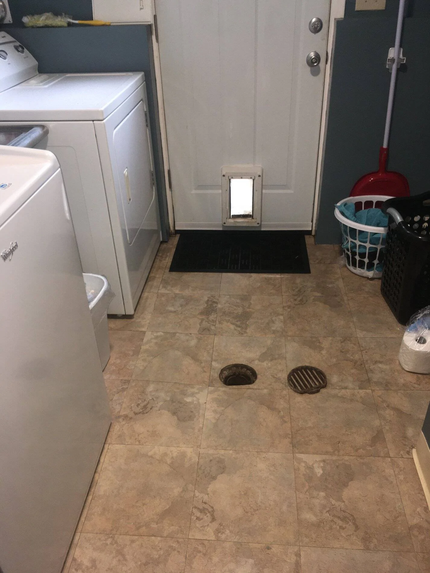

I have 3 levels. Mid floor. Upper and lower finished basement.
The door behind the photo is a flight no exterior stairs that go to ro flat level ground. There’s also drain out there too
