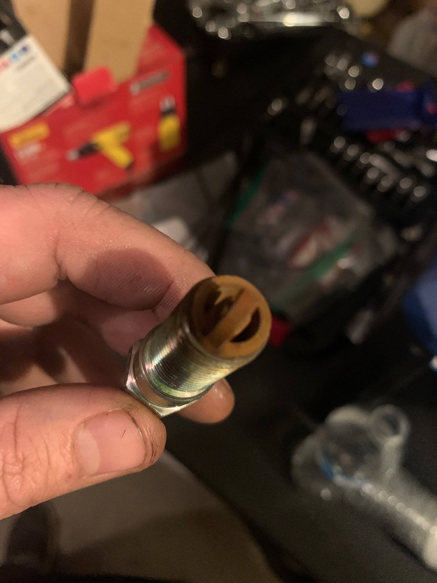

Thanks guys so I got a chance to pull the plugs today completely wrong part in it. It is just the standard plug from the factory. According to the part number it doesn't match what roush says.
After looking at the plug it look like it is running super lean the plug is rust brown. I will try figure out how to get a picture on here.

octane booster can make plugs look brown/orange this is a few thousand miles of boostane.

Looks like Boostane was ran on those plugs
Orange Ash, I won’t run MMT additives in my car
Good ole Shell 93 (Splash of Race gas with no MMT) for me :sunglasses:
Yeah honestly I don’t really care about the orange stain might cut down the life of the plugs a little but I don’t mind for the safety it provides and boostane is cheaper than race gas and works great as an octane booster. At the track I run straight race gas not boosted pump gas.

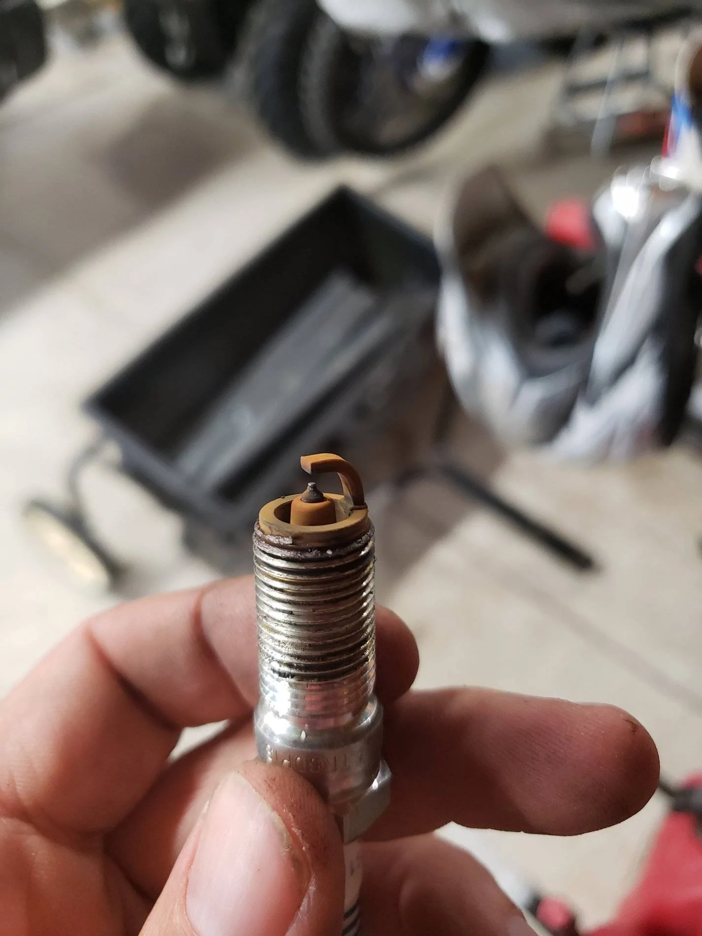

This is what my plugs are looking like

I changed my plugs 4 weeks ago the old ones looked like that also. I use lucas octane booster every tankful. Its normal for them to be red using octane booster..
