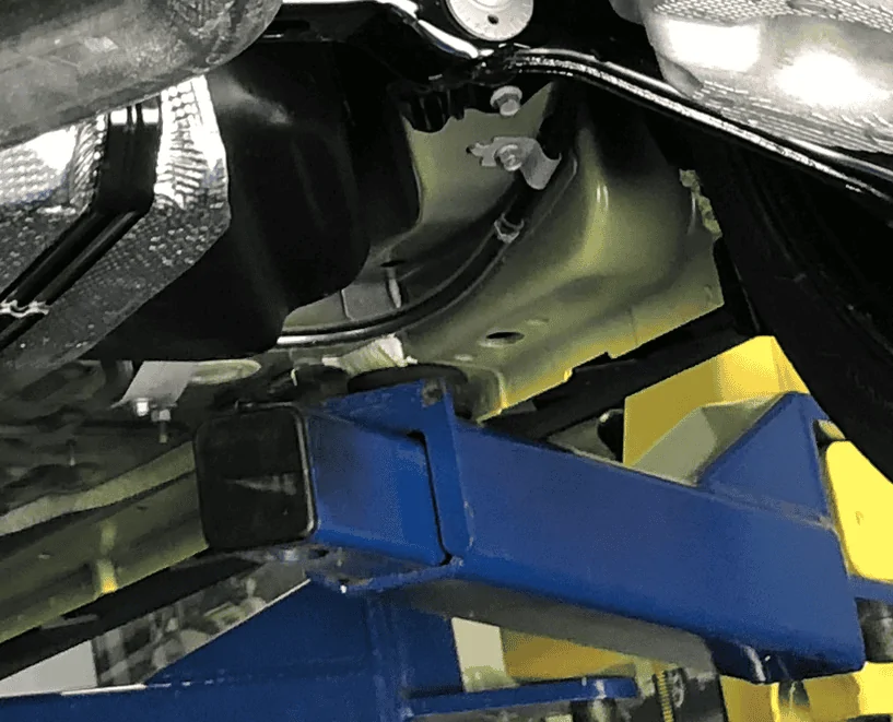

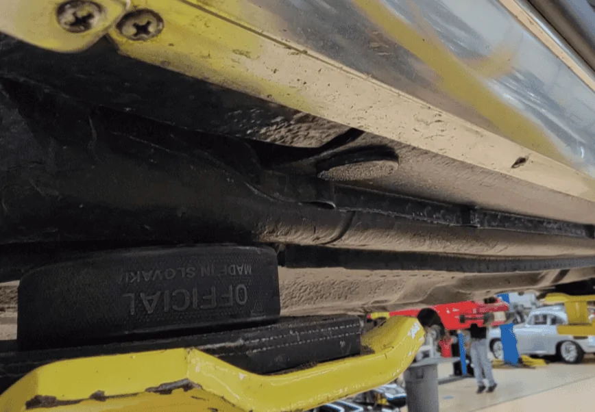

I bought 10 Hockey pucks with all the money saved from not purchasing the Steeda product and use them for buffer between jack points and car (photo below is a Porsche) but you get the idea.
