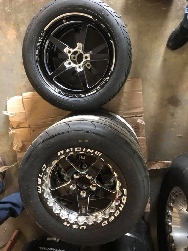

No need spacers.
I have
17x4.5 Alumastars
Sportman S/R MT
28x6x17
17x10 Weld Single beadlock S71
MT ET Streets Bias Ply
28x11.5x17

No need spacers.
I have
17x4.5 Alumastars
Sportman S/R MT
28x6x17
28x11.5x17
Did you have to change out wheels studs to 1/2 inch and use open end lugs?
So the wheels look good without spacers and also my mustang is a base model with standard brakes?
I want to go with this combo and thanks for taking your time to answer my questions.

No other mods just put the wheels on and welds recommend using stock lugs.
I have premium gt non brembo and upgraded to baer drag brakes. 4 piston
