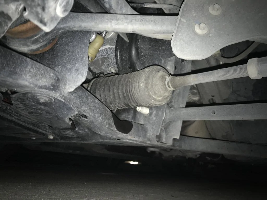

Being an accountant this time of year doesnt leave me a lot of time to mess with the cars, but I was able to snap a pic of something wet on the front drivers side..

did you have the engine oil and filter changed recently?
I changed the oil about 5K miles ago.
Ill check the dipstick today.. :frusty:
