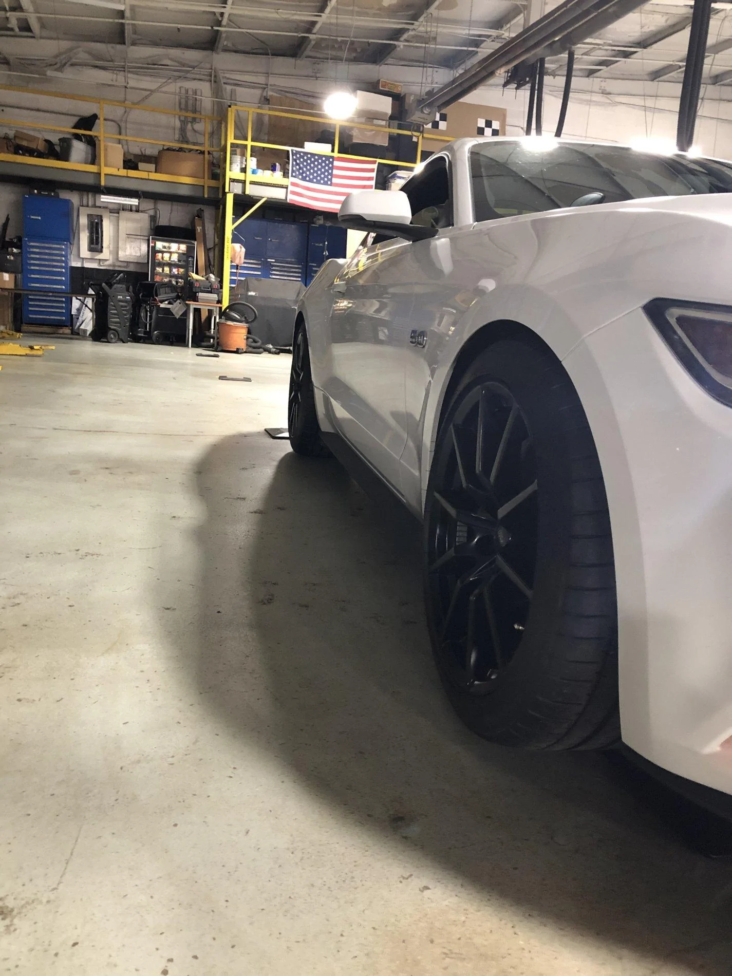

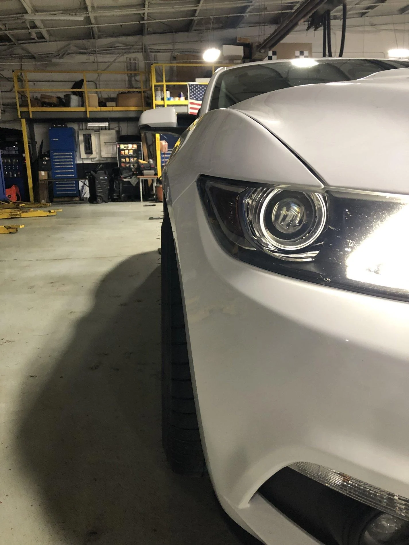

Currently I am on Feal 441 coilovers with the stock performance package wheels and 25mm spacers. I have a decent amount of camber. attached is a picture:
currently with this setup I am not rubbing at all.
