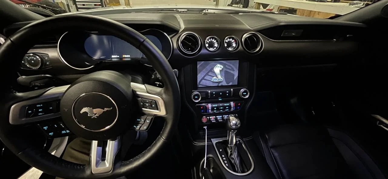

Yes, I have a 23 gt premium and I installed the gauges and trim from a '17 GT350. The AC/Heat vent trim is slightly different. Not noticable enough for me to change the steering wheel trim with it.
I got both the trim and the gauges from Ebay for $300.
