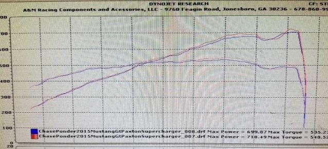

Took my car to the dyno last night, Only mods are Paxton Kit with 3.48 pulley, VMP BAP and Cat back...Car has Stock headers and cats! MS109 fuel
Still seeing some belt slip, I believe im at the limitations of the stock tensioner here...

Are you 6 rib still? If so, you are not at the limits.

Still 6 rib

Strong numbers for such a simple set up. Love it!

I made 771whp on the stock tensioner at 14psi

very nice, we do have the ars tensioners now, that and playing with some belt / idler sizes will help, we can usually get to a 3.33 with no slip

Good numbers, exhaust will surely open it up some. I'm wondering what my car would have done on 14psi at this point.
