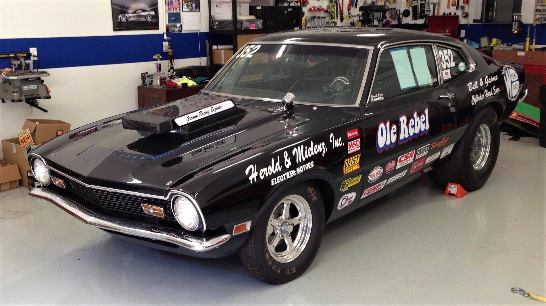

Wow, the best I could do was a 2.03 60'. I only had 25psi in the rear 285 Michelins, 1/4 tank of 91 because that's all we have, fronts pumped up to 45psi, air filter out so the box was empty, TC was off, skipped the water box, had the OE active mufflers were open, power braked it to around 2k, then had the emergency brake on until I felt the tires digging in, I think I gained about 300rpm. I tried it in all modes and the fastest was standard and letting the trans shift itself. I'll be interested in seeing what the FPP CAI/tune will produce.
I'd say the 1.7 60's was incredible with the stock converter as my 70 Maverick only cuts a 1.29 60', although runs 9.80's @ 136.

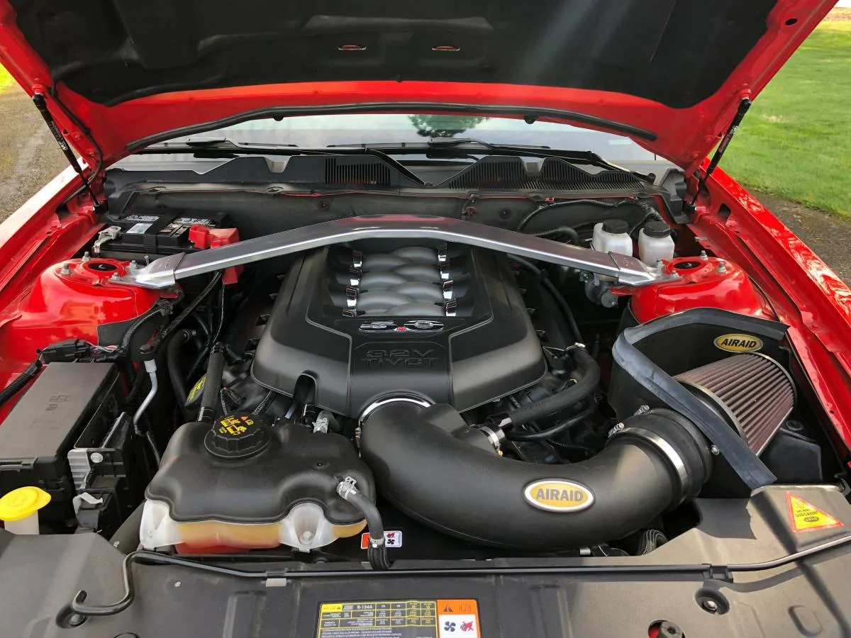

For this "Ole" drag racer, the proof of the pudding is in 1/4 mile times. I know quite a few people who used tuneless CAI on their 2011 to 2014 GT's with no measurable gain in horse power, at least no change in 1/4 mile time or speed. My 2014 Performance Pak showed 0 gain with the Airaid CAI without a tune and the adapter in, and when it was taken out and tuned by AED it showed over 1 second in 1/4 mile times along with 6mph.
When I put the X pipe resonator delete on my 19 GT PP1/A10 I know there was an improvement in my finely tuned seat of the pants gauge and we'll see how much I can improve with the M-9603-M8B Kit with calibration.

Nobody has seen any gains from a intake alone or a catback without a tune. Because it’s the tune that got the extra power.
The most restrictive part of the exhaust system is the catalytic converter‘s. after the cats you have less exhaust pressure than before. so it doesn’t matter how much extra flow there is behind the cat if you still have the cats.
