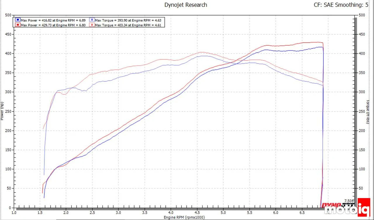

Once again, MotorIQ in the article I posted saw almost 13rwhp in a full catback Borla S type exhaust with a dyno done at Palm Beach Dyno. The baseline was inline what a stock 2018-2020 gen3 cars make. A lot of times they show a low baseline and then do the parts only to get back to to the point a stock car should be making and claim it made hp when in fact it didn't. There is a lot of credibility in the test done. The link again..
Borla Stype catback
The dyno of the Borla S type catback 2018 Mustang GT done at Palm Beach Dyno..
Borla Stype catback
I knew this graph was going to get posted.
1. The runs are well within a run to run Dyno variance. Why not a few stock runs, and a few modded runs?
2. I spoke to a few people who did that test on that same car, you do realize, they basically drove to PBD, immediately strapped it to the Dyno and ran the first test (stock). The second test was done after a few hours and a cool down.

Dyno discrepenacies on normally aspirated cars are generally a few hp not 13.
