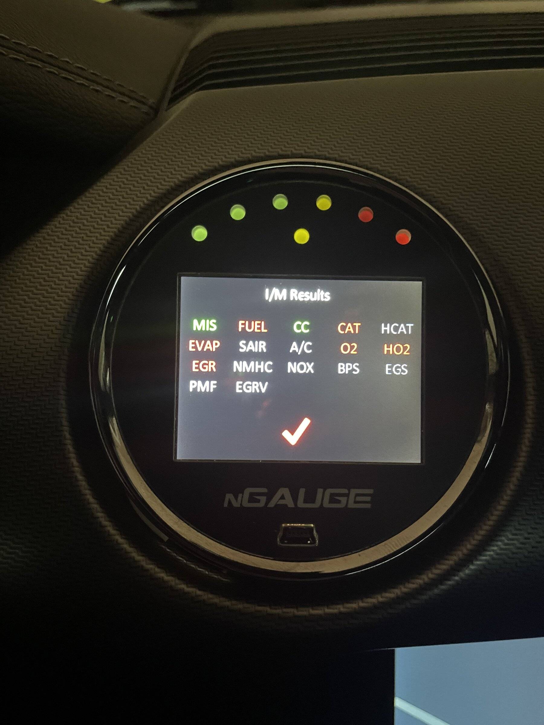

Will these settings pass Texas emissions? I just uploaded a new tune from Lund. I have long tubes with cats and VMP Odin supercharger. I passed last year by going back to stock tune, obviously not an option this time around.

LOL not even close.

Not in California they don't, I can only speak for California emission laws which are draconian. However, I am aware that depending on which county you are from in Texas dictates the laws, am I correct with that? I would do a little research online before getting flagged.
As far as getting the readiness codes to go green, make sure the Lund tune installed allows the readiness codes to go green. If it omits the rear 02 sensors you will never go green. If the Lund tune still has all the emissions parameters in it you will probably have to run spacers on the 02 sensors. The EVAP, GAS and EGR would go green, its just the CATS and the 02 sensors. Hell in Cali you wouldn't get past the blower unless it had a CARB EO#

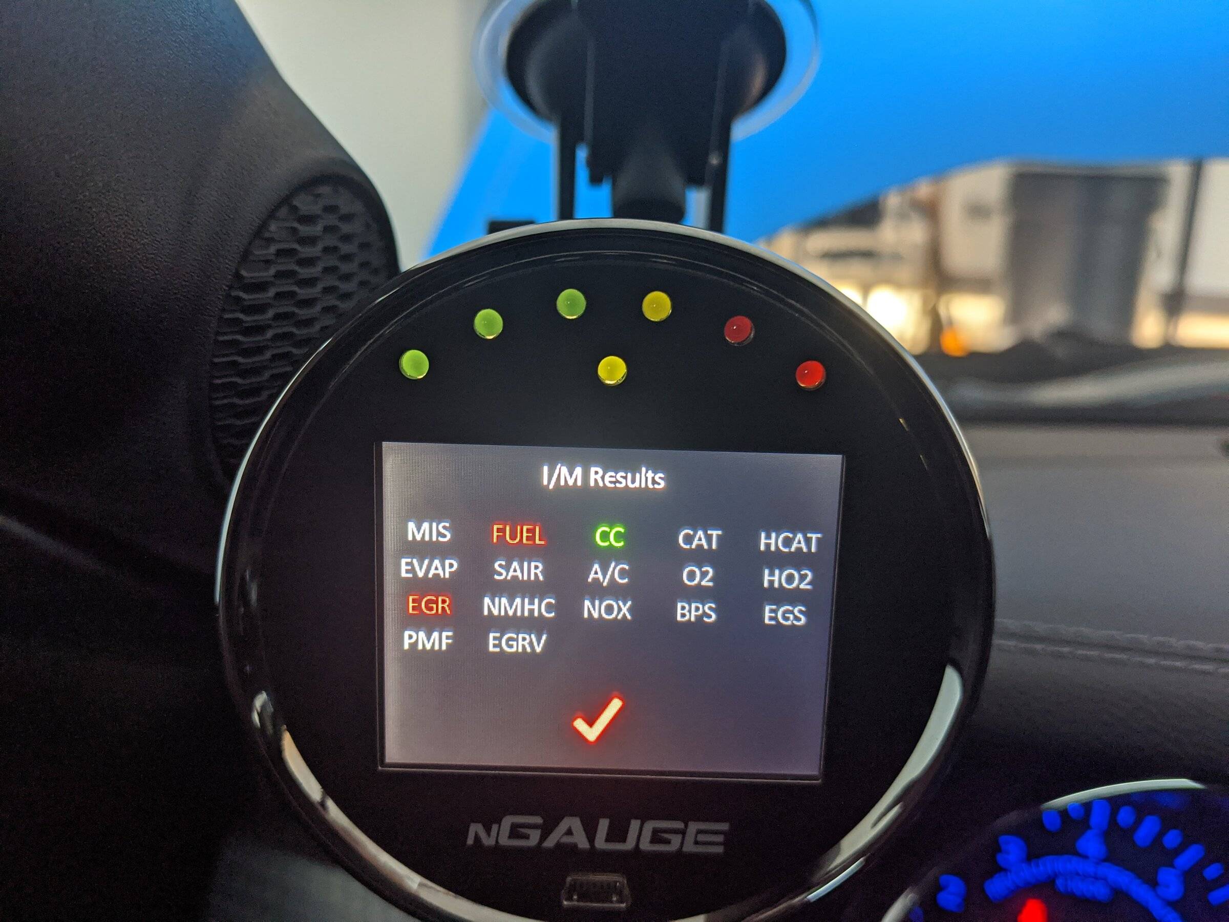

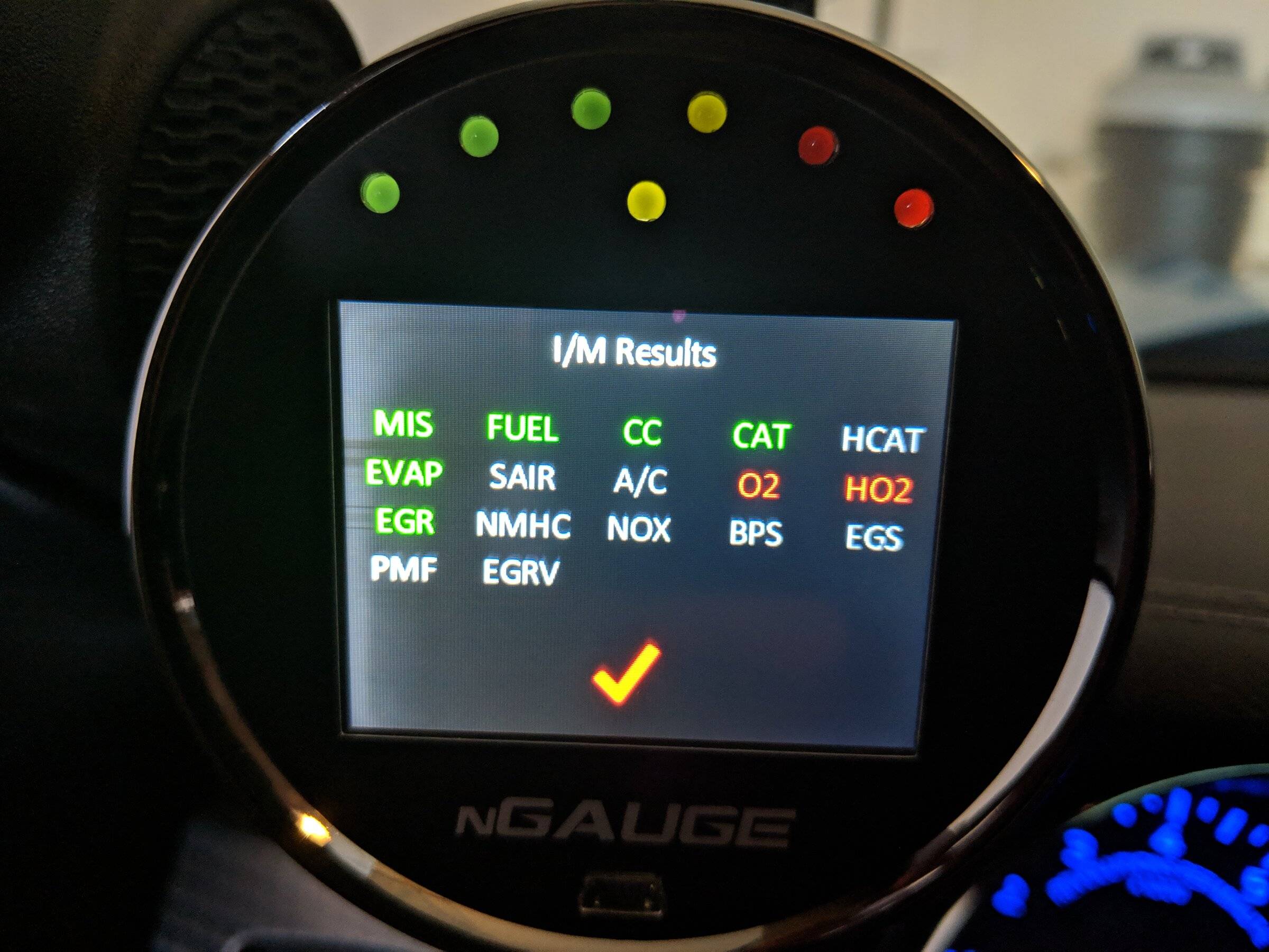

Here, maybe this will help you. This is how mine always ended up no matter how what I did.
Here is what it looks like with O2's off and why the EPA gets all pissy. Counts as 1 not ready once fuel goes green which doesn't take long at all. EGR takes a few miles. This shows as N/A on the test which is not the same as Not Ready and you pass.
