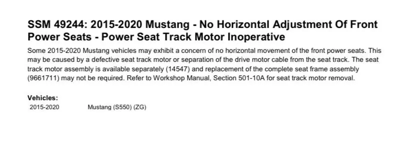

If the issue persists, this is the most recent SSM regarding the S550 electric seats:

Okay thanks. At some point I will probably have to go to the dealership, although I dread the thought of that. Only thing that confuses me is that the tilt motor is also inoperative.
