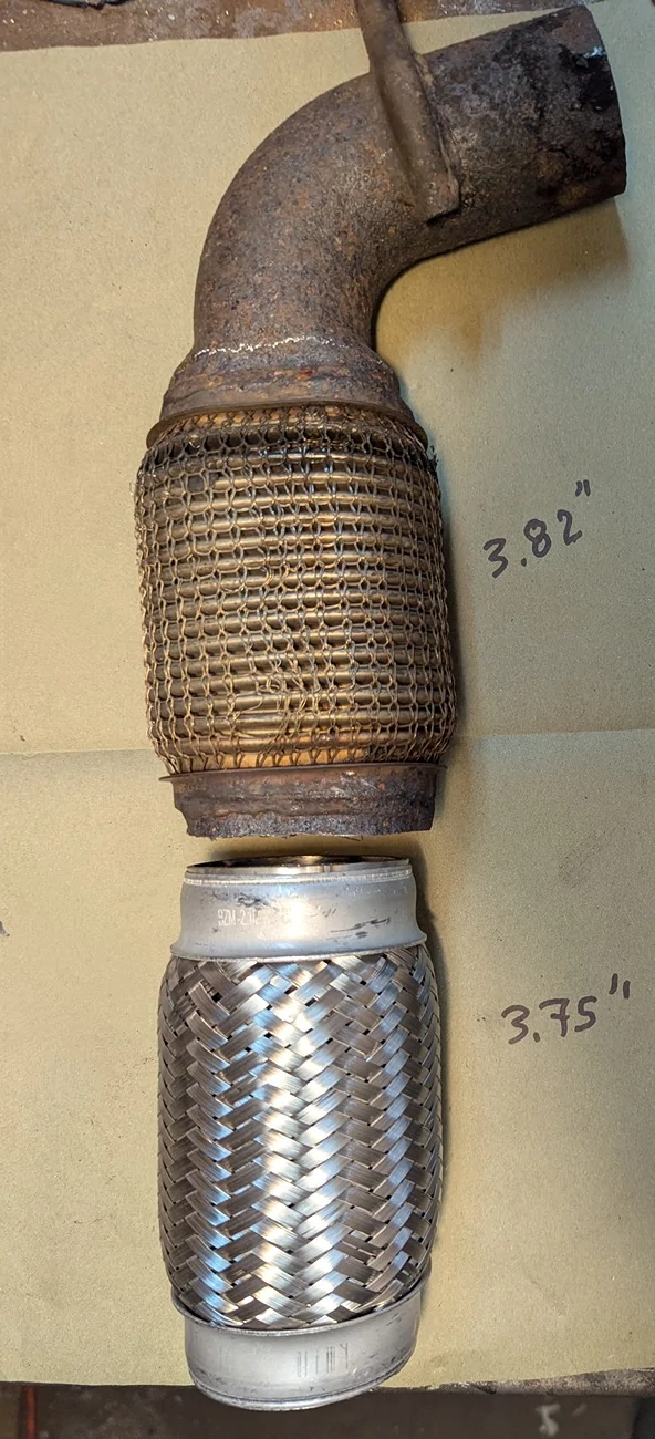

Had same problem. Needed to remove the exhaust to replace the cables. Both the band clamp and the oval flex coupler broke during the process. The band clamp ain't cheap but is available. The oval flex coupler is not available separately so I welded a round flex coupler in in its place.
