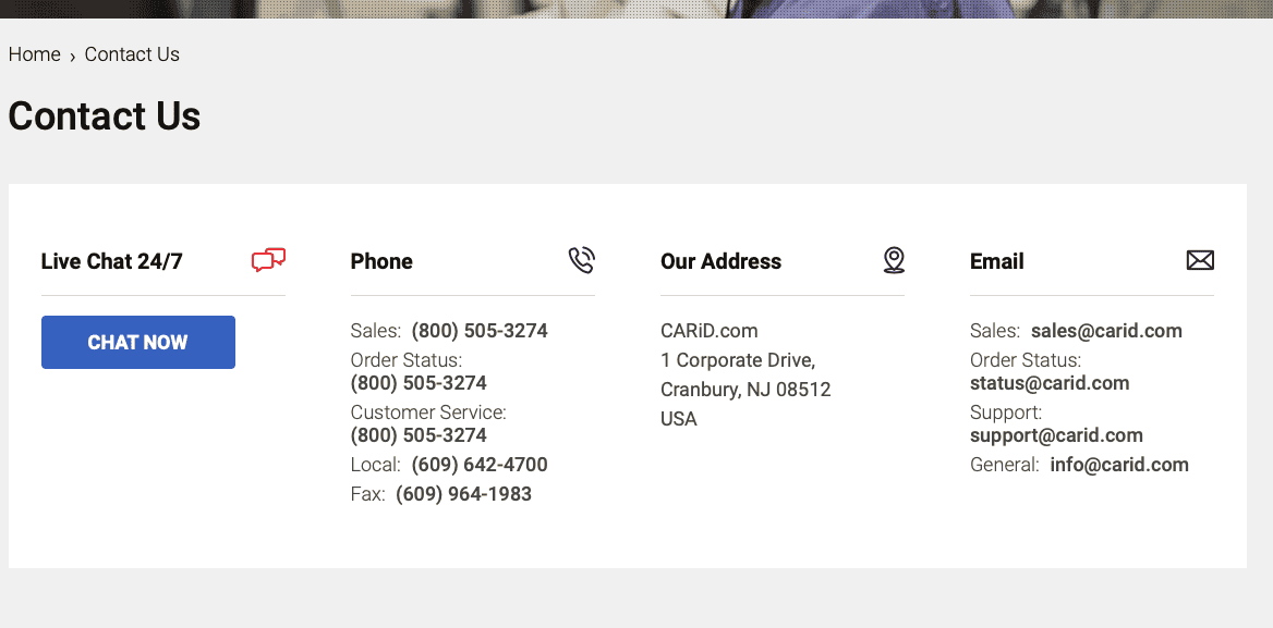

LED, game changer, I would try contacting Ford, sorry I could not be of help. What about turn signals in general. What do they expect someone to do for signals if the manufactures offer the amber only. WTF ?

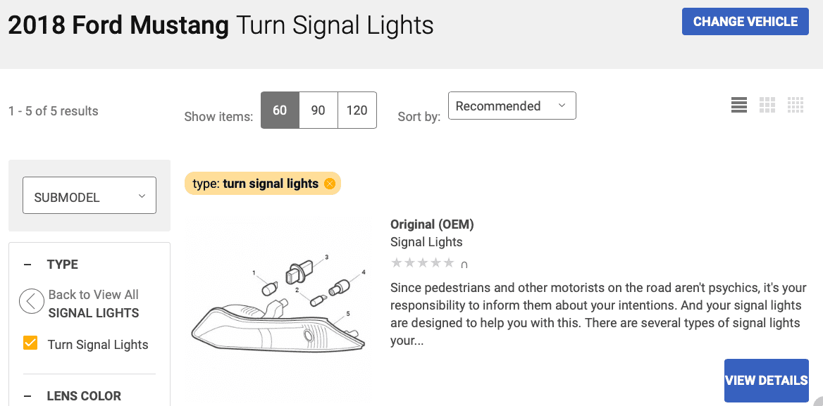

V. VVVVVVV
This suggest, the the LED might be replaceable ?
https://www.carid.com/2018-ford-mustang-turn-signal-lights/
What the heck got nothing to loose ?

The turn signals are no issue, they are allowed to be amber. The way I understand it, no other amber lights (besides turn signals) are allowed.
I looked at the link you sent me. While it looks like the bulbs can be replaced at first, once you select ‘view details’, it shows you a diffferent light unit without any bulbs.
I just checked at my vehicle. There is only one connector to each lamp unit with 5 different wires. I’m planning to de-pin the wires one by one to see which one is for the parking lights and leave that one disconnected. Still I prefer to disable them through Forscan, but I think this is the next best thing until I obtain the coding.
