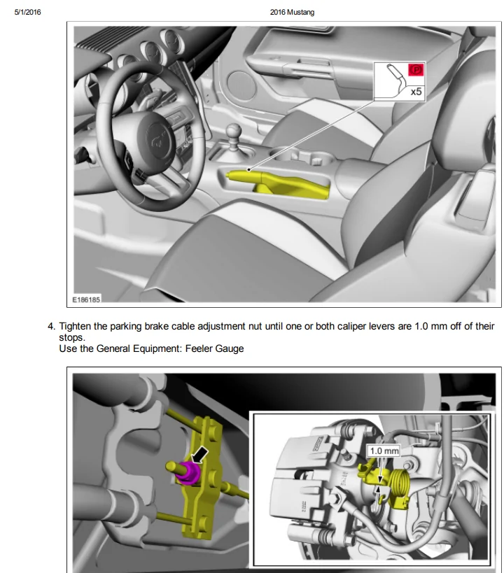

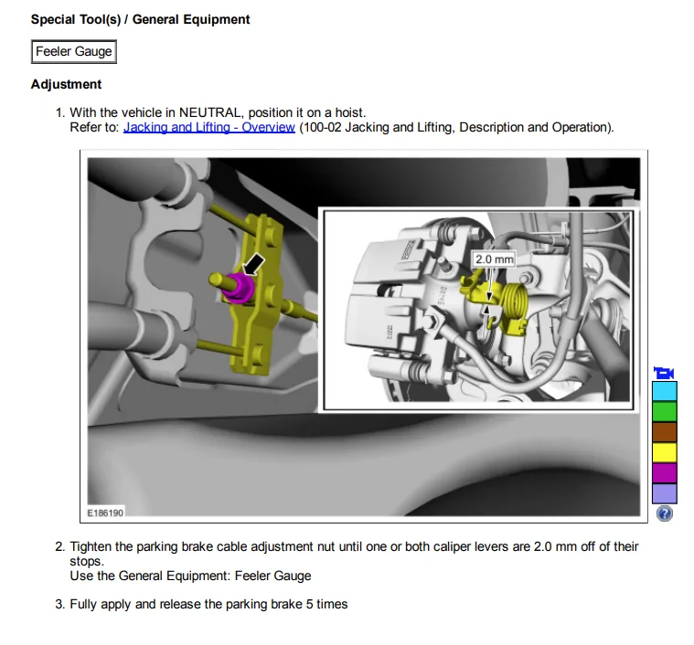

Yea, its in the caliper, but if you overtighten the cable it can hit physical stops before the self adjusting mechanism can engage, so try loosening the cable a bit first, and then cranking the handle a few times, then readjust the cable but not too much. There seem to be measurements for how many mm loose if you search.
The cable adjustment is for if the cable itself stretches but the self adjustment (which compensates for pad wear) is on the caliper.
