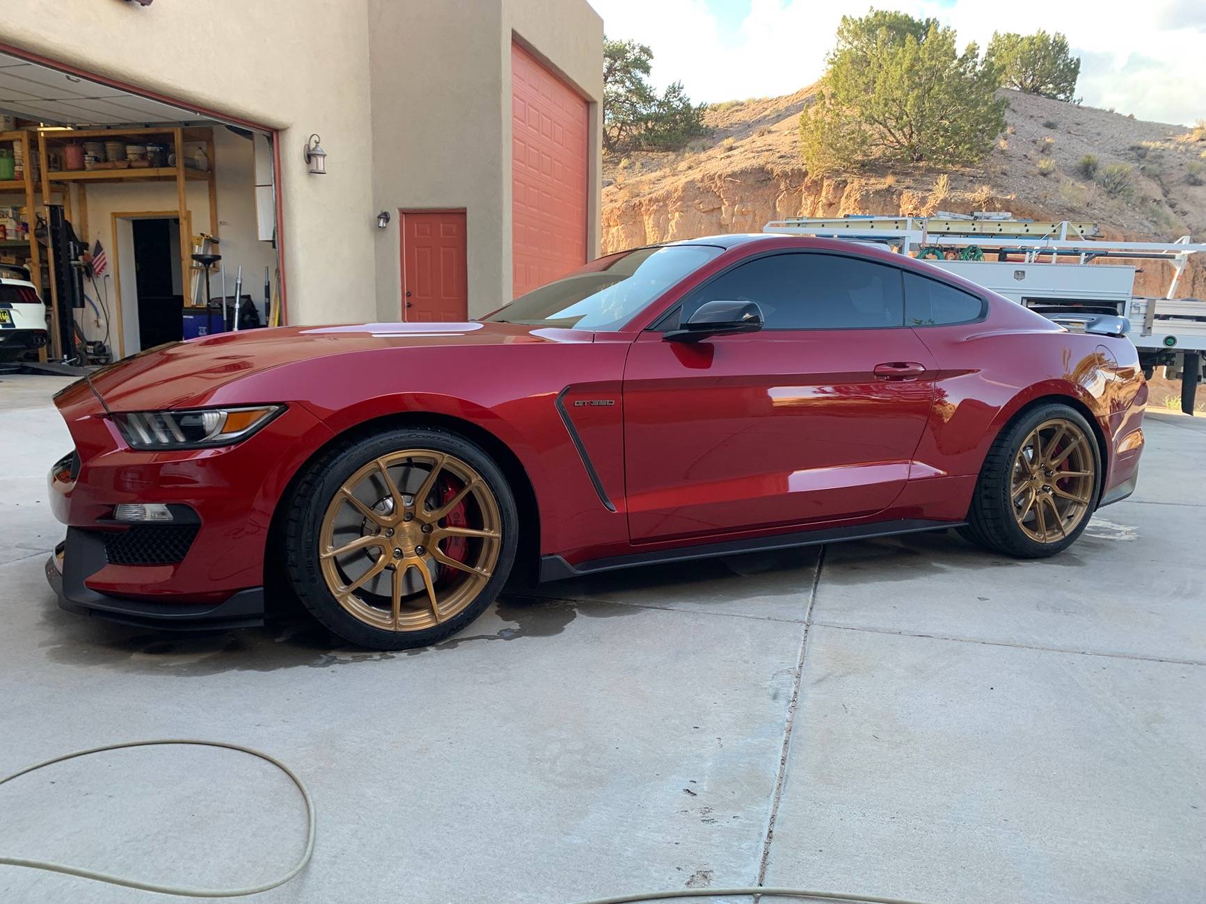

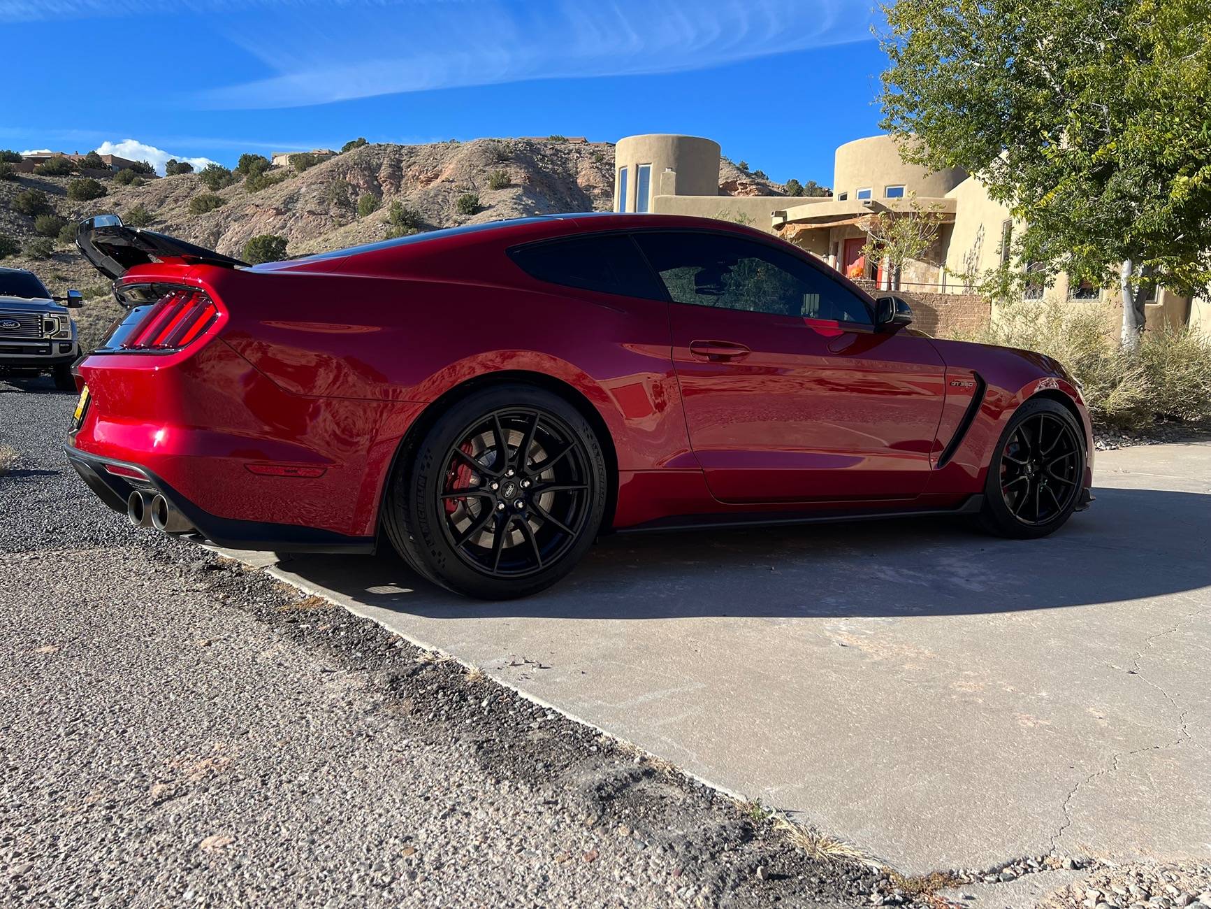

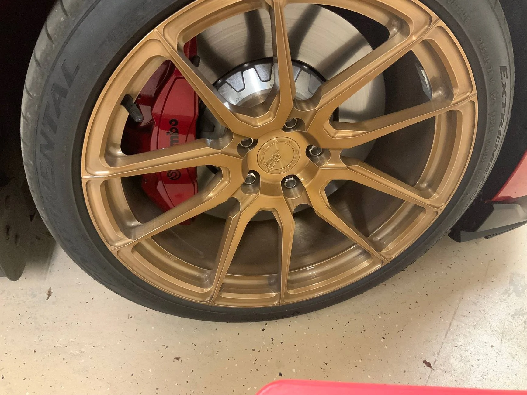

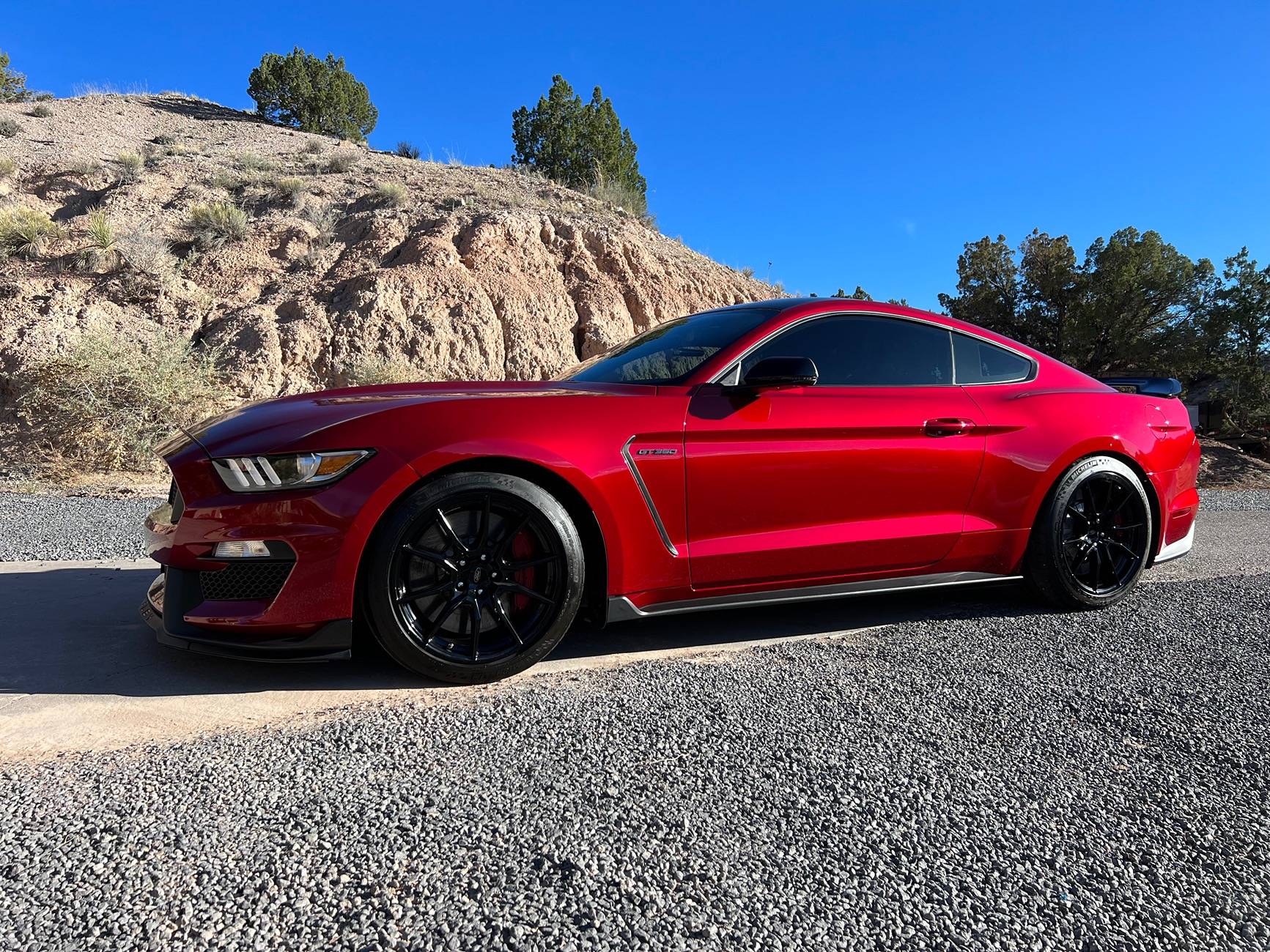

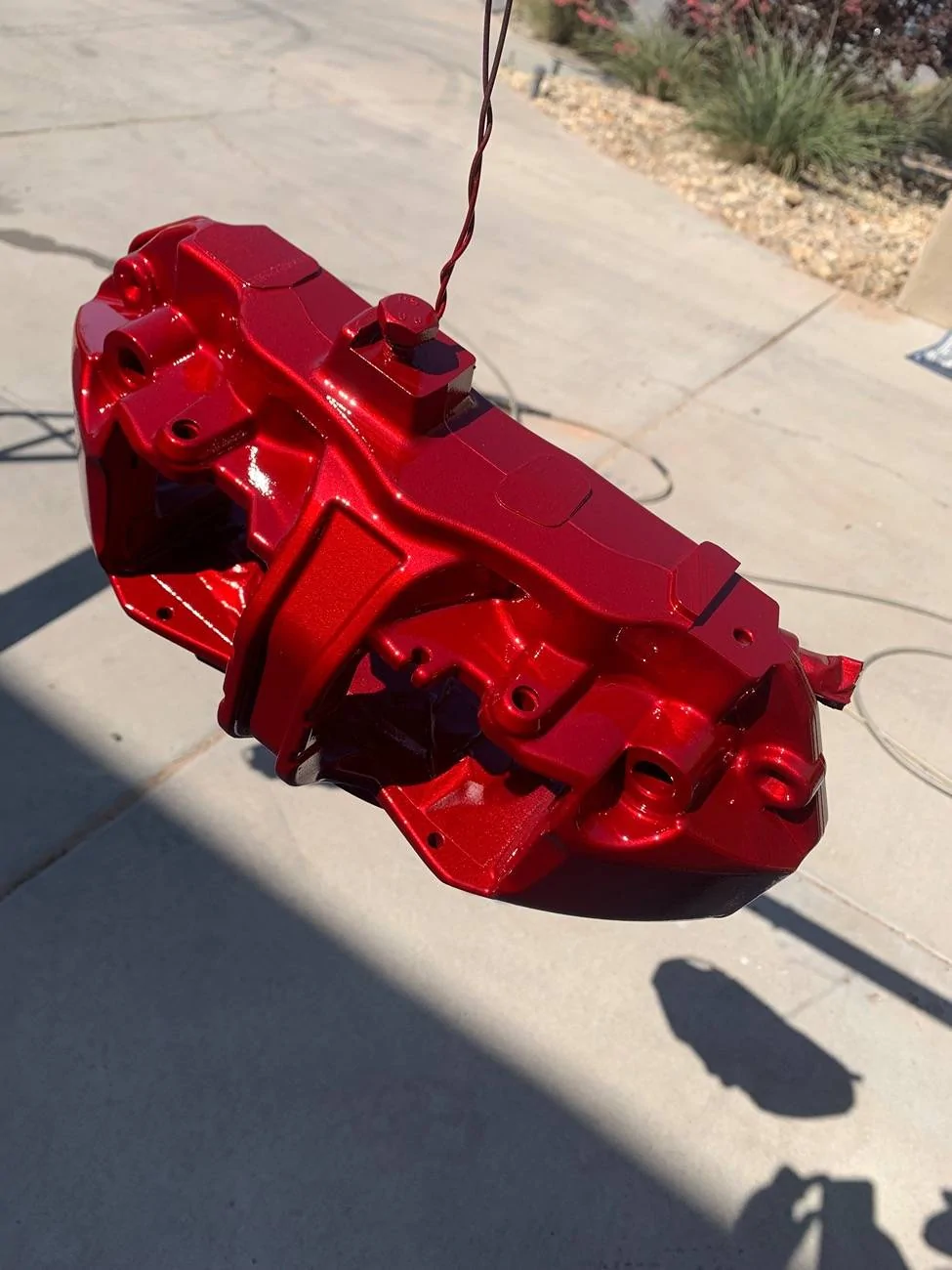

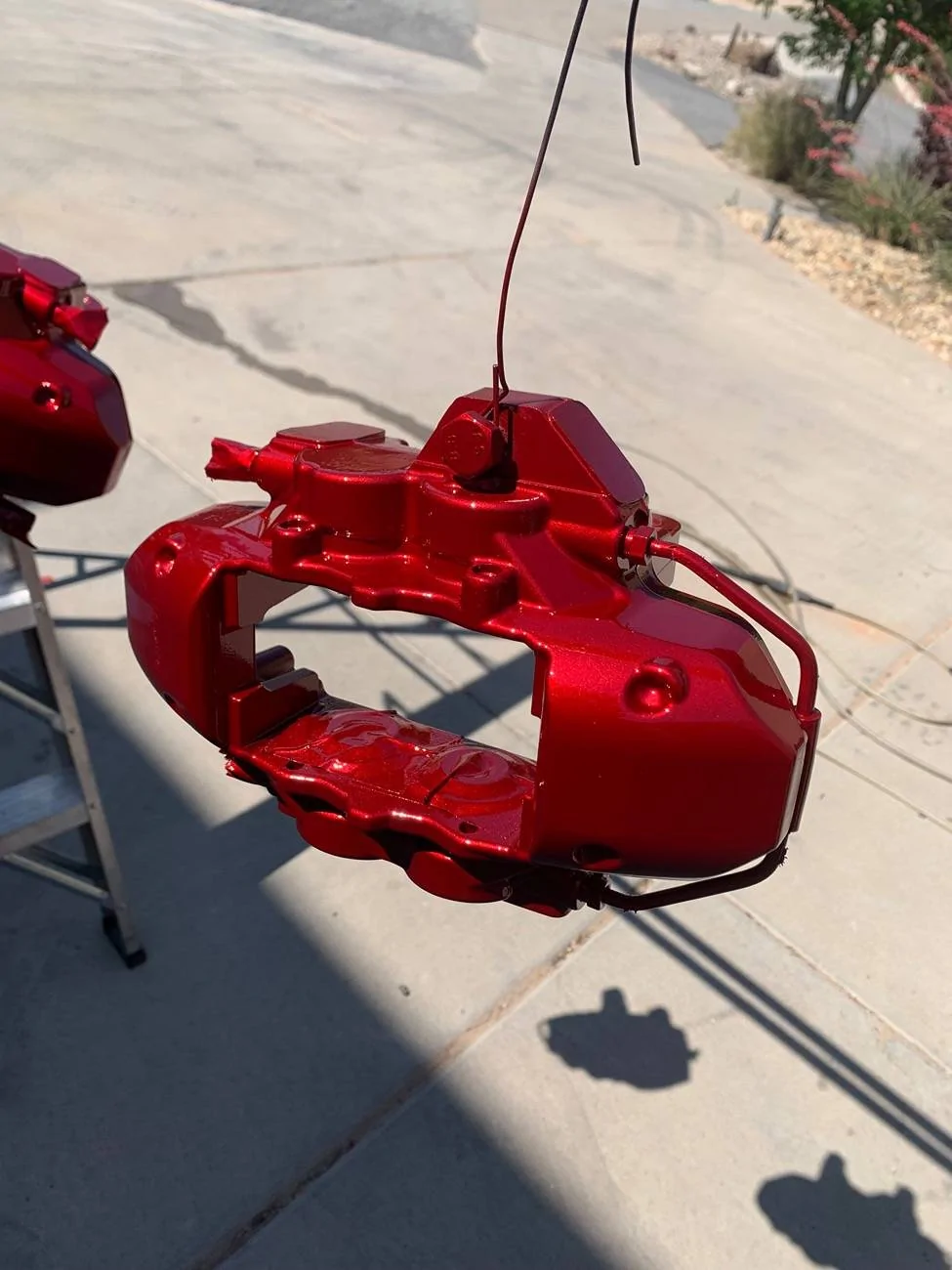

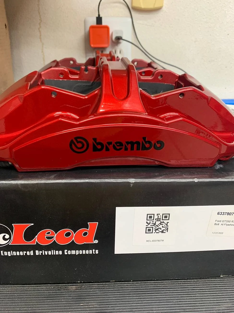

It really depends on how nice you want them to look. Me personally I wouldn’t paint over what’s there. But to be honest I’m an old paint and body guy. I’d pull them off the car to to paint them but even if you didn’t it can be done without a lot of hassle on the car. I’d hit them with air craft stripper and then rinse all the old material off. Literally takes less then a half hour. Then do the paint process, whichever you choose. G2 is ok, but I used a quality 2k sealer, then base, mid coat, and clear. Automotive. Decals on after the base/mid and under the clear. There is a big difference in the appearance. But once again, it’s how picky you are. Me, admittadly, I’m a picky … . Here’s some pics with aftermarket wheels and oem before I sold the car. Sorry for the duplicate, not sure why it did that.
I tip my hat to you Sir, that is one finely painted caliper.
