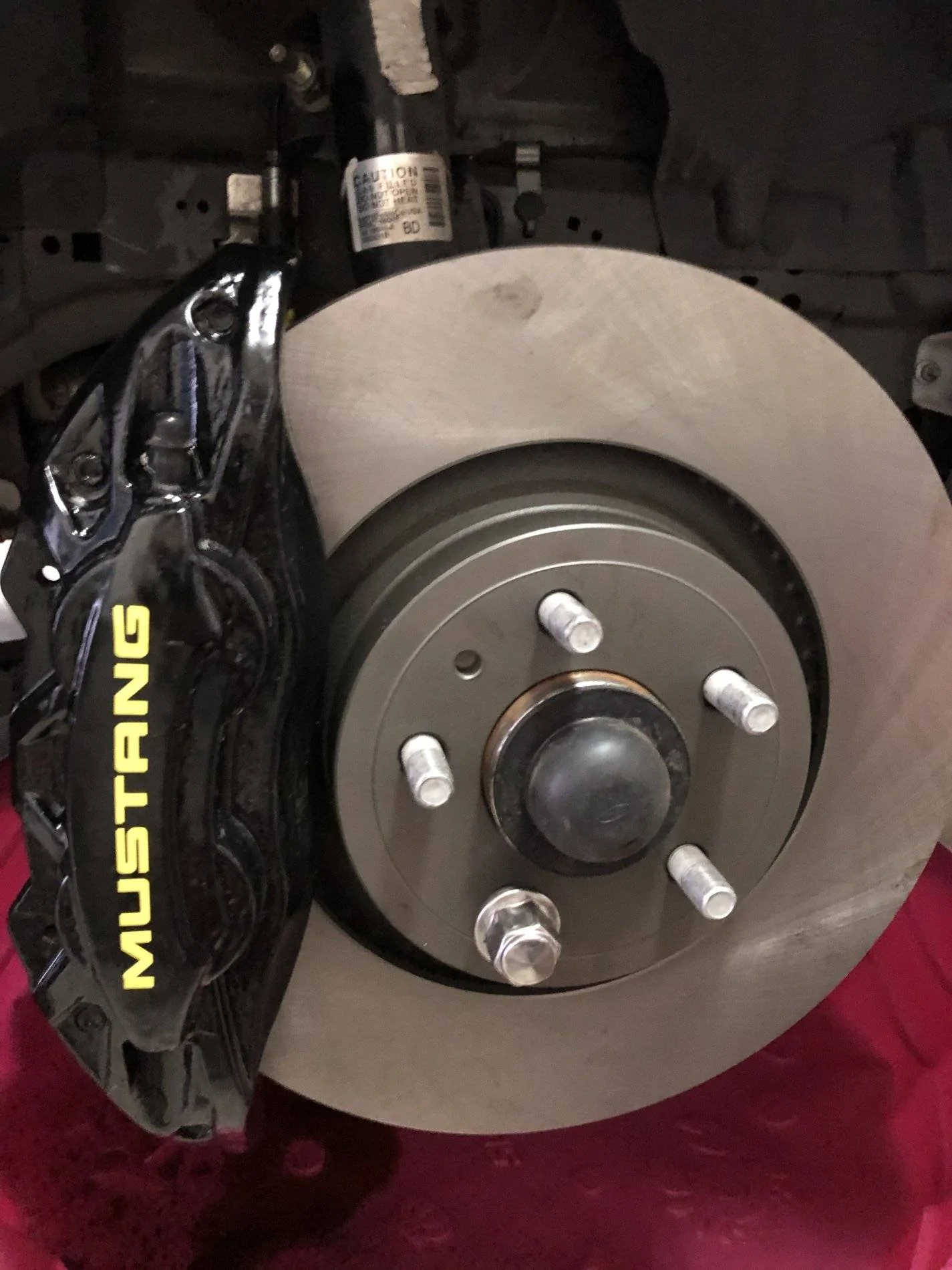

I will probably paint all 4 tomorrow. They are super clean, do you guys paint the entire back side of the front calipers where you can’t see too? Or just the front

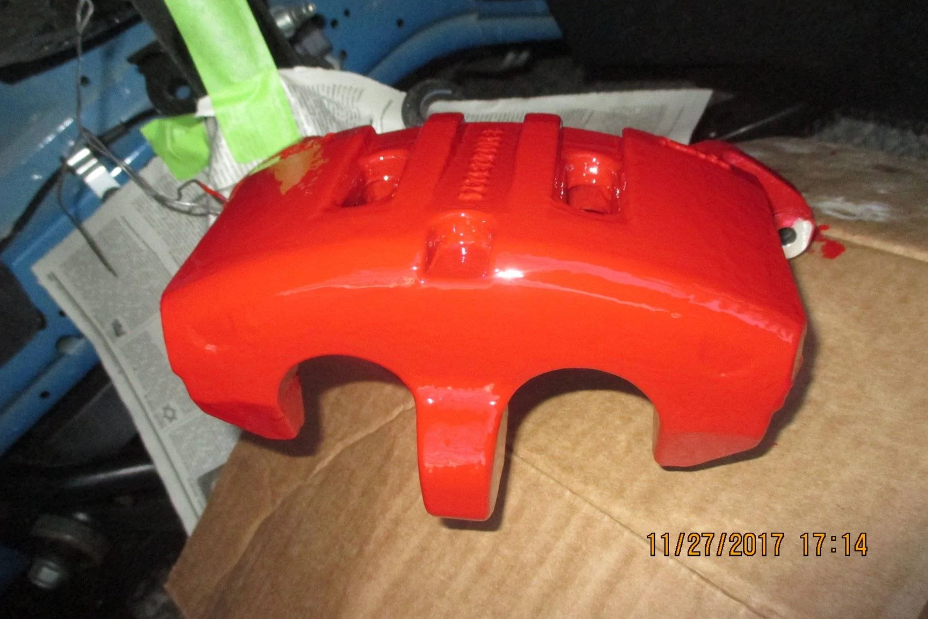

I just painted what you could see. I didn't prep and paint the back side of the Brembos because I wanted as much paint as possible for the front sides and the rear caliper/brackets.

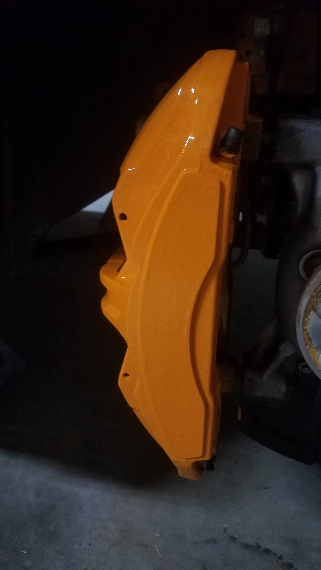

I used Duplicolor ceramic brush on coating on mine. Holds up excellent! Hasn't chipped or had issues for 2 years now. Prep, getting things clean and degreased is the biggest part of a successful job.

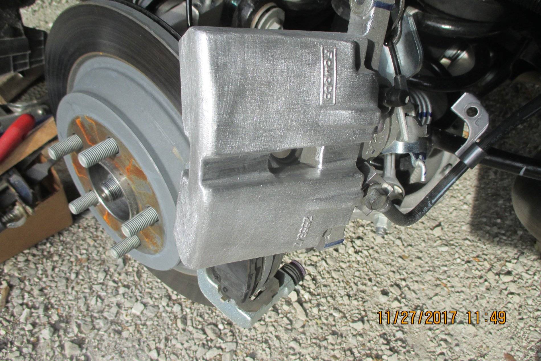

The rear calipers are a rough cast aluminum. If you don't paint them, they will eventually look like dog shit. Especially on a daily driver and even worse when winter driven. As the aluminum starts to oxidize it will turn dark, then will take on the color of rust and dust from the pads and rotors as it bonds with the aluminum oxide. No cleaner will remove it.
If you really want to do a nice job on the rears, take them off the car and sand them smooth to remove the casting lines, then clean and apply the paint color you like.

Not enough to do the back side of the Brembos if I did as many coats as the rest. But, I likely put on more coats than needed so, that's probably not much help for you.

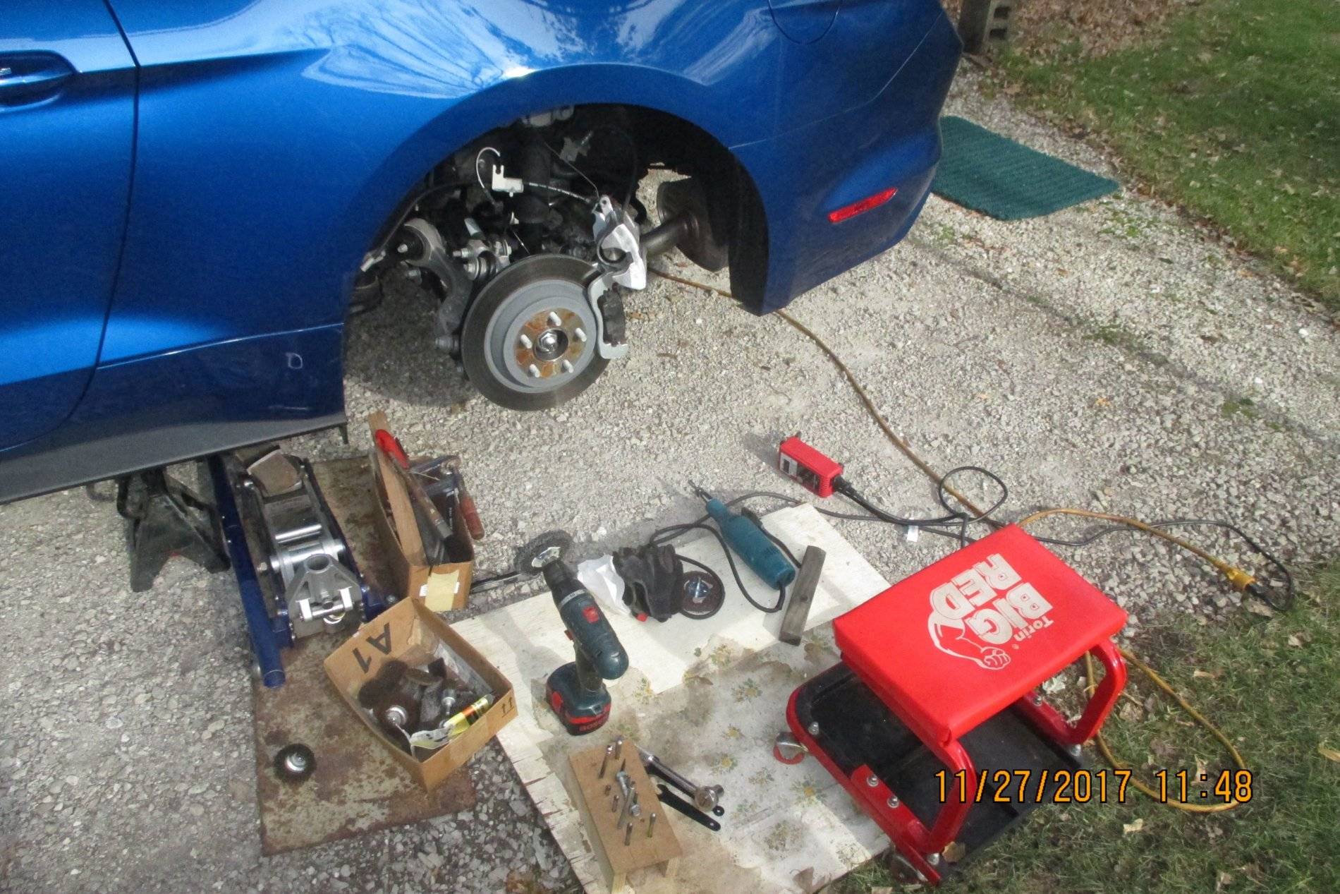

File, grind, sand, and brush on Duplicolor....
In case I wanted to do that next time, that picture makes me think you did all that without removing them from the car. Is that right? And if so, did you post more about how you did it anywhere?

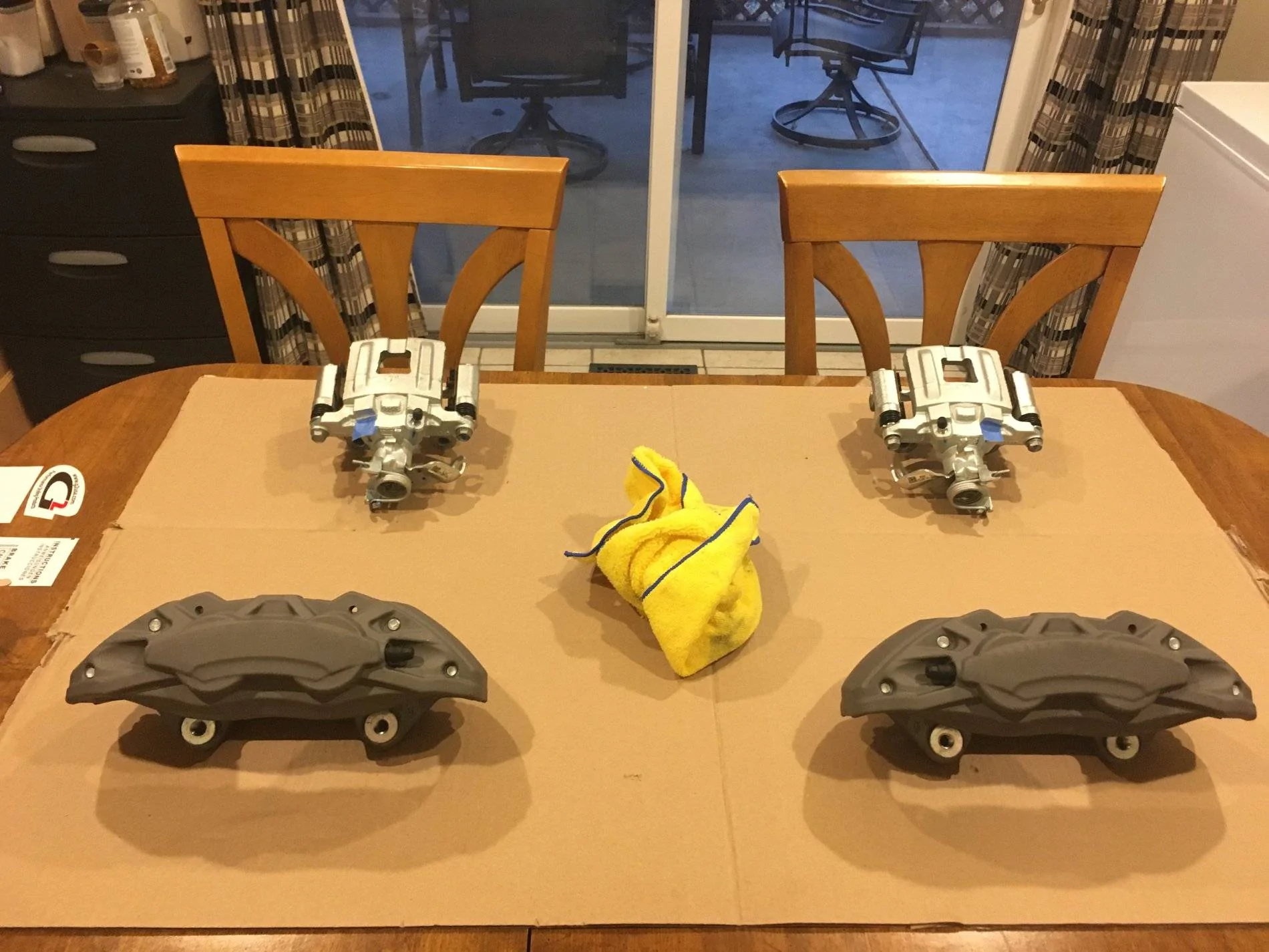

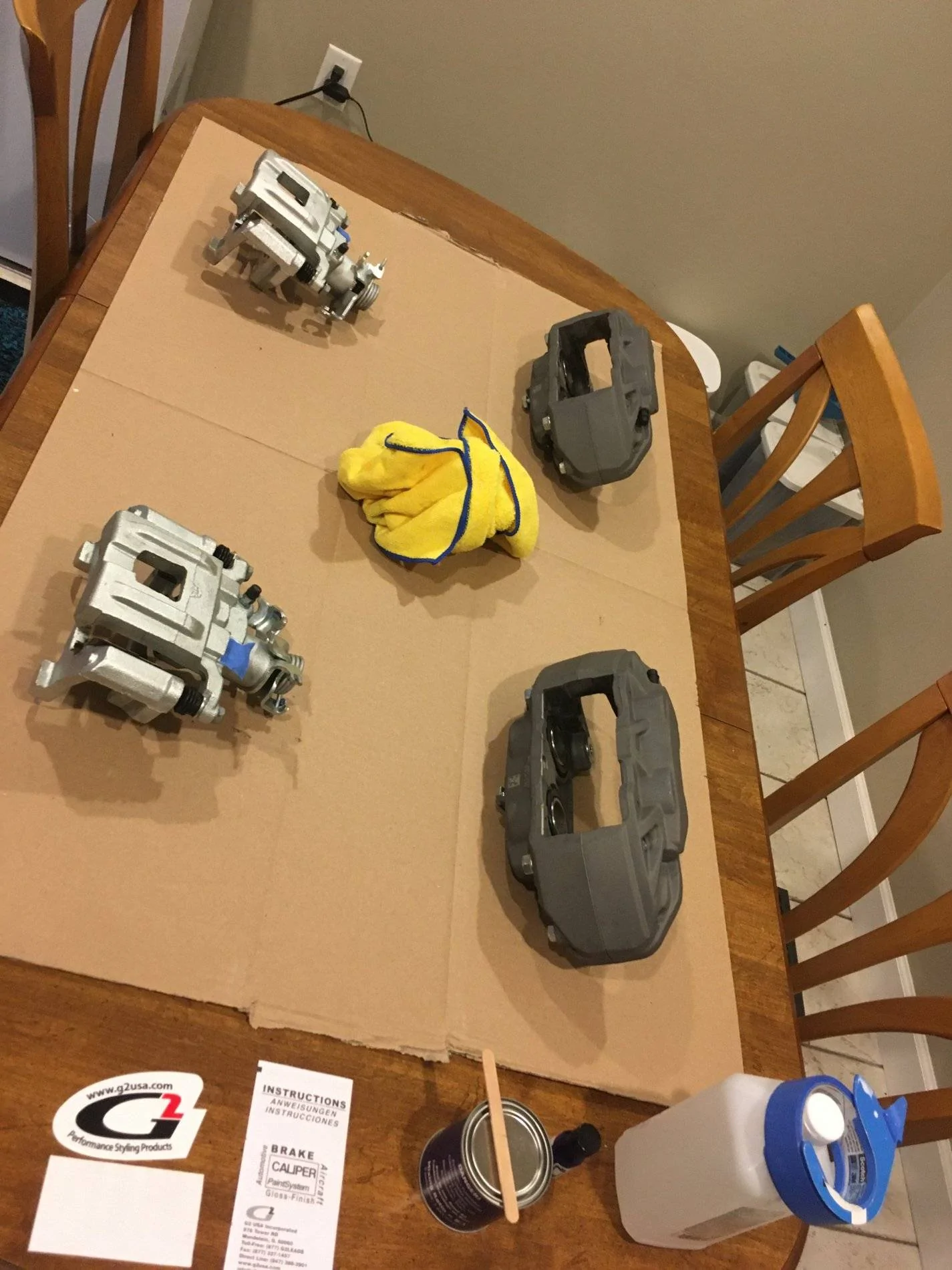

My kit arrived, I used a ton of brake cleaner on them, got them taken apart pulled the pads.
Letting the metal, and the containers of paint get to room temperature.
They are like 30* currently, so in another hour or two, I will be painting away.
gotta go to Lowe’s first get some brushes, I’m just gonna paint them, lol not feeling like sanding etc.
Think these look clean enough? They only had 1k miles on them before taken off. Barely anything came off.
Should I paint over the little silver pins or try and tape them off?
I could see that being hard to make perfect
