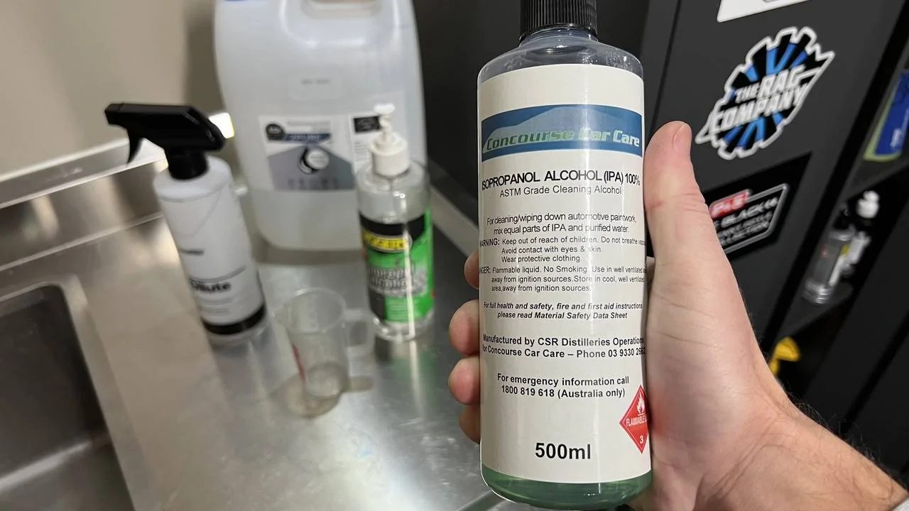

My introduction to this space was via Waxit with their Concourse Car Care branded bottle of IPA, which was then further diluted. I can’t remember when or where I learned about Carpro Eraser, but that was my first step beyond blended IPA, followed by Gyeon Prep and NV Clarity.

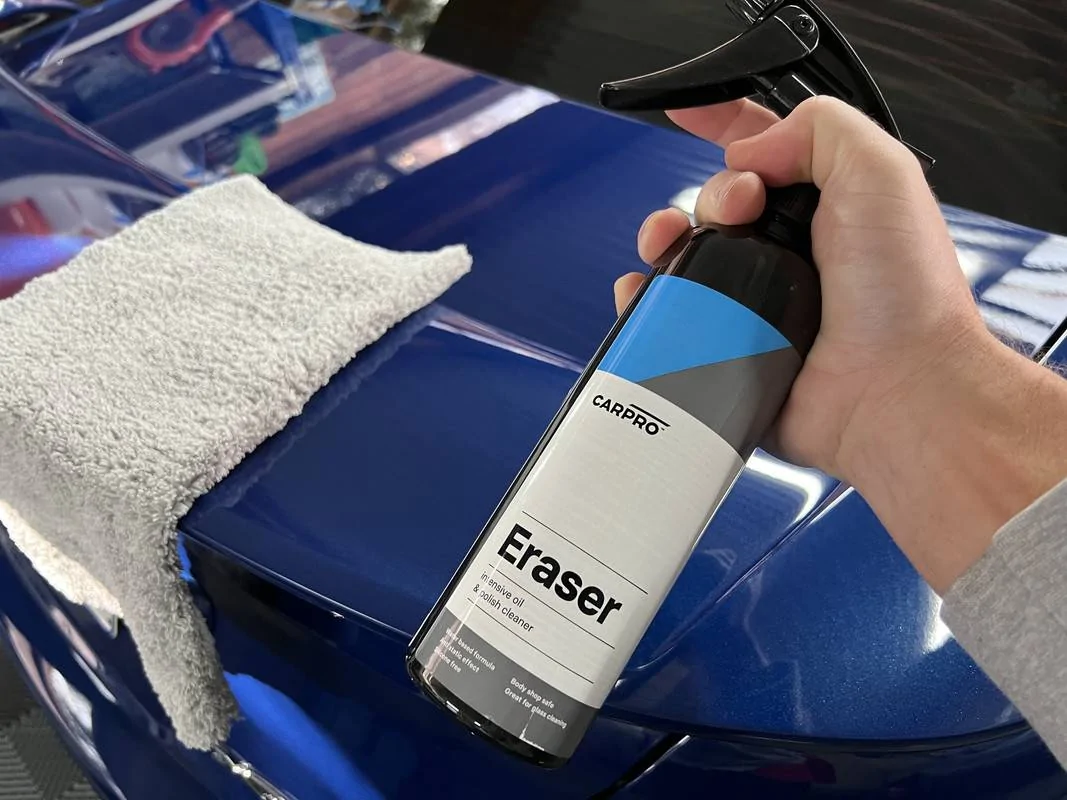

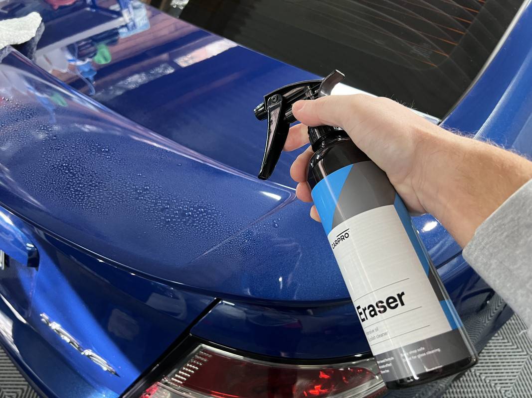

Carpro Eraser -
This is a product I have been using for several years now, and frankly, my benchmark. Although hard to describe, the scent of this product is heavenly, you could get high on this stuff and there are detailers who use Eraser for the scent alone.
The key to Eraser is the ability to lift, break down and then remove oils from the paint surface, but also provide lubrication and anti-static properties in the process. Not all prep sprays do that, and it’s the lubrication aspect that is why I continue to have this product on hand.
In use, Eraser is all about the user experience. The lubrication provided makes it less grabby and the scent makes it very pleasant to use. The evaporation rate is controlled and streak free.

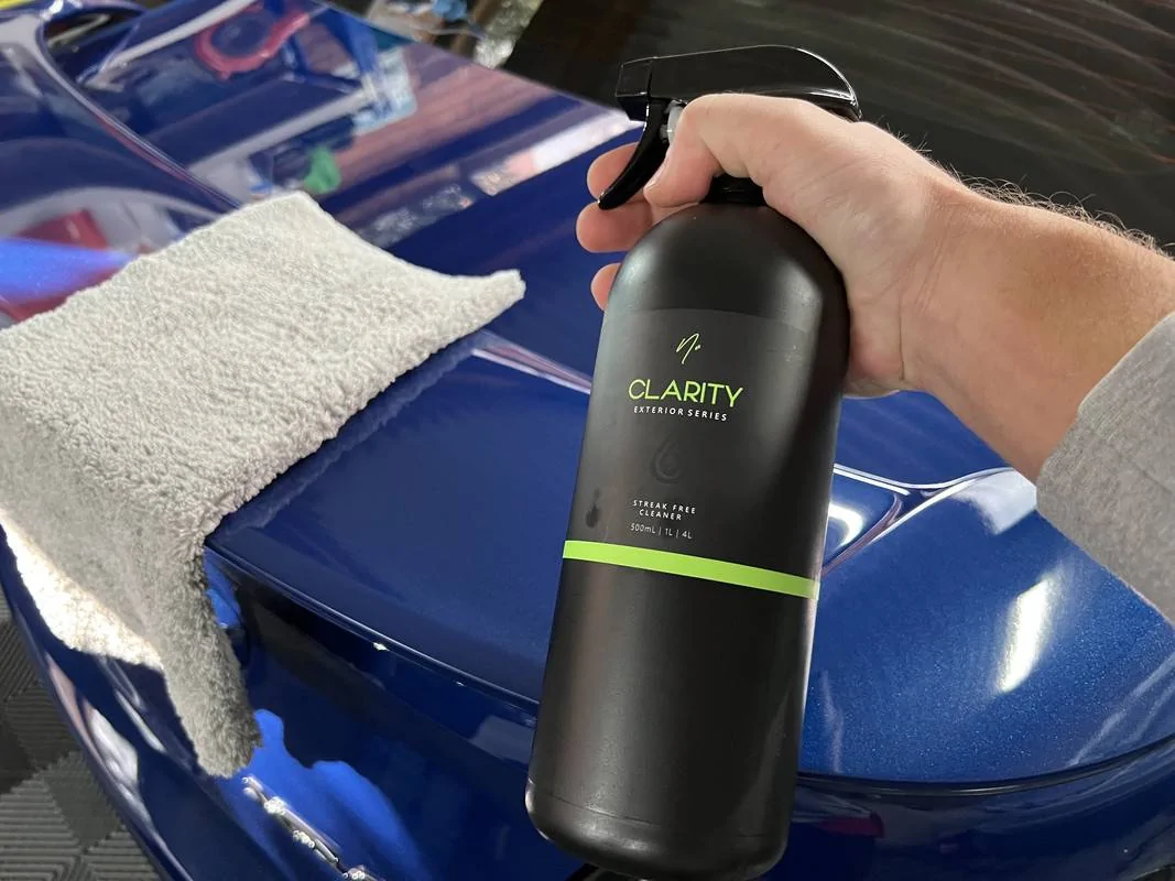

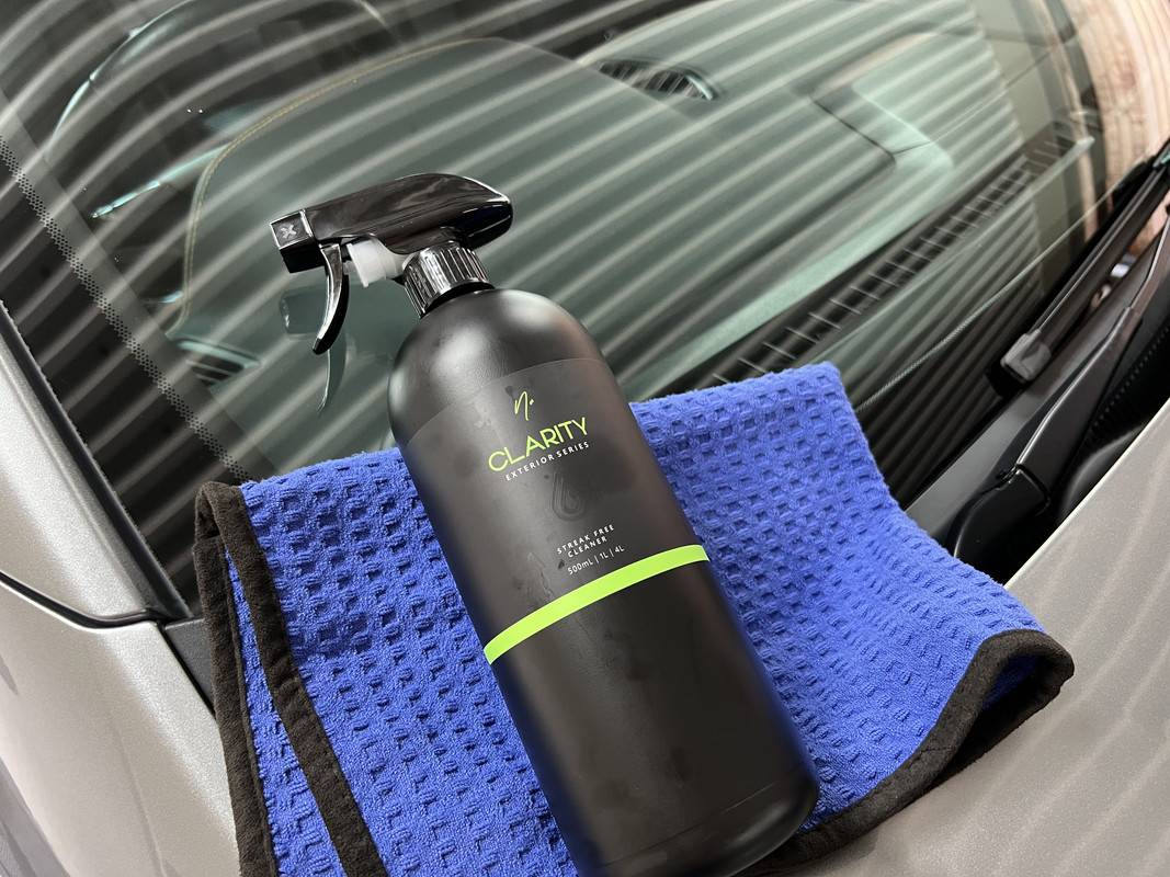

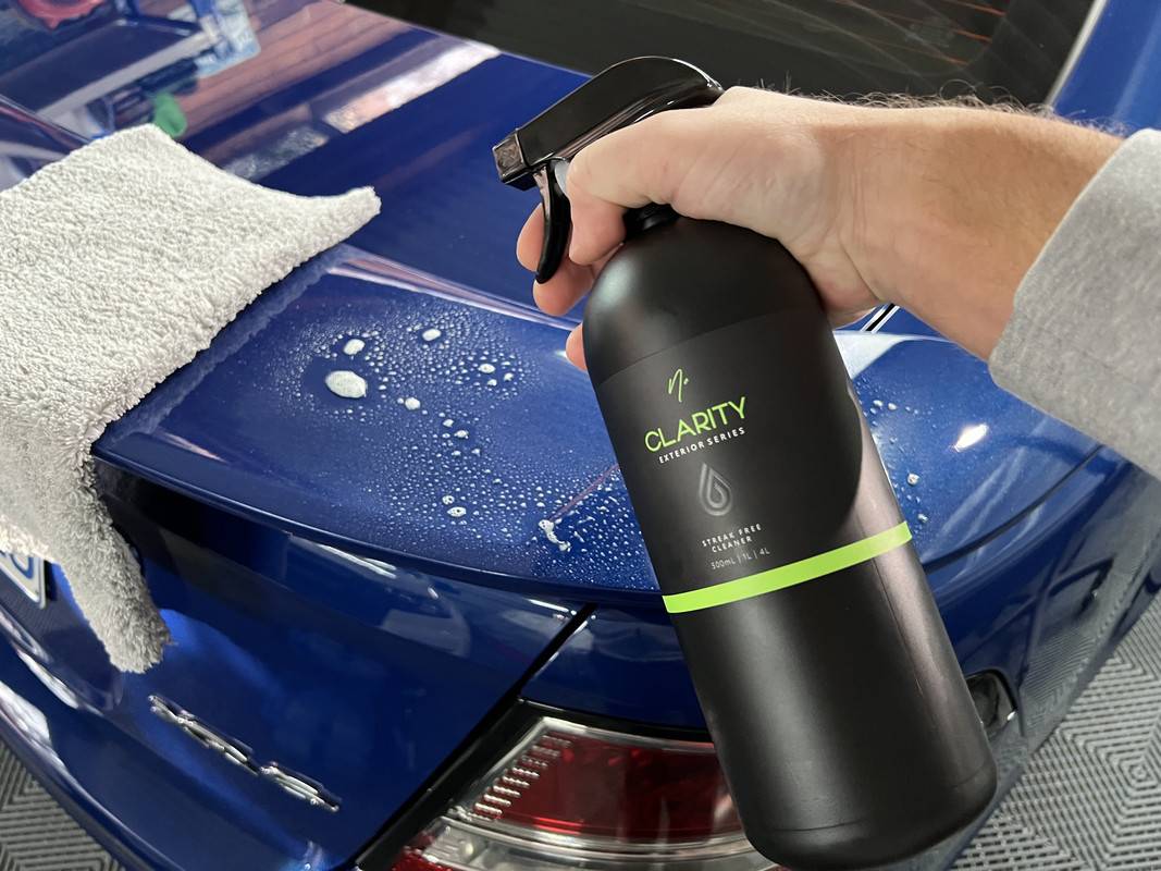

NV Clarity –
I’m going to get straight to the point here, I hate this product. As a glass cleaner, it’s pretty good. But as a prep spray, its extremely grabby. While NV do make similar claims of lifting, breaking down and then removing contamination, it just feels like straight IPA to me. Smells like it as well. No doubt Clarity is effective, but it just doesn’t have the lubrication of Eraser or Prep and the user experiences suffers as a result. Evaporation was slow in today’s conditions. It’s cheap though.

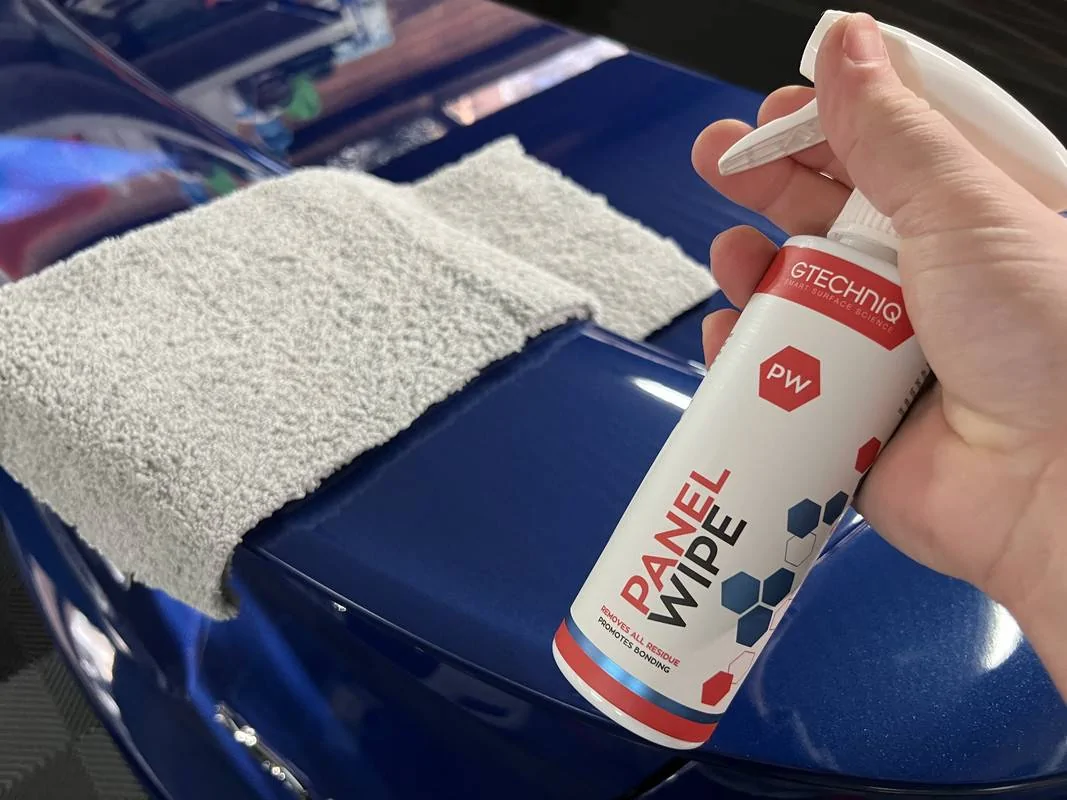

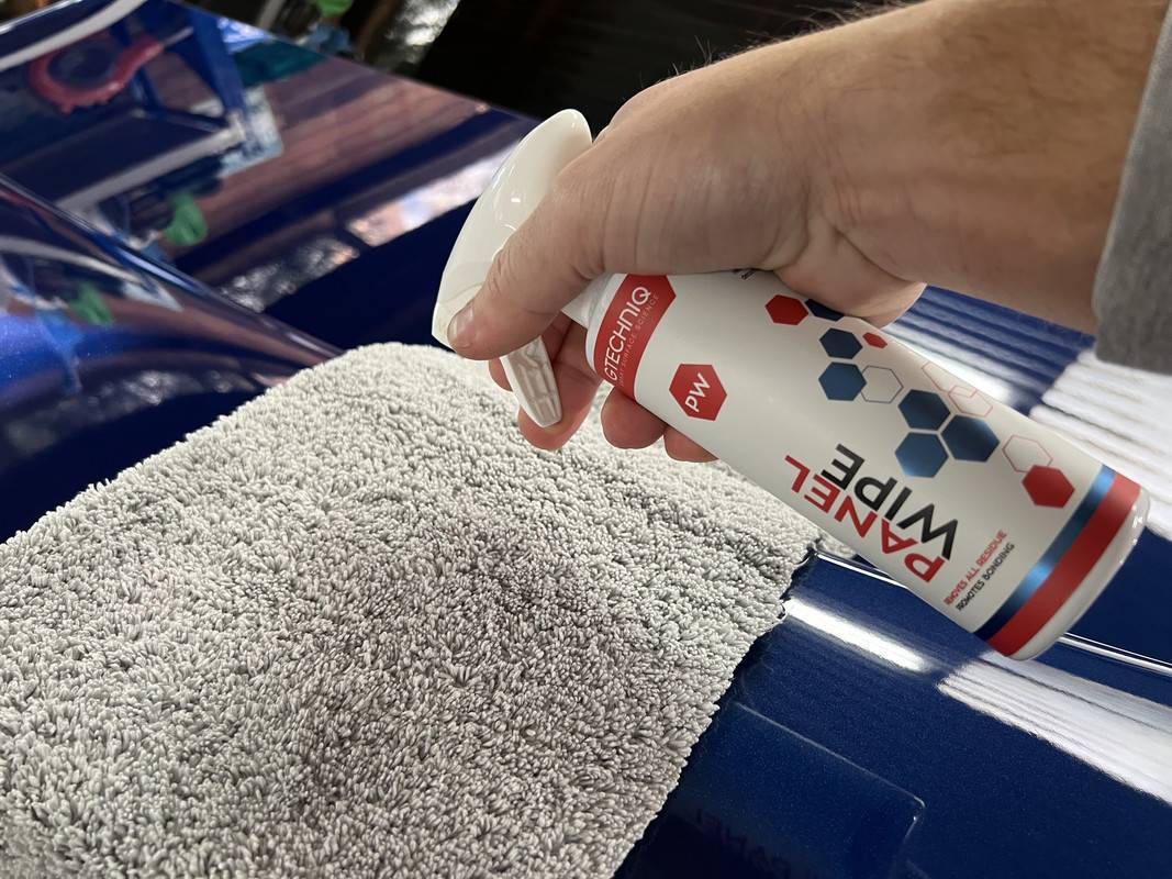

Gtechniq Panel Wipe –
This is one of the most aggressive prep sprays on the market, as a result, Gtechniq have a sterner list of recommendations for its usage. Gloves are a must, it should be used on a cool surface, must not be sprayed directly onto the paint and is not recommended for use on repainted surfaces. Its also not suitable for use on PPF, vinyl, plastic or rubber. It should be used within two months of opening, so order the amount you need for the intended job. As a result, one would assume that Panel Wipe is going to be a very thorough prep for a ceramic coating.
Compared to the others, the application is different here due to the towel being an applicator rather than distributor. I thought Panel Wipe was going to be grabby, but I was pleasantly surprised with the feel, being smoother than expected. It evaporates evenly too. The scent is the most IPA like, being quite pungent. Overall, I liked this product more than I thought I would.

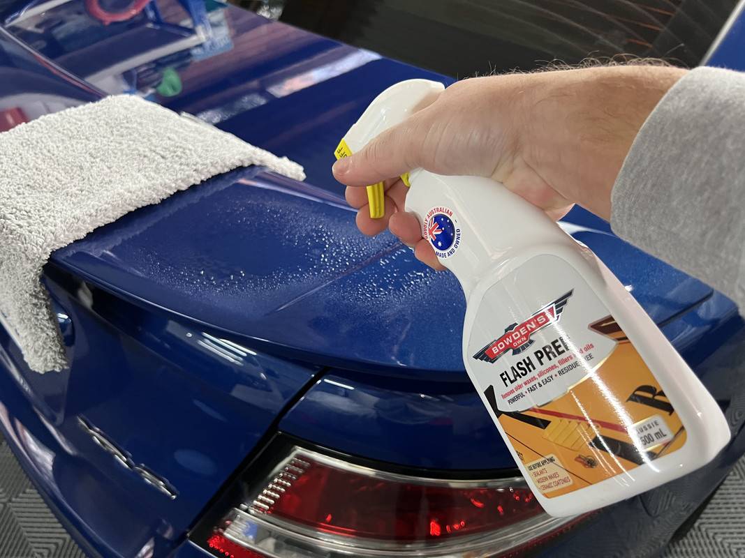

Bowden’s Own Flash Prep –
I decided to include this product in this comparison because, outside of Gyeon Prep or blending your own IPA solution, Flash Prep is the only product like this that is freely available through an automotive chain stores. Meguiar’s sell a product called M122 Surface Prep, but it’s only available in 3.8 Litre bottles and is a special-order item.
Flash Prep is said to be a pro-grade formula with “multiple types of alcohol to get a longer working time and better cleaning power”. Bowden’s also make mention of lubrication and anti-static properties, which is pleasing to see.
In use, this is the equal worst product here, sharing that dishonor with NV Clarity. It smells like nail varnish, is grabby and evaporates poorly. In a pinch this would be a fine, but it doesn’t impress. The overall score was balanced by the relatively competitive pricing in the smaller size bottles.

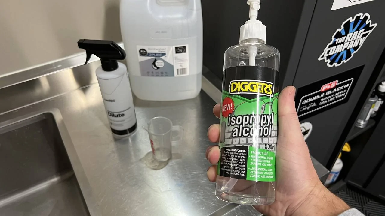

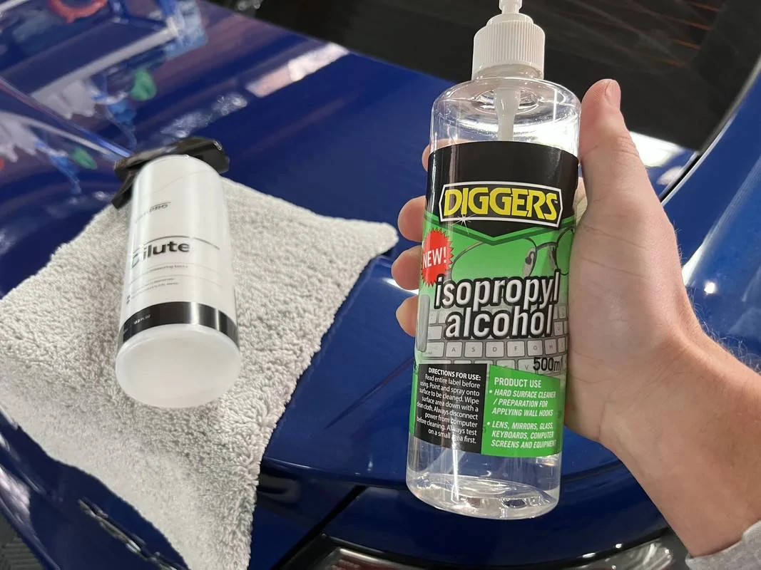

Blended IPA -
I decided to include this 50/50 mixture of IPA and demineralized water in this test for thoroughness. This is what many would have used prior to the advent of prep sprays, so it sort of needs to be covered.
This was actually nicer to use than expected. Naturally, its grabbier but not badly so, and the evaporation rate wasn’t as aggressive as I thought, at least in today's temperatures. I would actually favor this over Bowden’s Flash Prep. Overall, this is a two-part product that requires you to take the time to buy and mix two different liquids. How much of an inconvenience that is will obviously be subjective.
