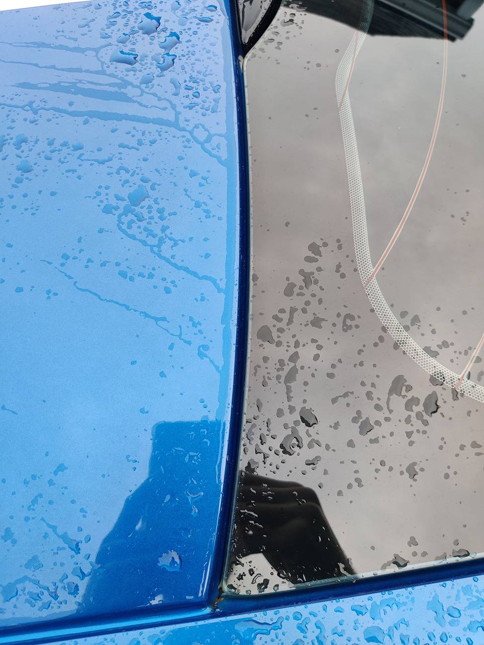

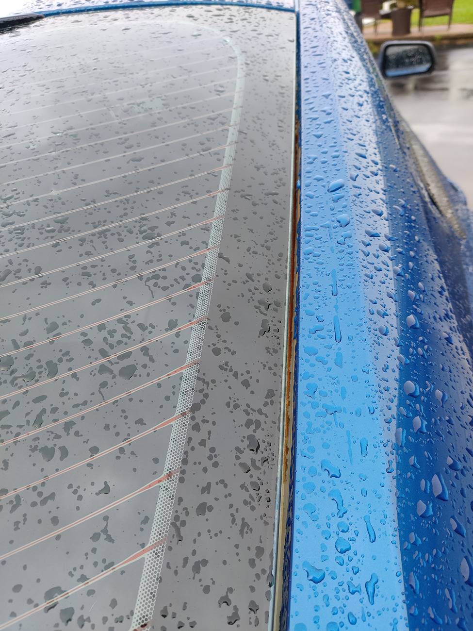

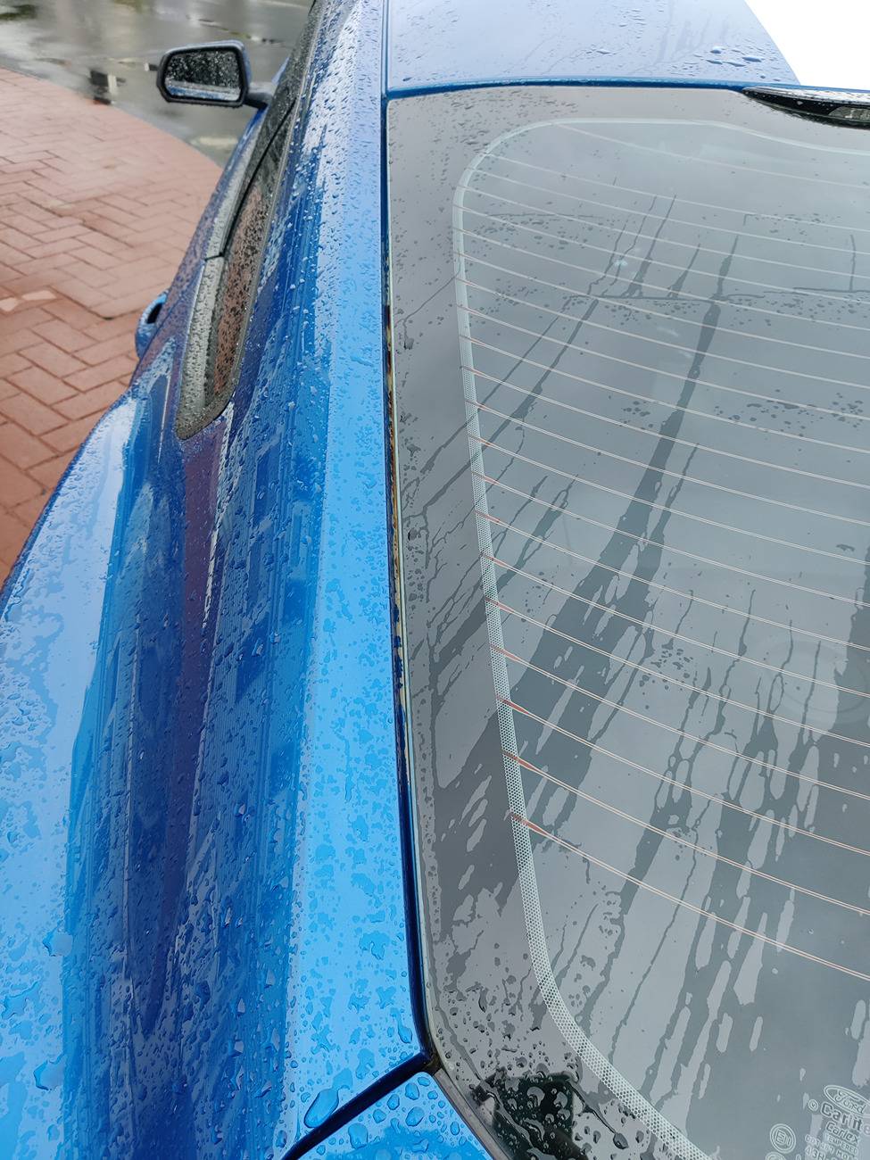

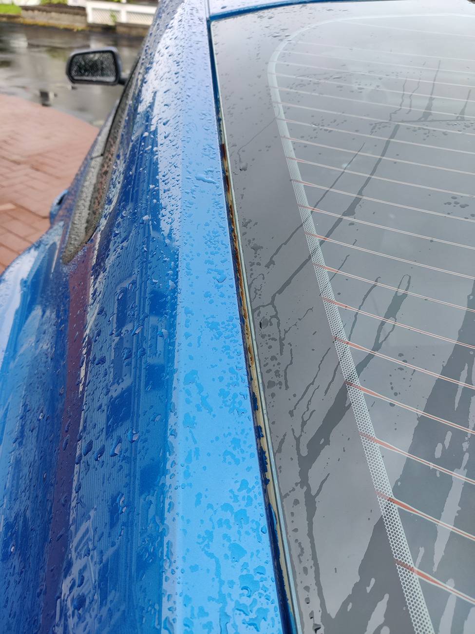

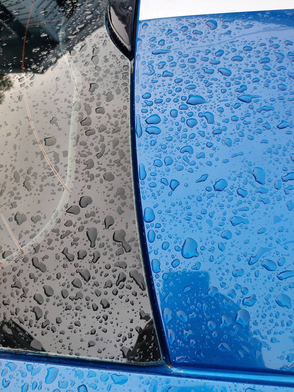

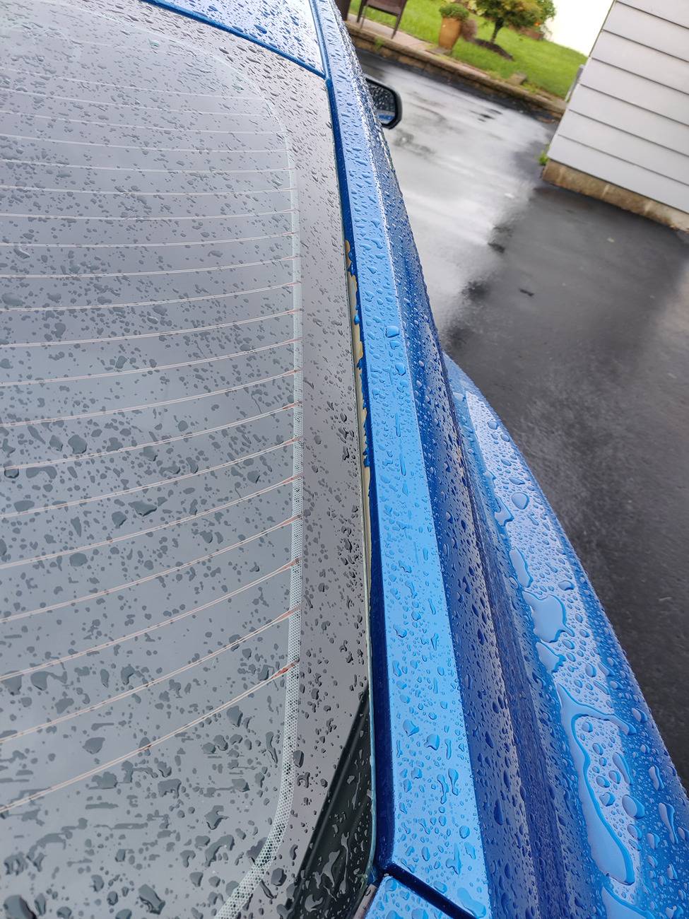

I know this is a common problem as I've seen a bunch of other threads. Mine had been slowly developing, I guess I wasn't considered about it since the flakes were relatively small for a long time, but they've gotten bigger, and after washing the car yesterday, even bigger, especially on the passenger side. I bought the car new in June 2018, so I am past the five year warranty period where Ford may or may not have covered this repair. Obviously I'm kicking myself now for not being concerned about it within the five year warranty period.
What are my options at this point?
1. Leave it? How bad will it get? Will it rust through and start leaking in the next few years?
2. Bring it to the dealer's shop to fix? Any estimate of how much it may cost?
3. Find a private body shop? Any estimate of how much it may cost?
Should I go out there with a box cutter and cut off the loose flakes to maybe stop it from lifting paint that seems to be unaffected?

Paint adhesion (or lack of it) seems to be an obvious root cause, and one would not know the extent until cleaning back to where adhesion is acceptable. No box cutter, for you'll have a greater chance of doing more damage than good. The area of rust tells me you are to the point where something more drastic than cleanup is necessary.
When looking at the glass photos it reminded me of when my 2001 car rear glass shattered from the heat. Part of glass replacement included replacement of a black plastic surround. I guess cost-cutting is the norm for cars now, which directly exposes the recessed areas to the elements more.

The only real way that can be fixed (warranty or not) is the rear window has to be pulled and the shop would do the necessary repair.
I wouldn’t go messing with trying to cut the flake edges away, I think that will only lead to more issues.
Yes if it is left alone, over time that area will get surface rust depending on if the car is always outside and also if near a salt belt area (bay, ocean, or is in a winter region where salt is laid down).
