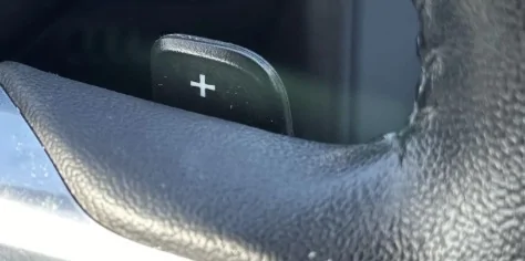

I bought a 2021 GT Premium with auto trans recently, read the manual, and decided to try them.
When I pull in on the + or - 'tab' (per manual) nothing happens, but if I pull in the 'plate' (attached to the tab) located behind the steering wheel at the 3 - 9 o'clock position, they work.
I assume this is normal behavior, right ?

Do you mean to ask if there is a difference in behavior between pulling back at the upper end of the paddle or from the center of the paddle?

Wondering if pulling the ā€˜tab
Wondering if pulling the ā€˜tab’ should activate a shift (mine does not)
By pulling at the 9/3 steering wheel position (ie behind the steering wheel) does activate a shift.

When you pull back on the paddle at the upper tip it puts the internal switch into a bind and it will not activate. Pulling at the center does not impart this off-center torque to the switch and then it works normally.
I purchased aftermarket magnet paddles from ebay to replace my Ford paddles. This was so I could paddle shift on track from the 10/2 hand position. Look for a link to the install process in my build log, link is below in my signature. It is rather involved.
