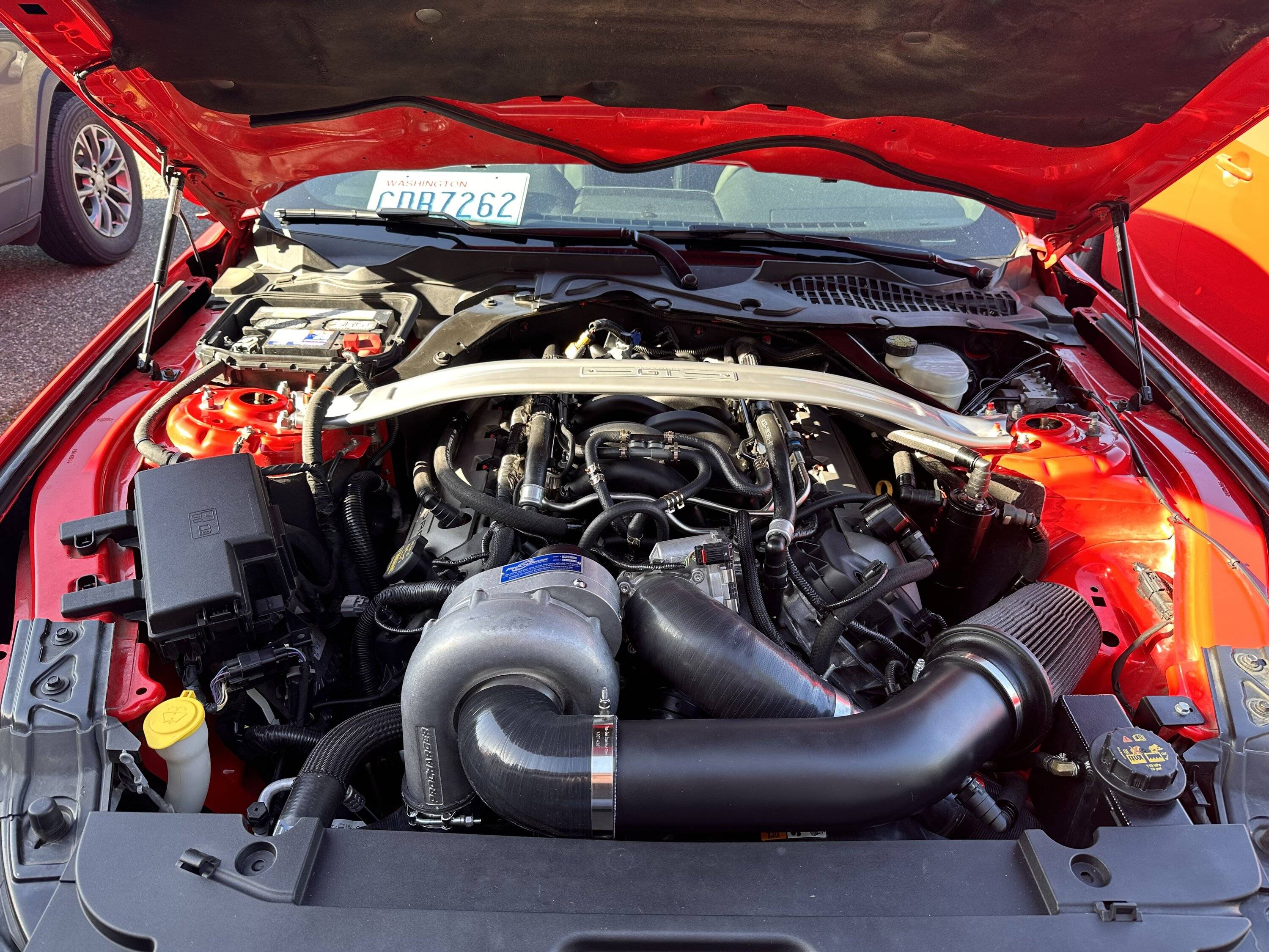

Finally got my car strapped on the dyno with a new tuner after having some problems in the past. Not sure I’m 100% liking the torque numbers since it seems to be on the lower end… what do you all think? Good numbers or na?
P1X H.O. stage 2 kit - 11psi @ 8k
2018+ intake manifold
Kook long tubes w/cats and Kooks catback
Tial 50mm bov
MAF relocation
FIC1000 w/BAP
92 octane + booster.

I'd be interested to hear what you've done to the block to ready it for such numbers.

Stock Gen2 with Boundry oil pump and Boundry timing sprocket, plus Boss tensioners.

Good numbers. Wouldn’t worry too much on the fine details. My car barely hits 600wtq on a dyno.
Happy to hear that. I knew I was splitting hairs.

That is just the nature of the Centri, but you could certainly squeeze out a good bit more torque under the curve if you tune/run E85 because the tuner can get a lot more aggressive with the timing. Of course, you would need a fuel system to do that. More torque = more stress on the motor and drivetrain, so take that with a grain of salt.

Agreed. I do have a fuel system just haven’t installed it yet. I’ll be on e85 in a few months.
