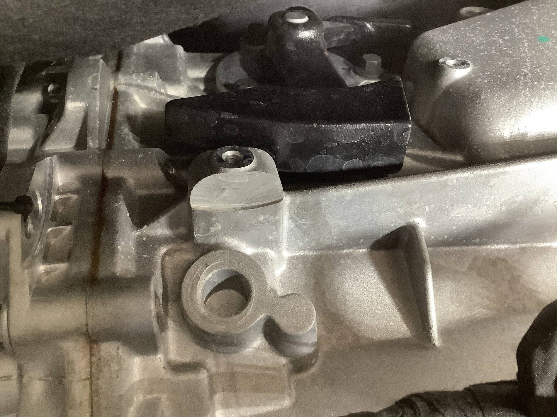

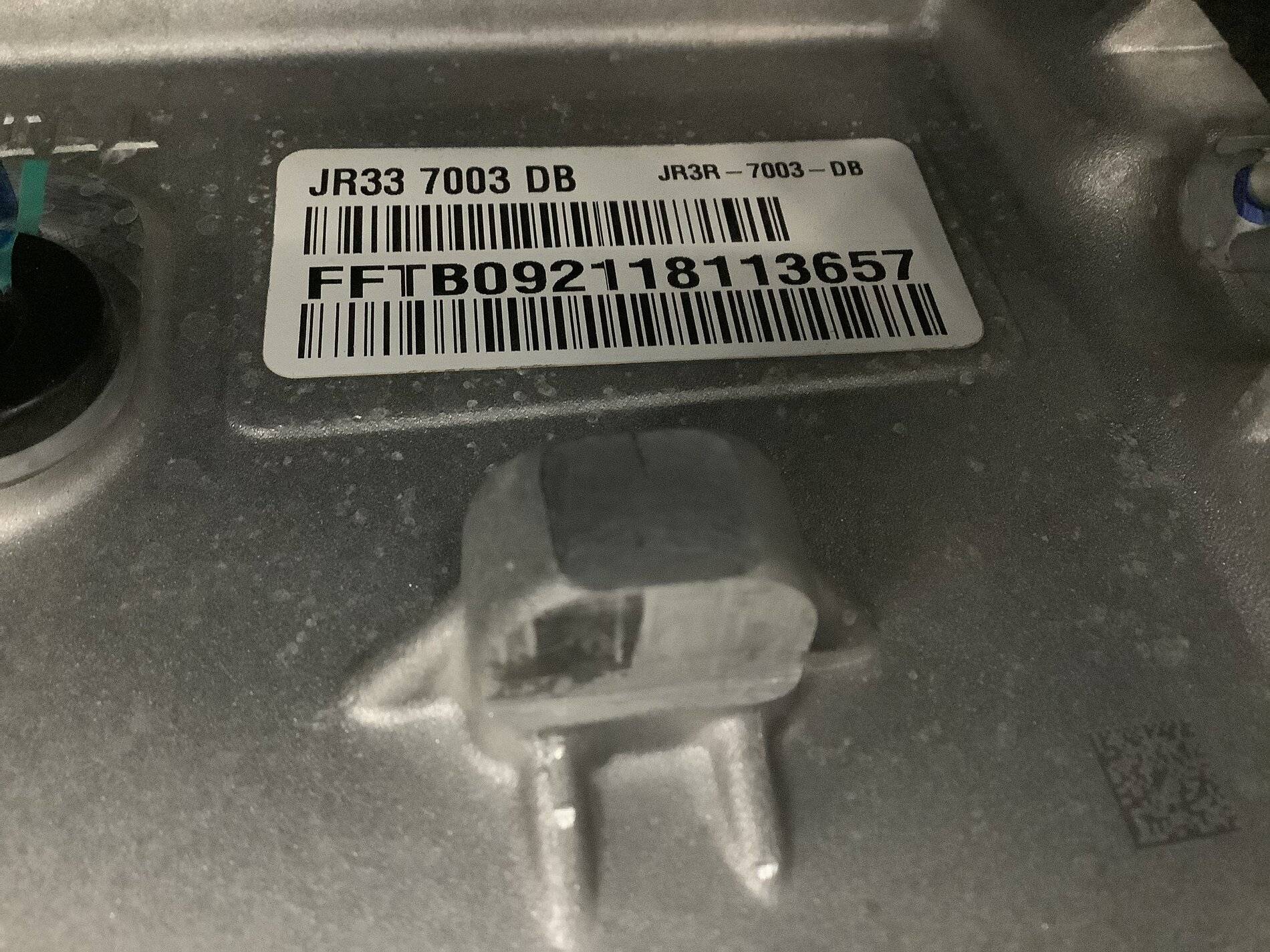

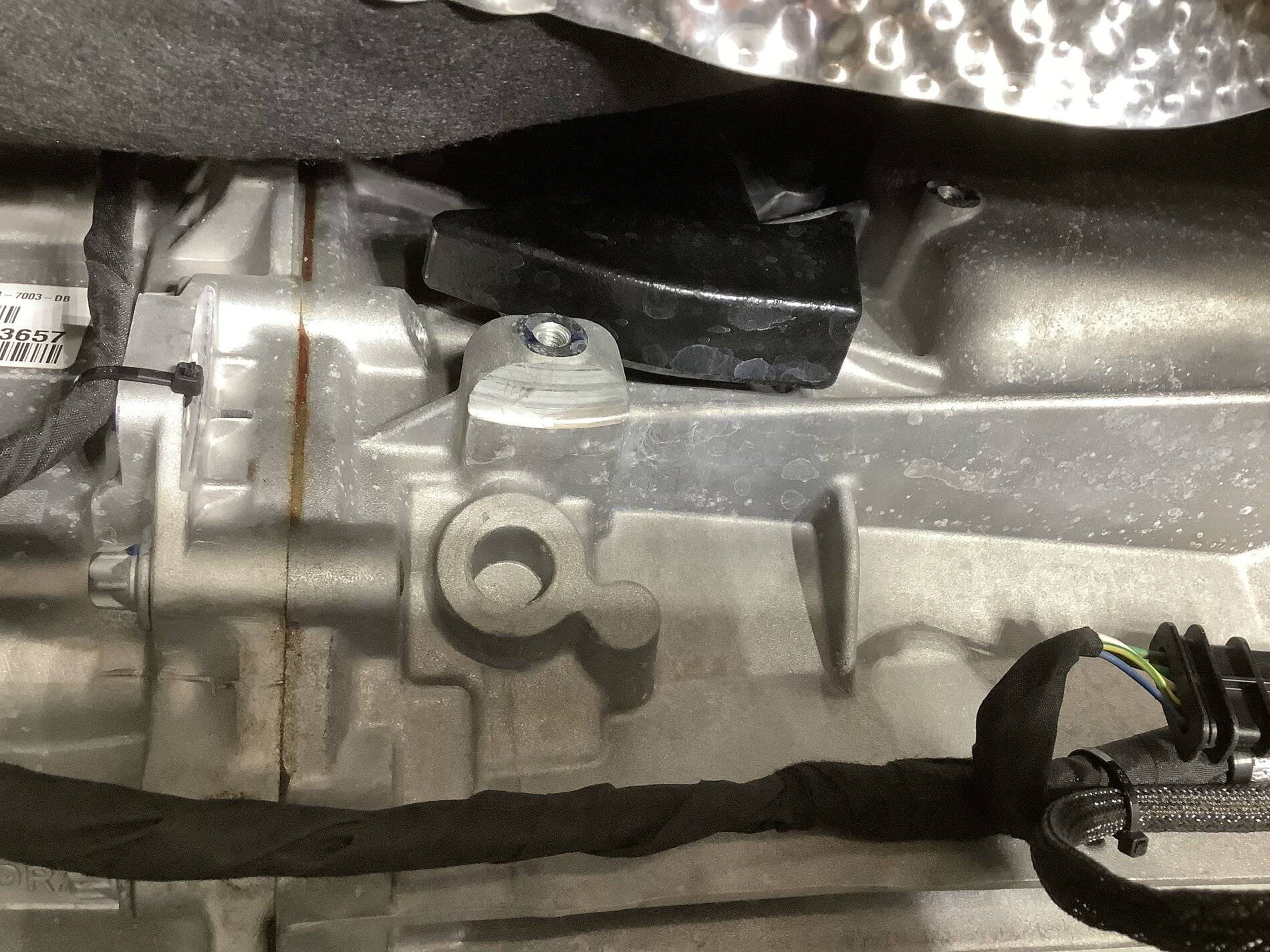

I’m not sure if this is helpful to you RR_S550GT, but my car (2019 Bullitt with MT-82 D4 tranny) is currently in the air, so I took a peek and mine looks just like yours. I snapped a pic of the tag for you to compare with yours as well. Hope this helps you somehow.

Ahh thank you, I had seen the first link previously, but not the second. It's all so very strange as it's not like the MT82 is some obscure component on an unpopular car.
Hoping to learn more once I can get back under the car and share specific transmission details.

Wow, thank you... this helps in the sense that it confirms that I'm not (totally) insane.

They don't, but if the transmission was replaced that might explain something? Especially if you have the same bar code as someone with a 2019 car.
