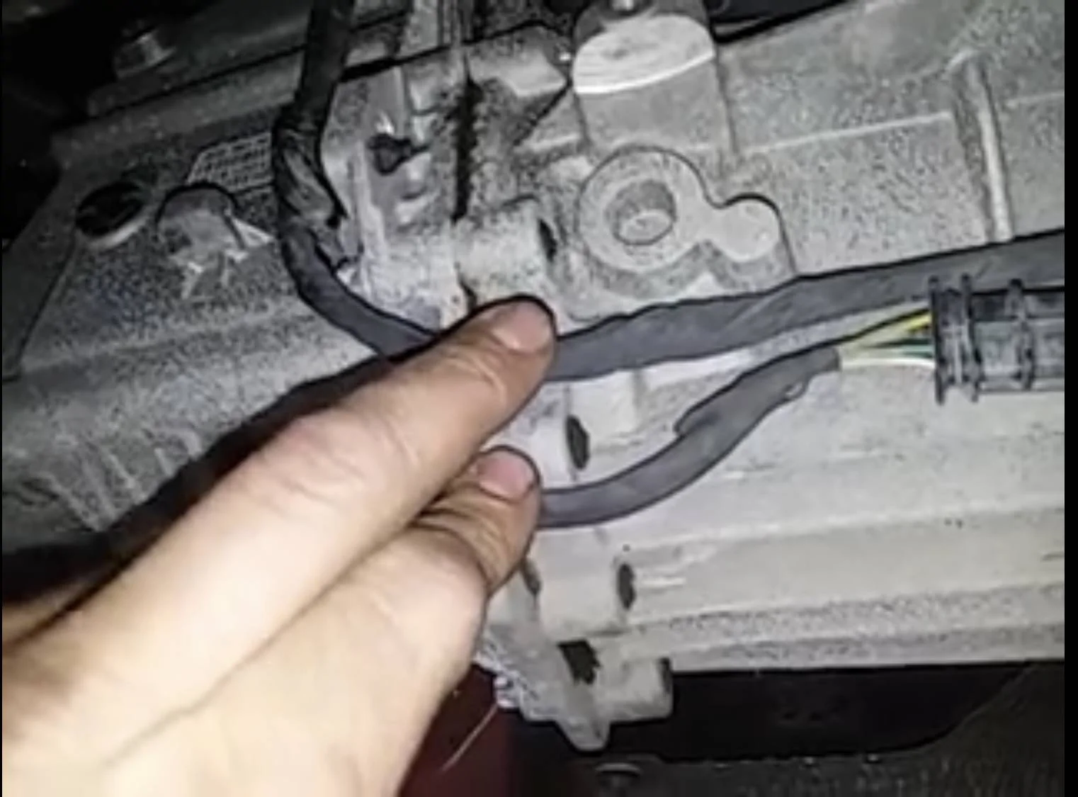

Here’s a pic to demonstrate where the sensor “should” be. Clearly it’s not even drilled/milled/whatever out. Any 18+ owners with insight? Thanks!

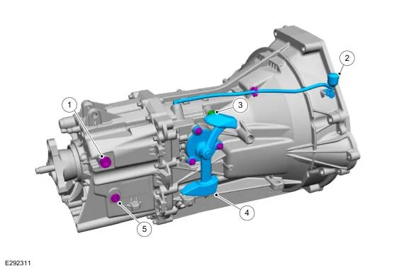

Not the same year for the 5.0 so don't know if it helps.
This is from the 2020 Service Manual. It doesn't show that sensor.
1 Reverse gear shift fork pivot bolt
2 Transmission vent
3 Shift rail detent
4 Shift dampener
5 Drain plug
1Reverse gear shift fork pivot bolt
2Transmission vent
3Shift rail detent
4Shift dampener
5Drain plug
Wow, this is awesome... thank you.

Now it's just confirming there are no differences between 2018 and the above... but thank you very much JJSSI.

Maybe check the tag on the transmission for part number and built date to make sure it is the original?
I believe that is it in the upper left of your photo.
Great suggestion, if it's not too cold out (and it's supposed to be here in the northeast this weekend) I'll try to get under there.
