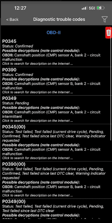

My car has been a PITA for 2 months now. It's a 2016 GT Automatic Base model. Everything started with 2 misfires in cylinders 6 and 8 (it's been a while since I swapped all the spark plugs after that and the codes have been cleared and never came back after that). Fast forward it's throwing these codes

Check the wiring to that sensor as well as the connector pins. The wiring you'll have to peel back some of conduit if to see if the actual wires are physically damaged.
A few M6Gers have found the wiring to be the culprit:
https://www.mustang6g.com/forums/threads/help-me-finding-this-connector.182726/#post-3681161
You could also get a multimeter and probe the connector to see if it's good or if issues exist. You can also probe the sensor and spec it to make sure it's within the factory specs. If it's +/- of the allowable factory specs, sensor has manufacturing quality issues and it's going to throw a code.

Hello,
I did poke the pin connector from the front and I got 0 readings. I thought I'm not poking it deep enough and now I will reply back later after I checked the damage for wires. Thank you for the links.

Hello,
I checked the wiring bout 6 inches from connector and it all looked good. Still no voltage readings. Now im also getting cylinder 6 misfire code.
