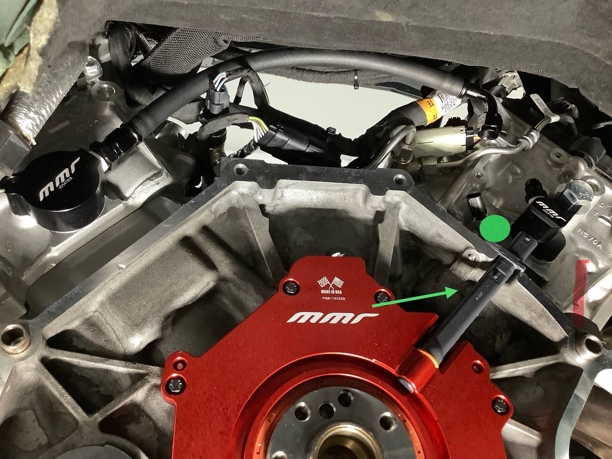

Try a crank relearn first and see if that clears things up. If you have to replace the Crank Position Sensor, that’s going to be a little more work. I changed mine when I had the tranny out. Here’s a pic for reference to show where it’s located.
The green arrow is pointing to the sensor and the green circle shows the location of the mounting bolt, which is either an 8MM or 10MM. I forget which, but it’s one of those sizes.
Short of removing the tranny, you could probably access it relatively easy if you remove the intake manifold. As you can see in my pic, there should be enough room to remove that bolt and pull the sensor out. I hope this helps.

Easy fix you have to remove battery box but not hard at all
