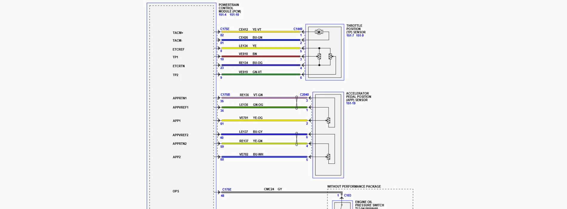

fmc_smt
Jun 4, 2018
39
1,295
2,634
Cottonwood , Arizona
2015 gt , 2015 Escape , 2015 F250
And wiring diagram

Here is the code possible causes , this is right out of the service manual
WARNING:
Substantial opening and closing torque is applied by this system. To prevent injury, be careful to keep fingers away from throttle mechanism when actuated. Failure to follow these instructions may result in personal injury.
This pinpoint test is intended to diagnose the following:
  • electronic throttle body ( ETB) (9F991)
  • electronic throttle body throttle position sensor ( ETBTPS) (9E928)
  • harness circuits: ETCRTN , ETCREF , TP , TP1 , TP2 , TACM+ , and TACM-
  • PCM (12A650)
I also found a P2135 while thumbing through pics.
So it sounds like a new TB or can I replace parts on the whipple 132mm?
Thanks
