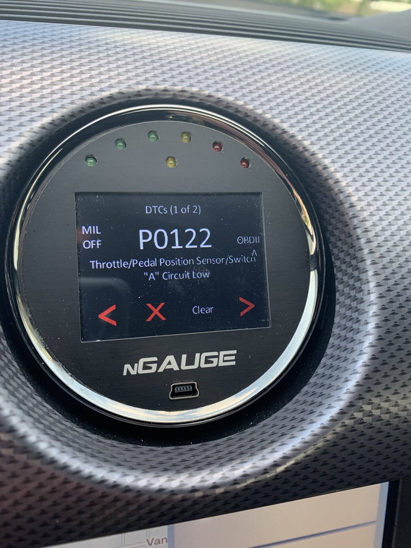

I just got this P0122 code again. Had it a
Couple years ago and the BAP company sent me a new cable that ran from the pedal to the BAP or gas tank… can’t remember. Well it’s back again. I cleared the code and checked connections. Everything seems good. How does this come back after so long? Any ideas?

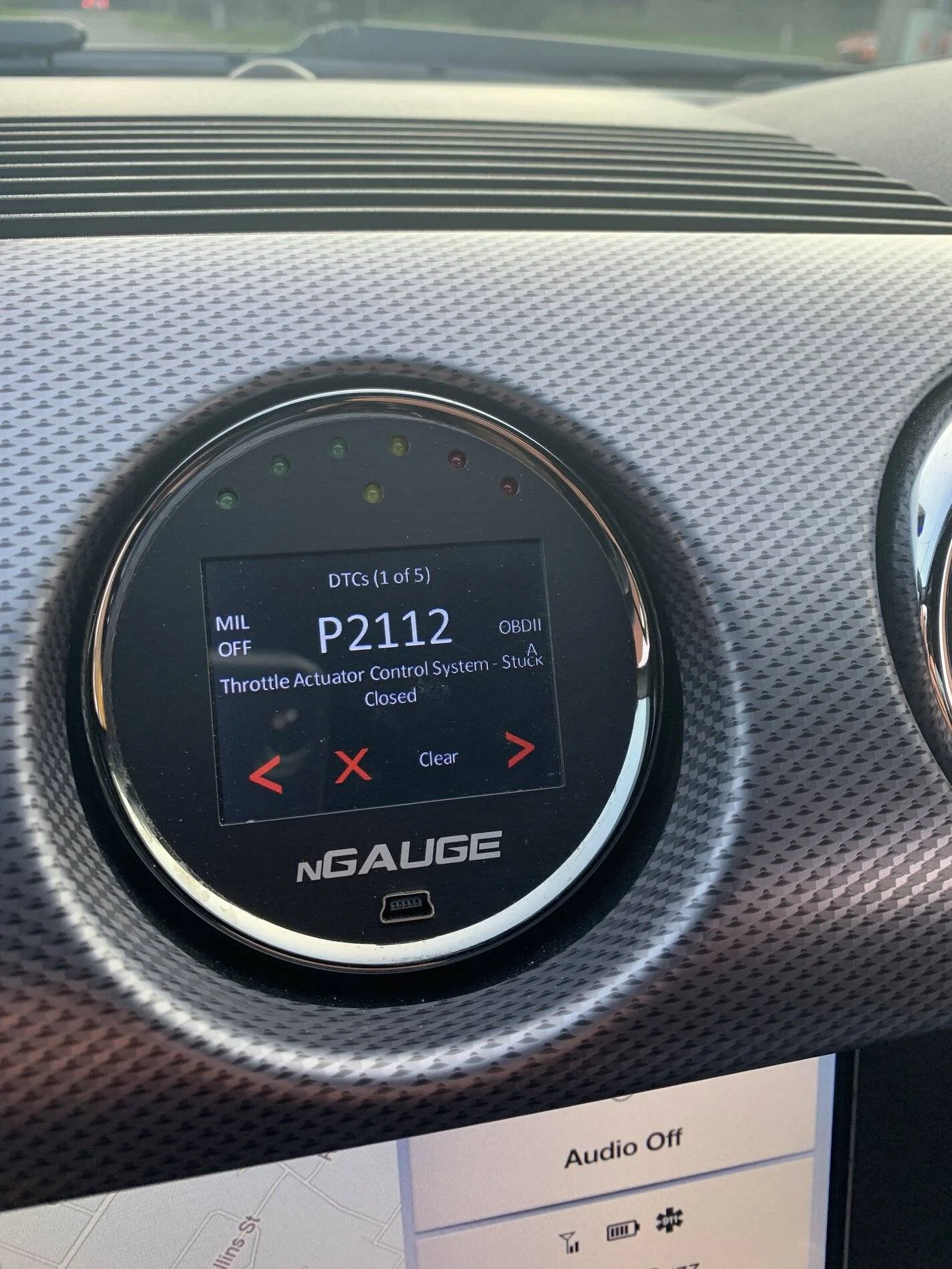

Some hell, first pull 1 thru 3 full throttle. No issue. Second pull, Turned corner and easy through first till about 4K shift to second and give it hell… code popped right away, had to limp off the road and shut down and restart. Drive fine back to base. Did get a different code though..

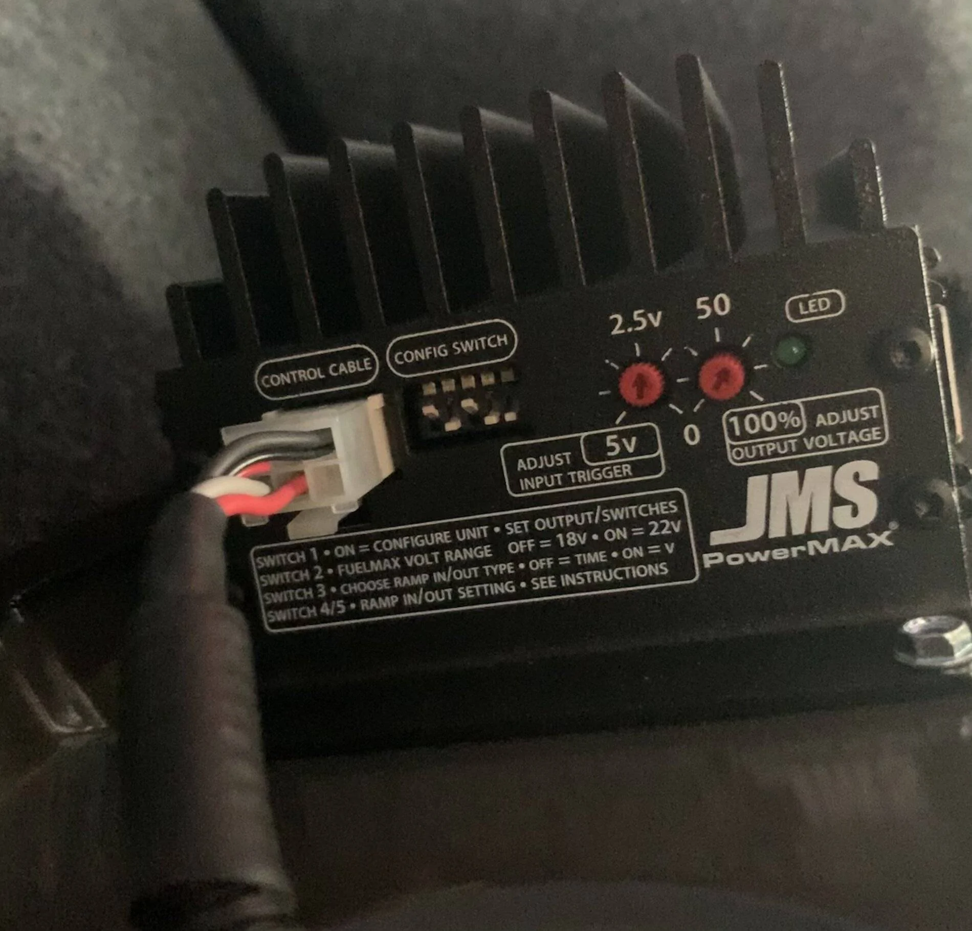

also see pic of BAP setting, maybe something is just a tad Off?

Eliminate the bap , try again, if code resets replace the throttle body.
Unplugged BAP and drove home with no issues. I did take it easy though with one rip in third.

Yes , 2111 and 2112 almost always lead to a throttle body . Code definition is mis leading .

P0223 - Throttle pedal position sensor Switch B circuit high.
P0122 - Throttle pedal position sensor Switch A circuit low.
P2112 - throttle actuator control system - stuck closed
P0222 - Throttle pedal position sensor Switch B circuit low.
This is all from the nGauge

Ok so , the codes are miss leading . You would think that they refer to the throttle pedal , also known as the app . But they refer to the throttle position sensor . That sensor is integrated into the electronic throttle body . My bet would be you have an issue in the etb.
