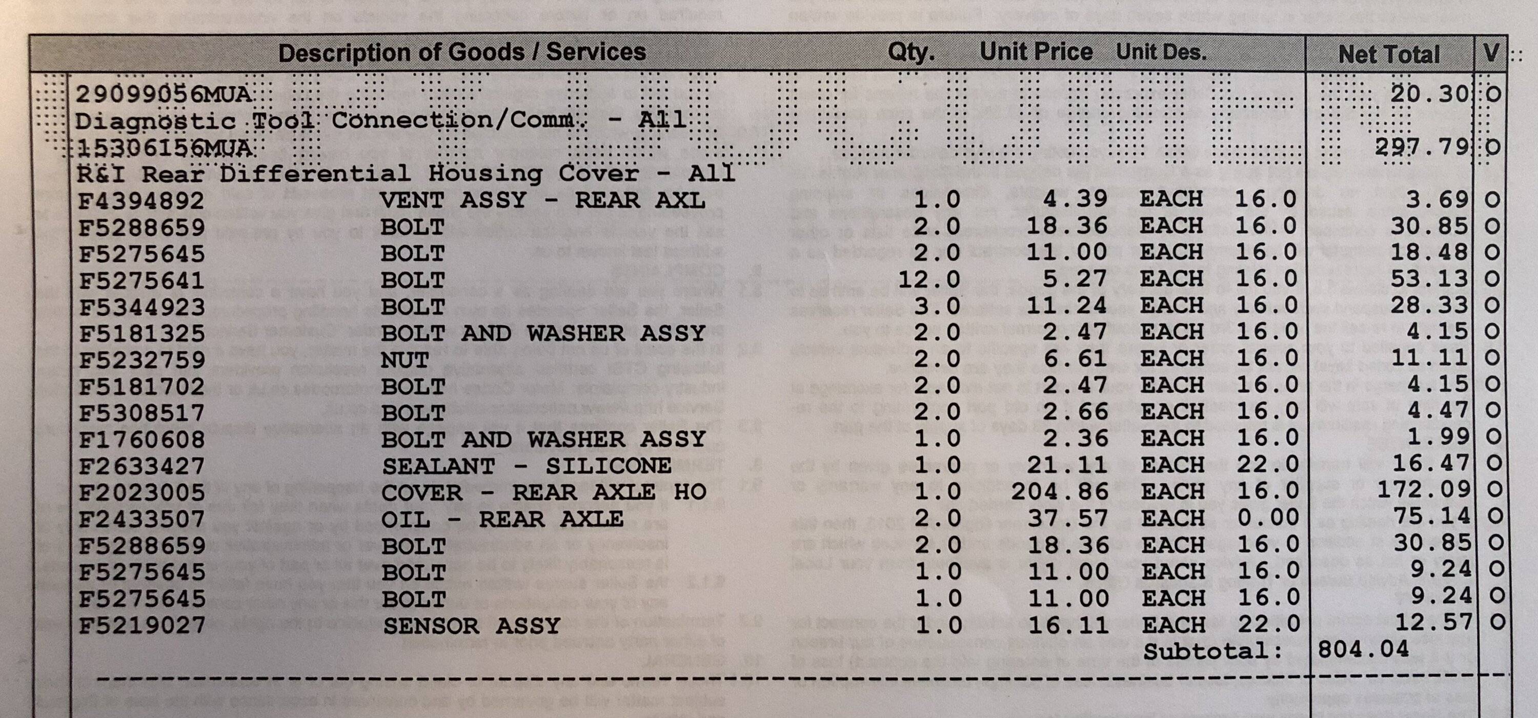

I went digging through my paperwork as I thought I might be able to help, but the detail on my warranty claim is a little more vague than I was hoping :
I wanted it to show hours, but the diff removal and refit is only quoted as a cash value i.e. ÂŁ297.79 (circa $360 at today's exchange rate).
I was hoping if it quoted hours, it might have given you guys some bargaining power if you thought you were getting ripped off i.e. 'why are you charging me X amount of $'s when Fords system says X amount of hours ?'

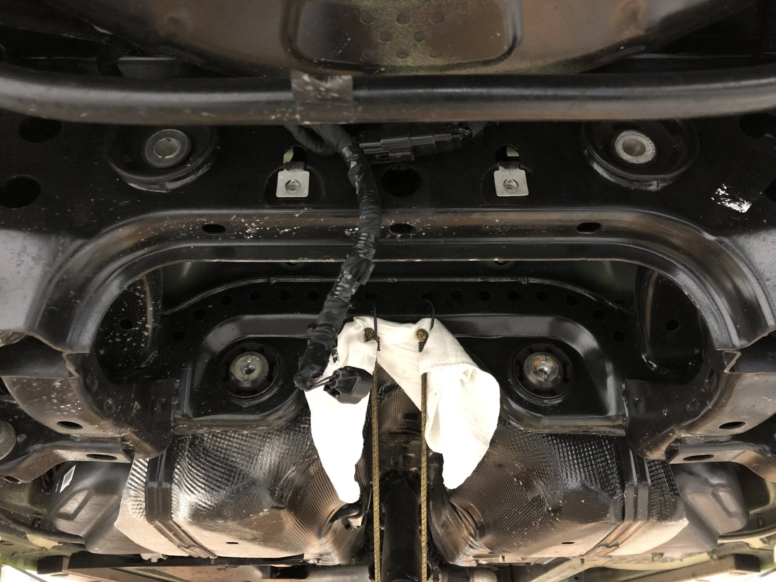

Interestingly, when Ford stripped my diff out they didn't drop the subframe :
