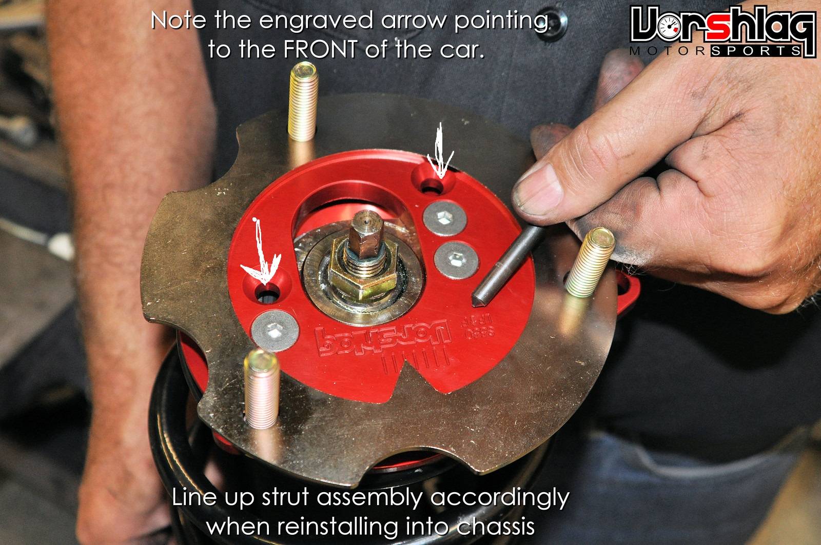

Does anyone have them install on their S550?
I will be installing mine next weekend and wanted to know what you have the caster set at.

Leave the caster at the standard setting. It's plenty.
Based on this pic, where is the standard setting? Where it is set, or move it to the other set of holes?
White arrows pointing to "other" caster setting holes.
