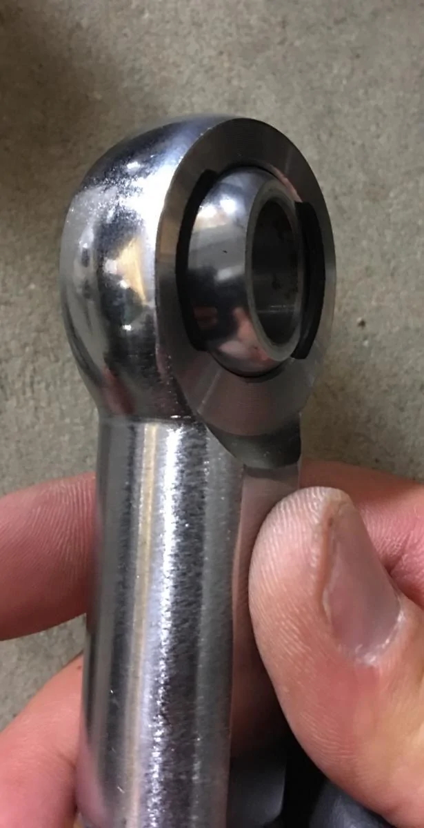

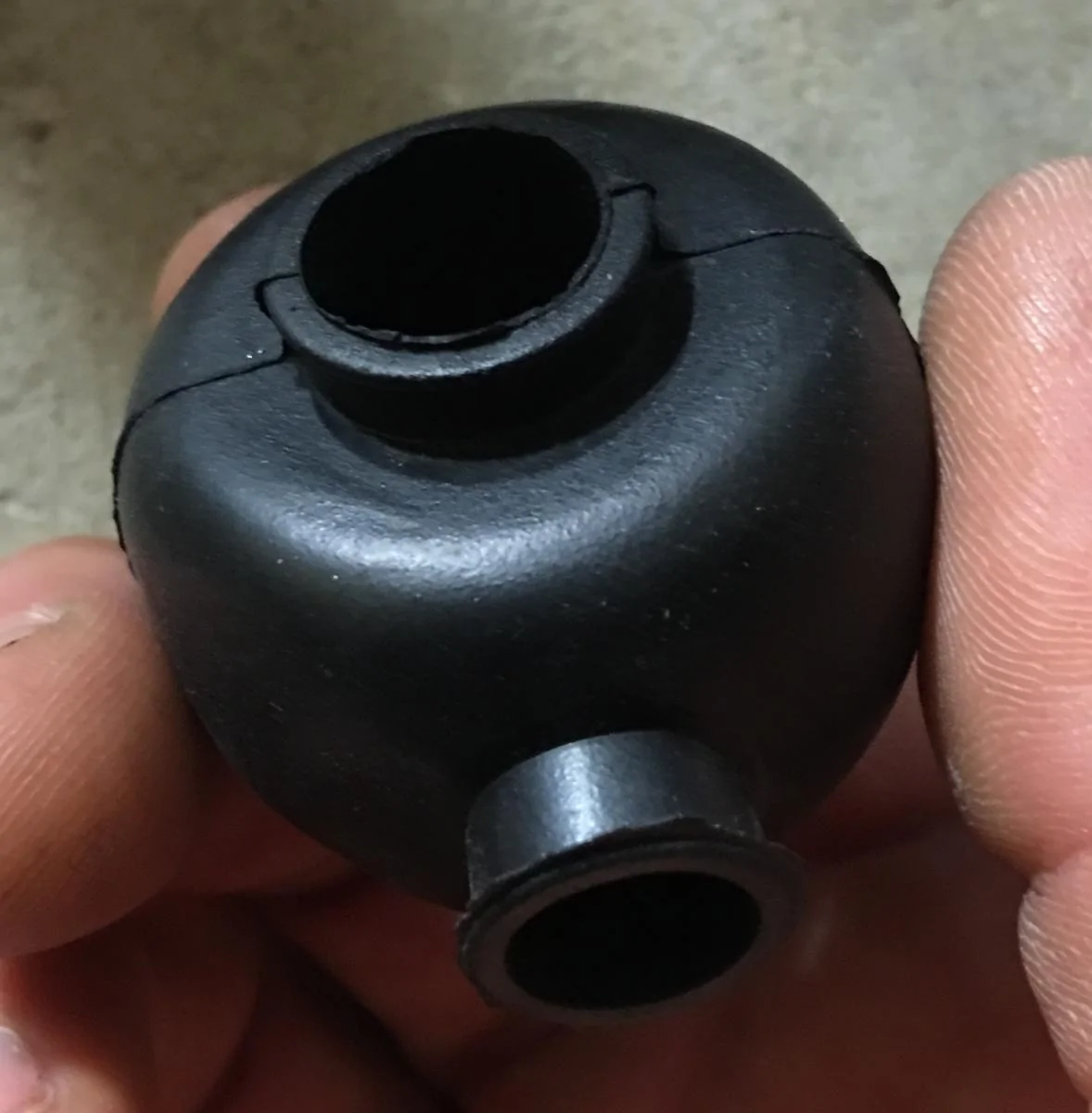

The Steeda kit does not require seals and boots! We use a very high quality Teflon lined rod end which requires no lube! We have sold 10 of thousands of kits since 2003 with no issues!
That may be true, but why not just add a seals-it boot to help keep shit out of the bearing. It's cheap and doesn't hurt anything.

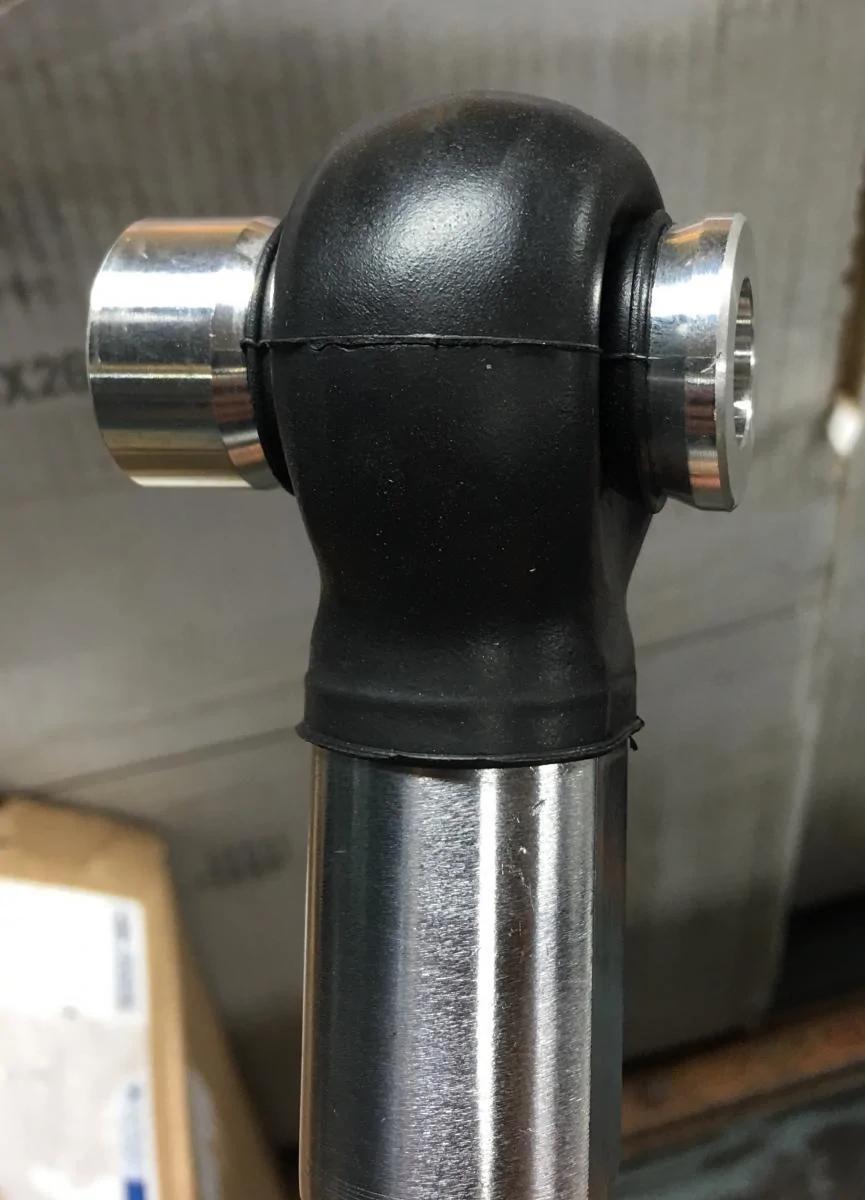

Before
Voodooo
Nov 2, 2015
107
5,821
2,399
SE Michigan
Scott
Carroll Shelbys Soul Lives Under My GT350 Hood
After!!
Keeps out dirt, moisture, etc. for a few bucks why wouldn't you?!?!?!?
